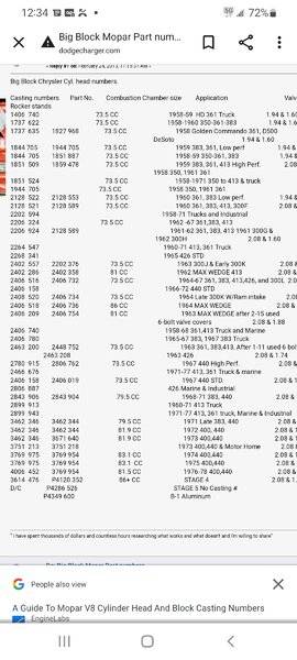

Galen Govier’s Parts Interchange book shows that 2780915 Heads only available in 1967.
Well that's an opinion. My opinion is that 915's in the small valve were on some '66's and most '67's maybe into the '68 production run. But I'm not Galen.
That chart does not include all the 915's that were not the HP version. Many, many were the small exhaust verion. I have had many of them.
