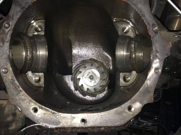

just set up my rear end it s a 8 .25 from diplomat .
I needed a little more at the bottom so swap it out to 355
I will finish her up tomorrow cant wait to try it out

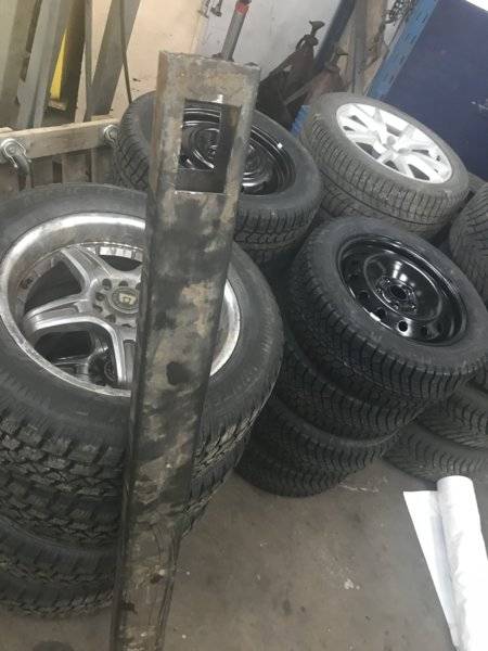

the middle pic is my home made flange holder when I crushed the sleeve for the pinion preload
I see you have several sets of tires ready to test out your new diff.:lol:

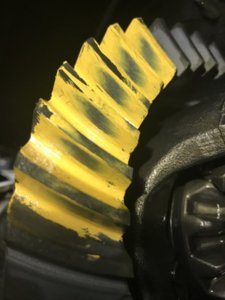

Nice contact pattern:thumbsup:. 355s to me are the perfect gear for all around driving with limited freeway miles. Expect just above 3,000 rpms on the freeway at 70 mph.
I love gears it really makes the car drive better , noticeably higher rev s on highway but , I just get used to it
