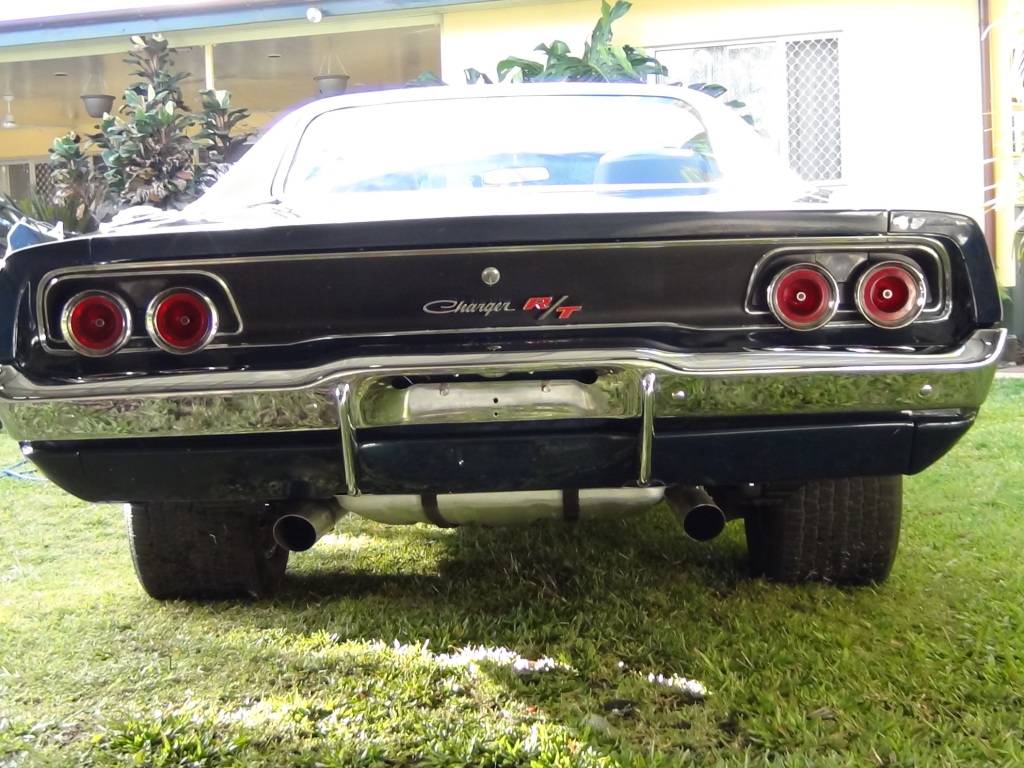

i had 15 x 10 centrelines with 295 50 15 on my 68 charger i am pretty sure there the same as the RR, this should help this fitment guide
not the best picture but this is 15 x 10 5" BS with 295 50 15 radial T/A's on a 68 charger and it has NO spring relocation or tubbed, it gave about an inch to fender lip and 3/4 " to inner wheel well

Love the look of that 68 charger from the back Benno! That looks mean, exactly what I am going for.
