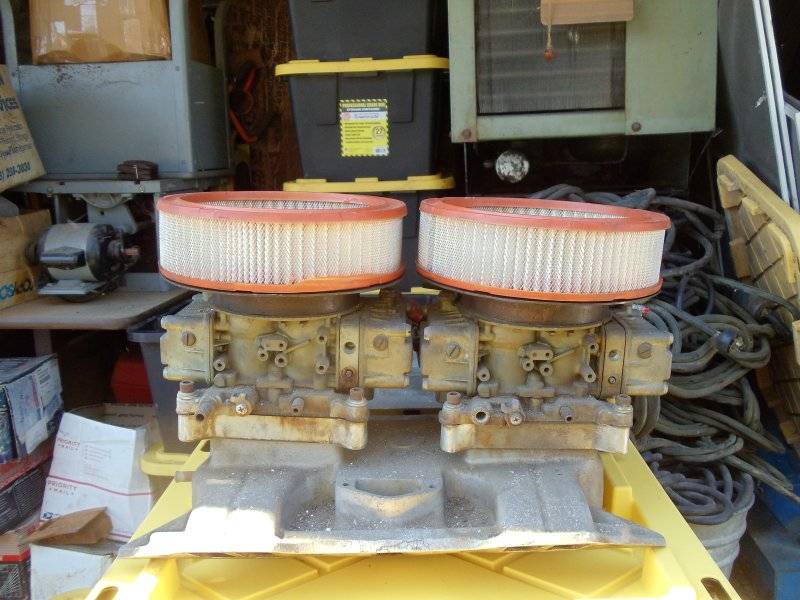

Understand that the 2 X 4 setup would mostly be for eye candy. The single Edelbrock 750 cfm. on my '67 440 R/T felt a lot crisper on the street. My '64 looked liked like any other Polara convertible (like Miss Jane's car from The Beverly Hillbillies), but, pop the hood and it drew people like flies to a $hitpile!
ya .. just for the look of it. not going nuts with it .... just the cool factor.

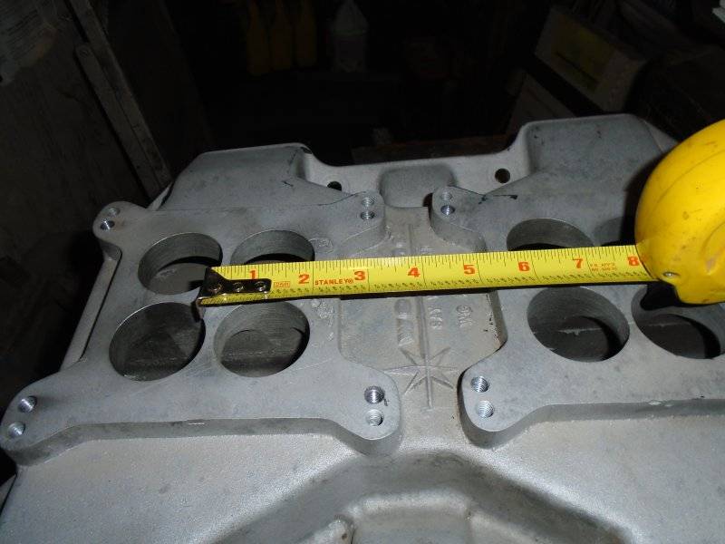

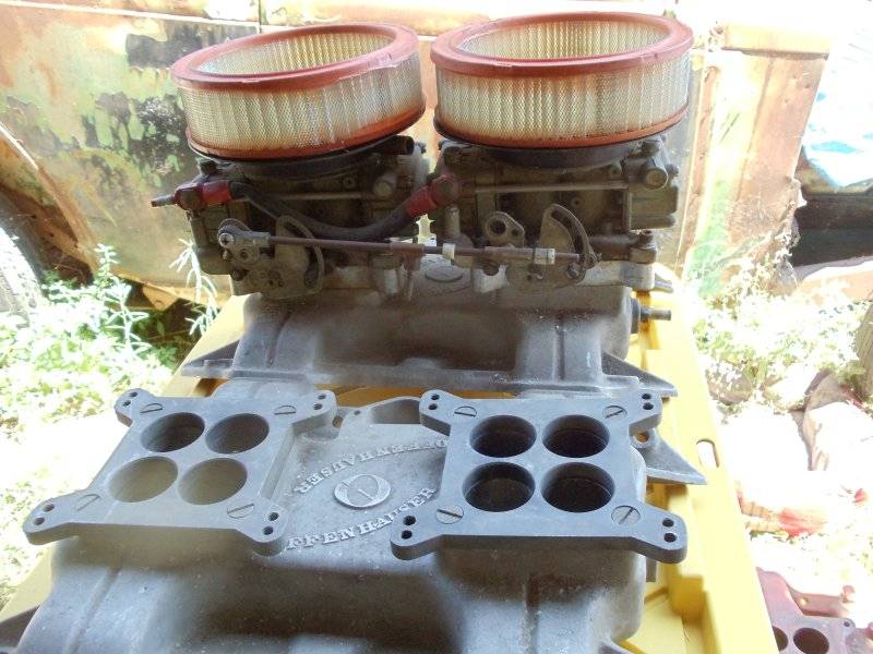

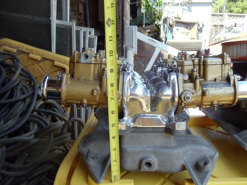

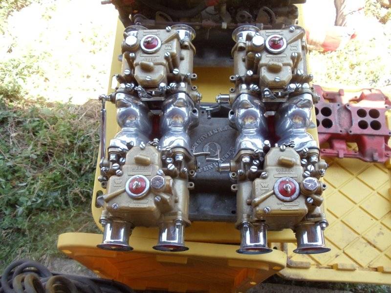

hacksaw i did a twin fours on a couple cars , i used one inch spacers and drilled them for the intake pattern and mounted those spacers with threads installed in the outer hole pattern so i could run holleys or late afb's . the early afb's had the small bolt pattern on them , as the wfb's . i'm thinking that's what that 350/361 intake used . i've never used these sidedraft webers on a car , but it looks sweet !

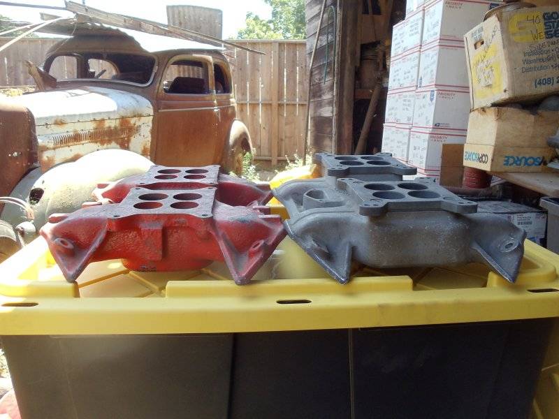

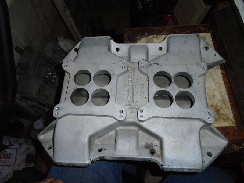

Before I'd dump a 440 to use a iron 383 dual 4bbl, I'd find a weiand/edelbrock/offenhauser aluminum dual four for a 440, throw on a couple edelbrocks, and a linkage kit.
....and then tell everybody it's a tall deck 383, 343 hp, only available in 62 (after grinding the name off the intake, and painting it, of course!)

Oh, I know it was a low deck 383 in the 62s. (Only 58 and 59 for tall deck 383s, if I remember right) The "tall deck 383" story in Hacksaw's 62 was just to explain the wide (disguised) twin four intake.

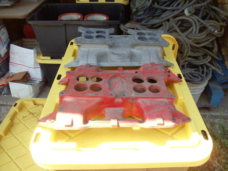

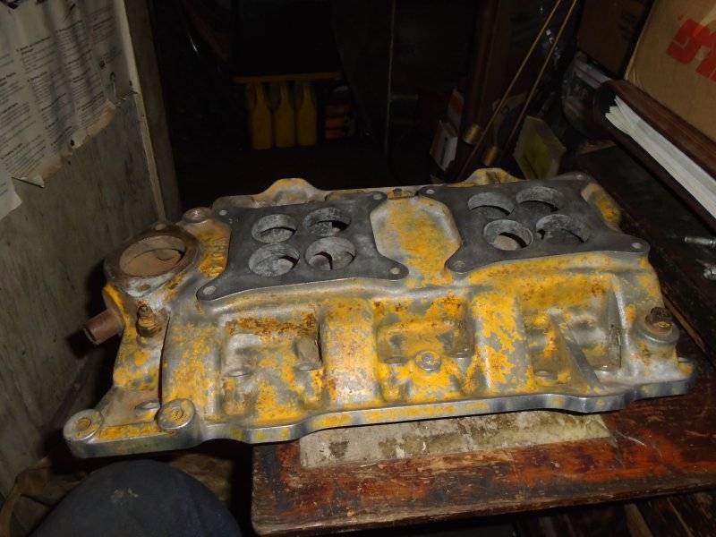

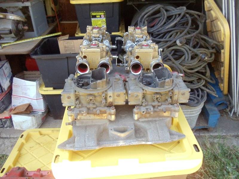

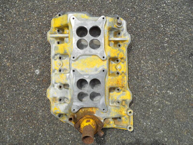

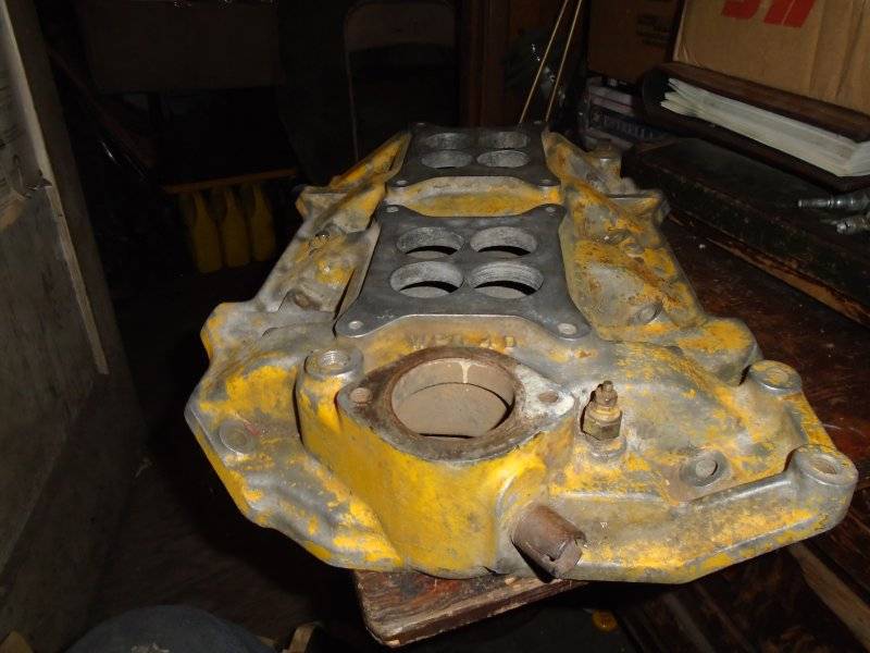

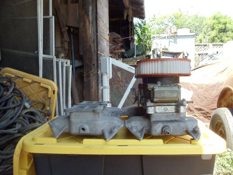

this intake is off of a 58 350 CI. if i remember right it was a golden fury only thing. and some desoto's

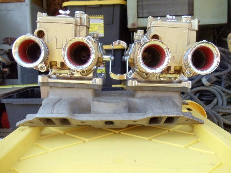

now that would look cool in my car .... lol
