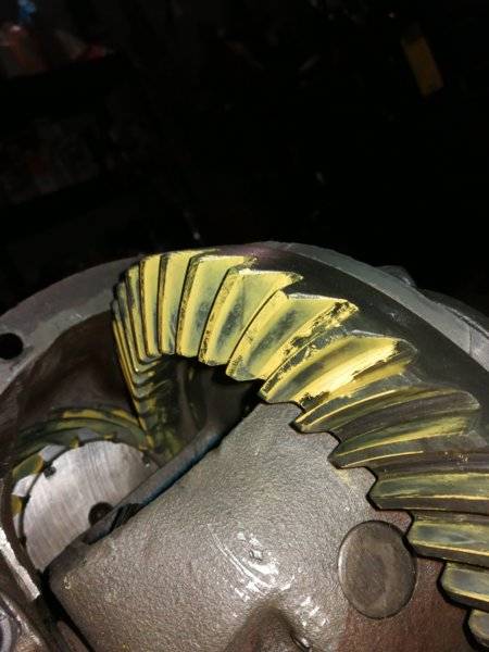

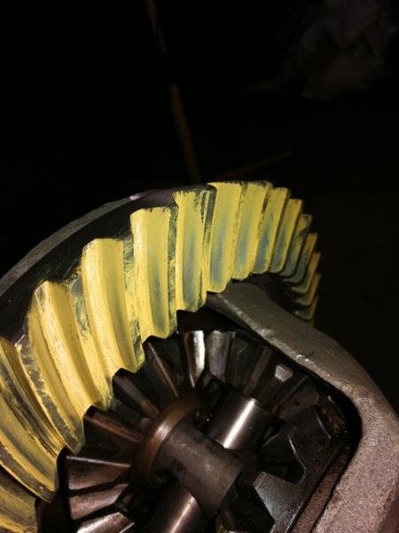

can someone comment on this pattern
using new bearings and reused existing pinion and ring gear
using crush sleeve eliminator. I tried my original shim size and I couldn't get the proper pre-load.
removed 0.016 and can get pre-load now.
backlash is at. 0.09
it says to increase backlash if the pattern is lower down ? but max back lash the book says is. 0.010
thanks

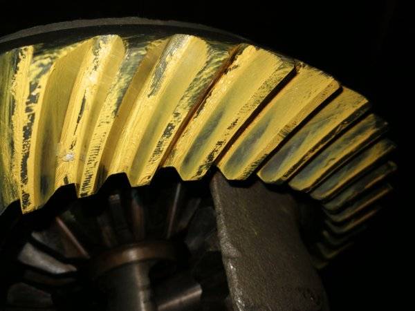

I was able to improve it added another .05 was able to torque pre-load
