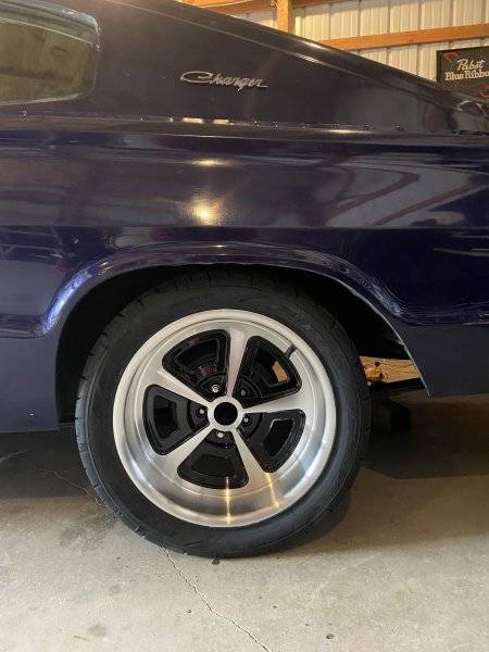

275/45/18 Nitto, I believe I could have fit a 295/45/18 that’s what I will get next set of rears
I have about 1 1/2-2 inch’s to the lip and maybe 3/4 inch to the wheel well. If you get the backspacing right I can see a 305 maybe 315 but that might be to close
I will double check the clearance in a few days when I return home.

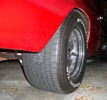

295/50/15 seen here

I wish I would of went with 20’s now but I still like my 18’s. Just need to work in the stance now
I have over 2 inches left until my wheel well
Sorry it took me so long to respond it’s been real hectic month for me
