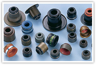

I would suggest the simple soloution first:
Valve stem seals...
Located in your HEAD.
After years they get old and hard and leak-down when car has been sitting.(they are a rubber seal)
The smoke "burns-off" once it has disapated from the cylinder.
After driving a bit, the smoke is gone.
Try this troubleshooting technique first before you "tear-down" the engine for a re-build.
