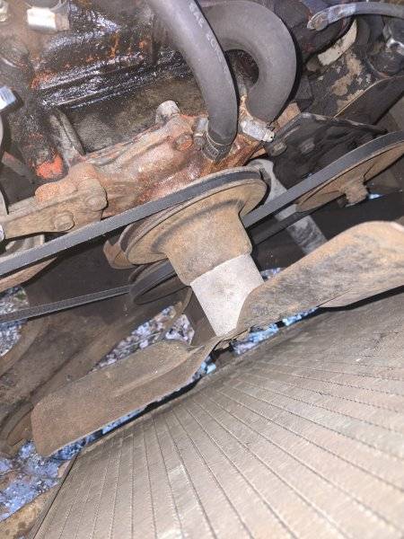

If i take off the 4 bolts for the fan does the spacer come off as well?
Yes it should, problem is the bolts are about 3 inches long and you will need to probably pull the radiator.
The aluminum spacer will likely be electrolized (stuck) to the metal fan blade. Yeah, radiator definitely needs to come out.
From the title of this post, I thought the OP really really liked 318 motors.
Nope, I doubt rad will need to be removed. Shove some thin wood or cardboard between the rad core & fan to prevent core damage.
Loosen fan bolts 3 turns. Hit spacer with plastic hammer or block of wood to loosen it.
Remove bolts & lift out fan & spacer as an assy.
Exactly!
