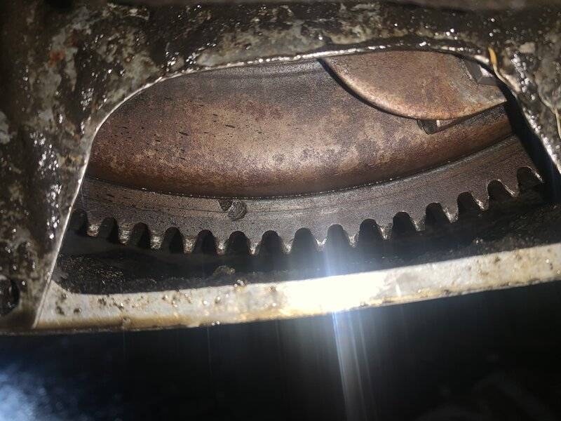

I attempted to search the site for this issue to no avail, so here goes. When I first got my Charger, it had one of the enormous, original style starters, so when it died, I replaced it with a mini starter for a 90s magnum motor. First, I tried a used one, and it made a horrible racket while running, as though the flywheel teeth were hitting the starter gear. I replaced it with a reman one from Autozone, and it worked fine for like 5 months. Then, it started grinding as well. It would do it in all gears, including park and neutral, and the volume and pitch would change depending on RPM. In park or neutral, I could rev the engine and it would go away for a few seconds. I decided to get a refund and buy a nice Powermaster unit. Well, last night I installed it and it’s even louder than before and it’s constant. It never goes away, so long as the engine’s running. I’m positive the sound is coming from there, as I confirmed it with a stethoscope. In addition, there’s the fact that it got worse after changing starters. The flywheel looks normal through the inspection plate while running, but the teeth are a little chewed up. Not horribly, but definitely not in perfect shape. I’m at my wits’ end at this point.

might just be the pic. but those teeth look a little done! I find another wheel and start over!

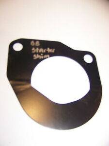

You can get these starter spacers that look like:
