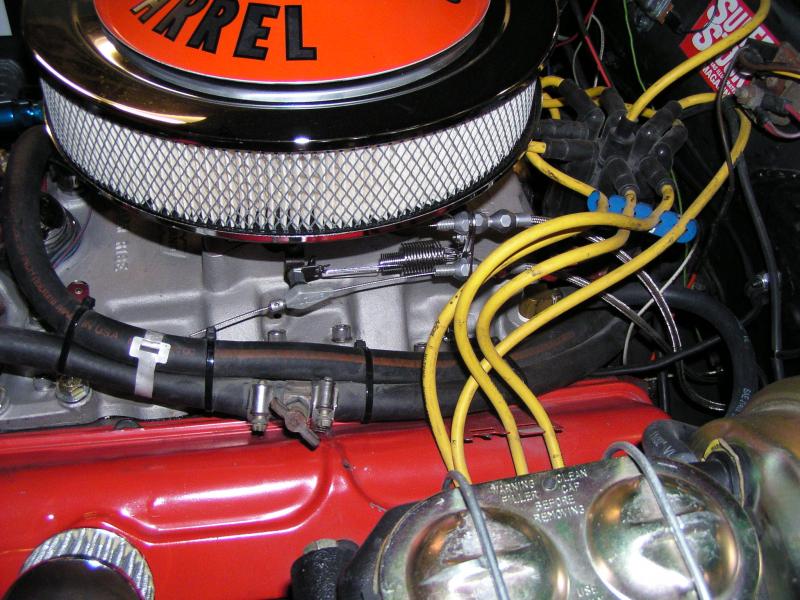

I used Lokar linkage for both throttle and kickdown. However Bouchillon Performance also makes these parts. I think it's a matter of personal preference. If you review the Cruisin Bruce site ( DJ that does the cruises you mentioned ), under the business-related section, you should find a reference to Don Verity. He's located in Northern RI and does 99% of his work with Mopar, be they old hemis or polys. He can also do old TF work. ( He replaced seals, got my park lever to "park", and also added a deeper(2qt) trans pan. Just saying.
BTW - make sure you put good return springs on your setup. A main AND a backup.
