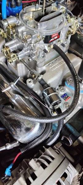

I honestly can't remeber anymore how the old carb was installed. Afaik I installed it just like the old one. A hose to the valve cover and every other line outs on the carb were closed. When I pull the line to the valve cover the engine starts to rumble and slowly dies. I've read that this must happen if there is no vacuum leak.
Are there any other methods to test for leaks or is this test-result good enough to say there is no leak?

Perhaps you have other points to let me check which I haven't thought about. I took a few pics of the vac-lines, perhaps this will help. Since every case is individual I still want to ask you although there are a few threads about it and I don't want to spam a thread of another user with my questions.
