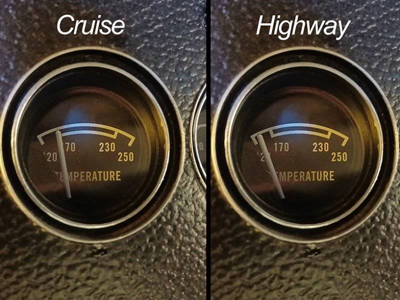

So, when I cruise slowly the temp sits at around 170-180 and the electric fan (and 160 stat) keeps it there for forever....and used to do that on the highway too.
...but now on the highway the temp creeps down to 120-130...and all I did was change the intake?

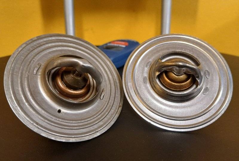

Ok, got a thermal gun (Blue thingy behind the Tstats in the pic) and the temp gauge is dead on. No problem there.
Got a new 180 Tstat on the shelf so I put that in (To the right in the pic).
With the 180 Tstat in the Temp got more stable in both slow cruise/highway and sat at a steady 170.
I do have an adjustable electric fan controller that I adjusted a bit to start at a higher temp.
Went for a long drive to a car meet and the temp sits at 180. All good and fixed.

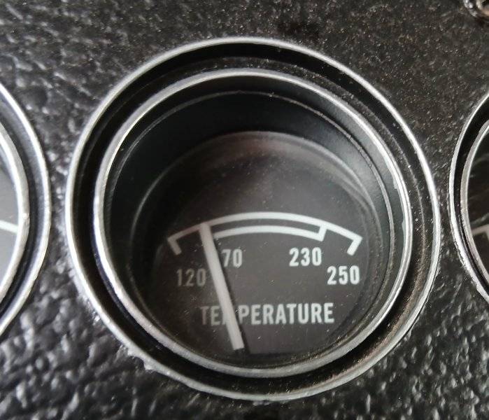

(Temp gauge pic is from before the adjust.)
