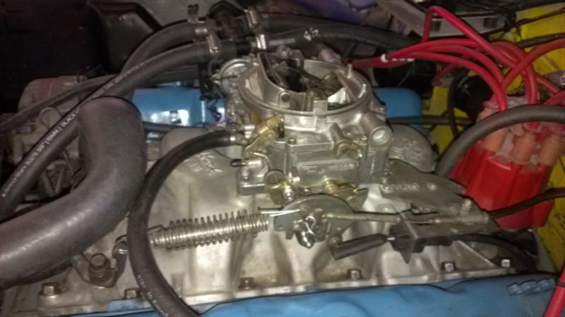

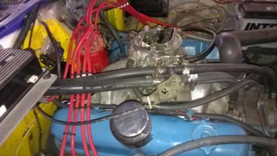

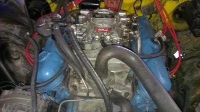

Here are a few pics of my set up...
I went ahead and checked some of your suggestions...timing was at 32* at 2500 Rpms, played with the choke and notice that when the engine fired up, the choke would fully open. I then covered the primaries with my hand and it seemed to settled down a bit. I am wondering how much tension should the choke valve have? Also at what position do I set the fast idle cam?

If you covered the primaries and it didn't die... then you are likely sucking in air from somewhere. (i.e. vacuum leak)
If you can't find a leak check that the secondaries are not open a little.
Vacuum leak... that issue has to get resolved first.
Looks like the vacuum fitting on the power brake booster 'T' in front of the distributor is open. Is it? Where are you getting vacuum for your distributor from or is it a mechanical only unit?
Distributor is mechanical unit. Vacuum fitting is plugged up. ive seen a couple edelbrock carb set up that use a carb spacer. Anyone know if this is required for these carbs. possibly the source of the leak?
A carburetor spacer is not required unless the linkage is hitting something on the manifold. Then you might need to raise it. As far as covering the primaries with your hand; If the motor was cold, your hand was acting like the choke. Is the choke linkage hooked up? To adjust it, wait till the motor is stone cold (overnight) and then adjust it so that when you open the butterflies, the choke closes with a little tension. When you start the motor, the choke should open slightly (1/8"-1/4" is usually close enough). Realize that before you start the motor you need to press the accelerator pedal down first so the choke can close and the fast idle cam can engage. A factory service manual or a Chiltons will help you here.
Did you spray carb cleaner (Berryman's B-12) or water on all the gasketed surfaces and fittings? What happened?
So after the period spent getting my mind off this issue I got back on it. I went ahead and sprayed some carb cleaner around the intake and carb, and found a small increase in rpm reaction near one of the carb bolts. Sure enough, it was bolted down fully. That seemed to calm it down a bit. Next I hooked up a vacuum gauge and played with the idle mix screws, trying to achieve the highest possible vacuum (about 15 ). I was adjusting the screws one at a time, achieving highest possible vacuum, then once achieved, bring it back down a bit. It seems to idle a bit smoother, but What I ended up with was the left screw about 2 1/8 turn out, and the right one about 1. Do they both have to be the same amount turned out?
