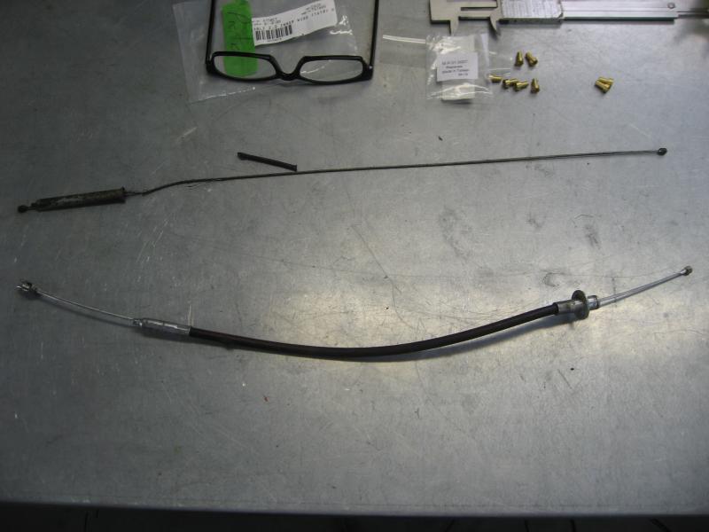

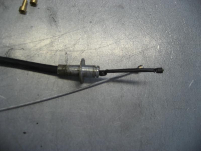

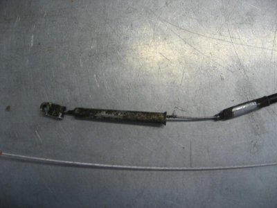

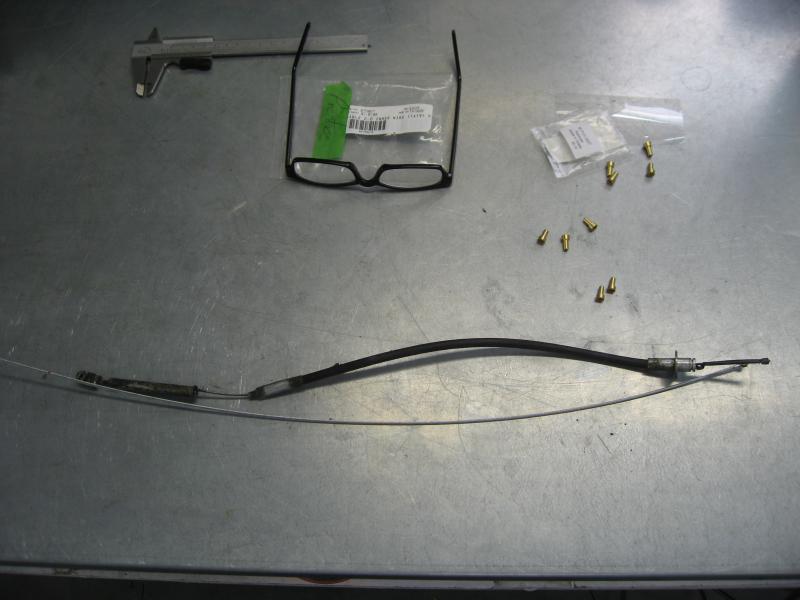

Had the same problem with my '66. NOBODY makes a replacement. Went to my local M/C shop and bought a generic brake/clutch cable and fittings, used my old "outer" and simply cut the new inner to length with the brass fittings soldered on. Works great! IMG_4358.jpgIMG_4359.jpgIMG_4360.jpgIMG_4361.jpg
