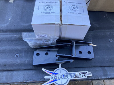

I happen to have a NIB mount package from 440 source. Brackets, mounts, bolts that covers 66-72 b&e body to put a b or rb in when you have a v-8 k frame. $150.00 plus shipping from 93402. No PayPal accepted. USPS money order.
