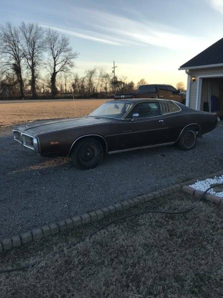

Just recently picked up a 1974 dodge charger and I am looking at going all in and do it right the first time. I know its not the highly sought after 68-69 but I think I could make this my baby.
Currently have a 318 in it and I would like to squeeze out as much as possible while making the most sense of the build. I know what you are thinking why not drop a 360 or find a 440 or heck LS swap it.. well reason why that’s all a no is this is a numbers matching all original car and I would like for it to stay closer to stock but upgrade and make it a little more modern and fun. So if I ever needed to sell it wouldn’t kill the value. Currently I don’t have a budget but looking at getting quotes and some advice so I can put one together.. it wouldn’t surprise me if I put 10k in just the engine for reference.
Here is the biggest kicker and what everyone is going to laugh at me about. I don’t care about going fast at the track, it may see it once in a blue moon. More so being a partial daily driver, 3-4 times a week maybe.
Dad loves the sound of a large LSA cam, you know the real choppy idle.
The plan is for him to get to keep it some as well since it will be our project and I may even give it to him.
