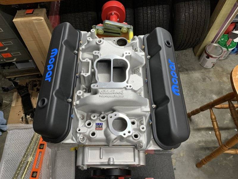

I bought it non-running, pulled the 318 and had it shopped: hot tanked, bored to 60 over, honed. Only the block and crank were good.
Installed KB hyper pistons to size, along with new rings, obviously.
Hughes Whiplash cam, timing chain, lifters.
Custom Manton pushrods.
Edelbrock RPM heads for 318 LA.
Hughes rocker arms for Edelbrock RPM.
Edelbrock 2176 intake manifold.
Edelbrock 4 barrel carb.
Everything else is new too: mechanical fuel pump, oil pump, oil pan, pulleys, alternator, etc.
Rebuilt 727.
Rewired the van with a Painless universal harness. The Powermaster starter is triggered by a push button. Ford style starter relay. HEI distributor is wired to a 4-pin relay. New Optima red top battery, fully charged.
THE 318 WILL NOT START.

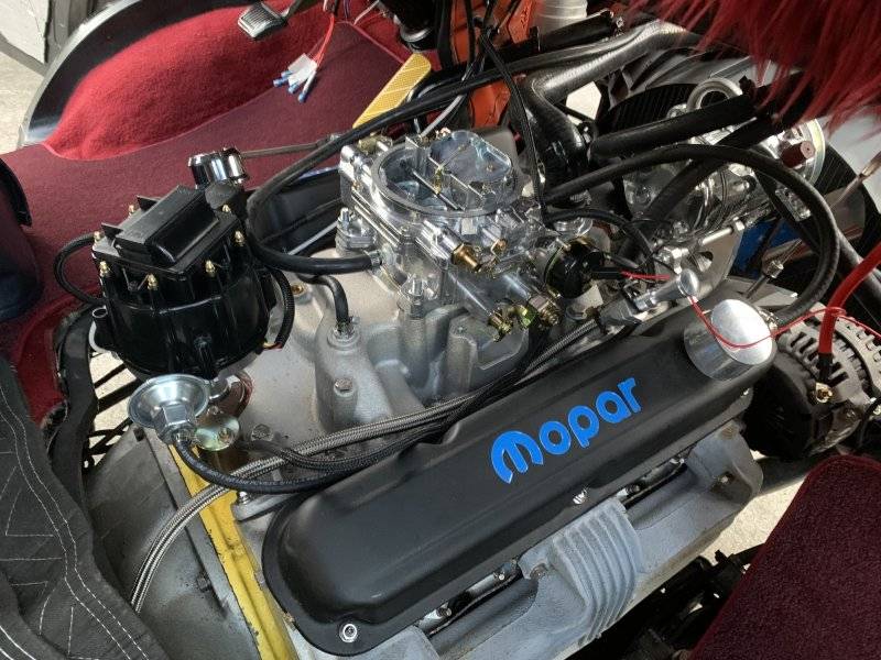

The starter cranks. Everything spins. No weird noises. Voltage is good at distributor and starter. I swapped in a different distributor, in case ignition module was bad.

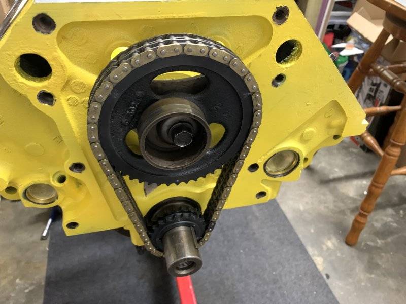

Timing is dead on. TDC of compression stroke at #1 cylinder. NOT 180 out. Changing to 180 causes backfire. I’ve reset many times. Twisting during crank does nothing.

Spark is strong, white, and consistent at every wire and plug. Have tested with multiple methods.
The van is fully grounded, with new engine straps and component grounds. All connected to bare metal.
The new fuel tank has 10 gallons of non-ethanol. No fuel leaks. The pump is delivering fuel through the Wix filter to the carb.
The carb is squirting fuel. The throttle linkage is a bit crude for now, but everything is connected and functioning.
I have not changed the carb’s adjustment screws from factory setting.
The carb’s electric choke is receiving good voltage and is grounded.

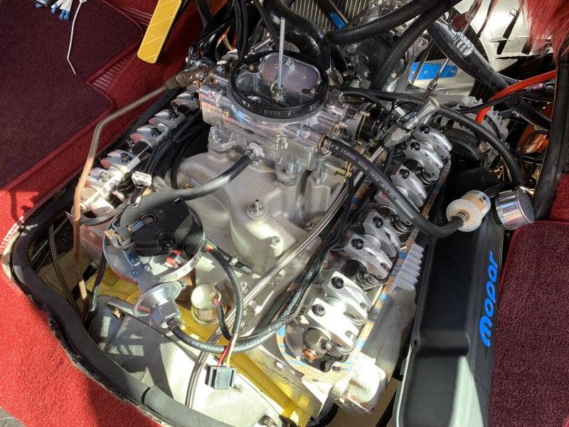

I set valve lash to spec: .015. Valve trains appear to be functioning normally. Oil pump is primed, and top end is receiving oil. No oil leaks.

I’ll take a stab. With that low compression I suspect cam timing.
Was it degreed?
You don't say which Whiplash cam (I assume there is more than one flavor), but the one I brought up for a 318 says that it is a hydraulic cam. Hydraulic cams are installed with a zero-lash and additional turns for a pre-load. You state that you set the valves with a 0.015" lash??? First thing that pops out to me.
I just set it dot to dot. I thought these whiplash cams were supposed to actually be pretty conservative. I may have made a big mistake there. Ugh.
Just to be clear, when you set the timing gears dot to dot, then set in the distributor, you had the rotor pointing at the number one cylinder, then moved it 180*’s out so it fires on the #1 cylinders compression stroke?
This would be a correct to do it.

Depends if you did what I asked above on setting up the timing.
You could be 180* out.

69Bee, you are right. I read the install sheet and somehow thought it said .015. I have no idea where I got that number. I will adjust to proper preload based on my block/head combo and hope for the best. Thanks!

Doesn't matter what the CR, engine should show signs of life when cranking. Even if timing was out, would expect maybe a backfire.
Couple of things to check;
- the HEI grounds through the dist body to the block. Make sure you have clean metal where the dist clamp touches the body. I grind some ribs in the clamp for really good contact.
- if tach is hooked up to dist, disconnect in case it is causing a problem.
- I presume you have check that the HEI is getting the full 12v during cranking. Run a jumper to battery if unsure.
- Remove dist & make sure there is an air gap between the reluctor & all 8 segments. If contact is made, no spark on that cyl.
- I presume the 0.015" you refer to is the amount the pushrod has depressed the cup in the lifter. Those lifters have at least 0.120" of travel [ & usually more like 150 ] & can be set anywhere within that range. So do not try & set them on the edge. Find the 4 position adjustment method on the web. Turn over the engine with a wrench slowly until you see #1 intake valve close; stop; continue to turn over slowly until the TDC comes up on the dampener. Adjust 4 valves. Repeat until 16 valves are adjusted. To adjust: loosen adjusters; spin p'rod with fingers while tightening adjuster screw. When you feel the p'rod has gone tight [ all play has gone ], tighten adjuster one turn further & lock the lock nut.
- make sure the carb is full of fuel!!! Fill the bowls using the vent tube until you see fuel coming out of the pri booster nozzles; also make sure the acc pump shot is working.
You say it does even spit or sputter unless the distributor is 180 out. If this is the case I believe you have spark while cranking. Not sure how you wire your HEI ignition feed? If the ignition switch doesn't have the blue and brown ( colr may be off thiese are car colors) wires tied together it may only have spark in crank. But not in run. Brown wire is hot in crank only. Blue wire is hot in run only. You have compression and fuel. The cam is lined up dot to dot. So unless there is some very wierd cam timing issue (which I highly doubt). I do worry about lack of cam lube after multiple attempts to run. Personnally I'd relube the cam and lifters.
