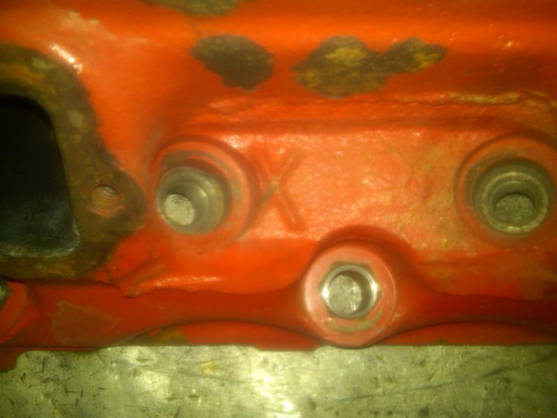

the block date is 7-8-69, any idea how to determine what it came from? also the heads have a large X next to the spark plug hole (never seen that before)

X heads came on 340 engines until about the 71 model year then they were J's. The 71's still had the 2.02 valves tho. The 68 through 70 should have 2.02 intake valves in the X heads. I don't recall any other heads coming on them during those years. A July casting date could have been in a late 69 Dart or Duster or an early 70. The E bodies didn't get a 340 until mid year or after January. Look on the front left of the block just below the deck surface and see if there are numbers there. They will probably be faint...not real sure if a VIN number will be there or not but there's usually some numbers there.

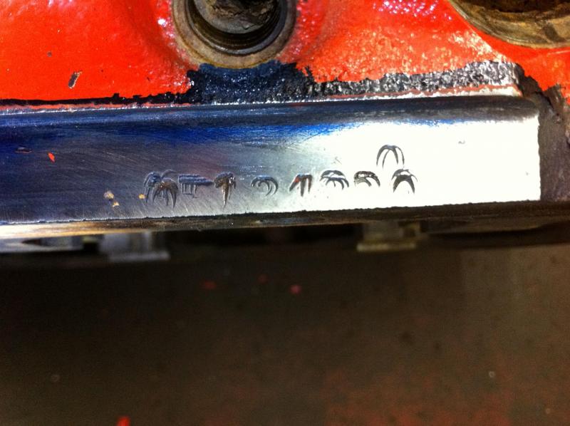

Ok Gents here it is - as I stated the following number is stamped onto the block FW340P29950220 on the drivers side below the deck and here is the image of whats stamped on the VIN Pad passenger side above oil pan. Might need to call the spirit world in order to determine where this block came from.
Any and ALL help is greatly appreciated

Have you ever seen a VIN Stamp this screwed up? like I said at the begining or this thread must of been a monday.. All help is greatly appreciated!!!!!
Nice....that must be the day after a hard nite drinkin....OR a new guy on the line
I'd say build the engine and enjoy it... WELLL at least you know it's a period correct 340 if it's a show car, and I got ya a little info...wished I could come up with more...but thats all my Bible is telling me (is what I stated above)..bout your casting #
Just had a flash....by chance did you rec'v any paperwork with the engine, you know recipts for a machine shop or something....alot times ( or at least we did at Lunati ) we would stamp a the work order number on the block, be another way to trace the history....maybe ??!!
