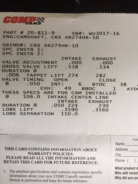

I suppose, a cam around 224@050 would work pretty good in there. I’m running such a cam now in the wife’s A body Cuda w/a Edelbrock RPM & heads @ 11-1 - 360cid engine w/a 904, 3.55’s and a 26 X 10 tire. It works very well. My transmission/converter guys suggested a 2800 stall. I asked for a slightly tighter 2500.
The Cuda advantages are a bit lighter in weight and a higher comp ratio, intake and cylinder heads. Your OE heads are restricted in air flow. This would of course limit power potential as well as lift.
Here is the cam card below. It is a Hyd. roller. The HFT has lower lift that might be OK with a stock head. This I am not sure of. Regardless, I believe this type of duration would be a good candidate. Check out the various cam grinders for there versions.
