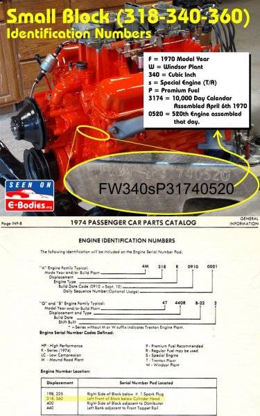

Hello. My 1966 Charger was re-engined by a previous owner . From 318 to a 360. How do I find out what year engine it is? Thanks

Look right below where the left head meets the block surface. The parts book info is from 1974 but should apply to applications in other years.
Well It is a 360 and I put the 4 digit number into 10000 day calendar decoder and it came up with Thursday, May 10, 1973! Cool
Thanks a million
Date is also written on side of the block in case
you do not want to do the math.
The cast date and assembled date can be months apart.
