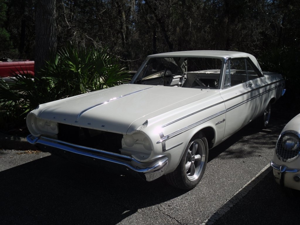

I am building a .030 over 400 for a performance street 64 Polara.
My short block is done. Cam is Hydraulic flat tapper,232 @ .050 and 353/357 lift with1.5 Rocker. KB pistons 0.0" deck height. Iron heads open chambered, cleaned ports, bores valve pockets, SS upsized valves.
