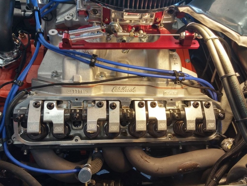

I'm over it. Going to run them on MRE hardened shafts. Mancini said run em, Crane said run em, and my engine builder friend Gary P. said run em.
T&D make a fine rocker arm.
