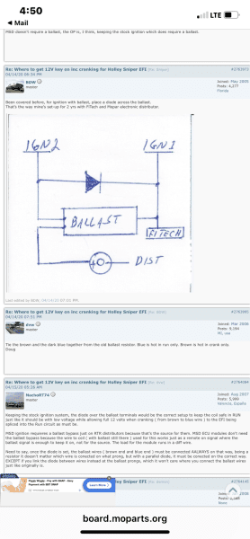

I found these two articles I think in Leaning towards the ignition one.
