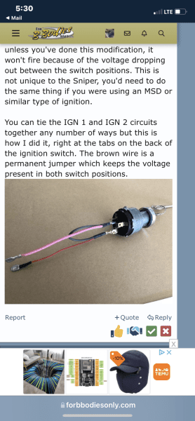

If you were not running a ballast resistor, simply tie the ing1 and ign2 leads together for voltage in crank and run positions. To keep the ballast by-pass operational, you can add a diode as described in this discussion.

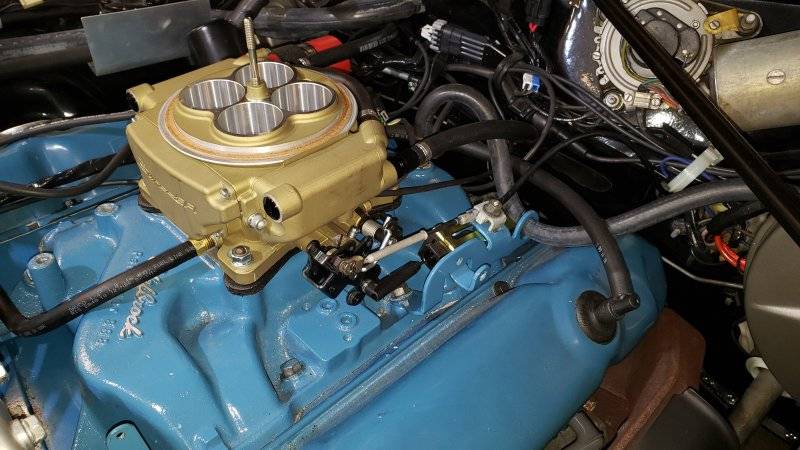

We’re did you get your throttle and kickdown bracket? I bent mine similar to that

I found these 2 articles and I’m leaning towards the ignition one. I will invest in the hyperspark distributor before spring. I still have about 4 months of winter lol so no rush to drive her just yet
Ha, that second screen shot of the ignition switch is mine. That’s really the best (cleanest) way to do it. No need for the ballast resistor after doing that.
