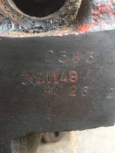

Right under the distributor there is a flat pad. On that pad you will have numbers. Those numbers will say something like D383 HP or HP2 The letter may be different because I dont know the letter for 69 off hand. But it should also give you a date that the engine was built. One of the few differences between a 383 magnum and a basic 383 was a cam, exhaust manifolds and a 4bbl intake, which you have HP manifolds so that's a plus. I'm pretty sure all of the HP engines got 906 heads for 383HP or a 440HP. And the only difference between a HP and an HP2 is what time of day or night the engine was built. HP day time HP2 Night shift.

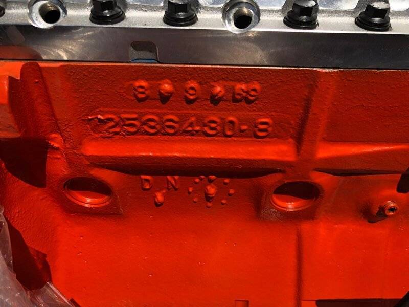

On the side of the block you will have a number embossed into the casting. That number will tell you when the block was cast.

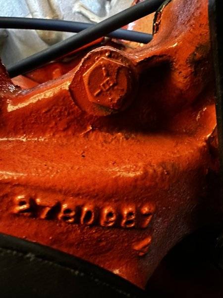

On the passenger side of the block there is a flat spot just above the oil pan there should be numbers punched into that section. These numbers will tell you if its the correct block for your car. It should have numbers that match your VIN.

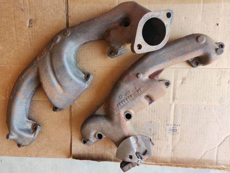

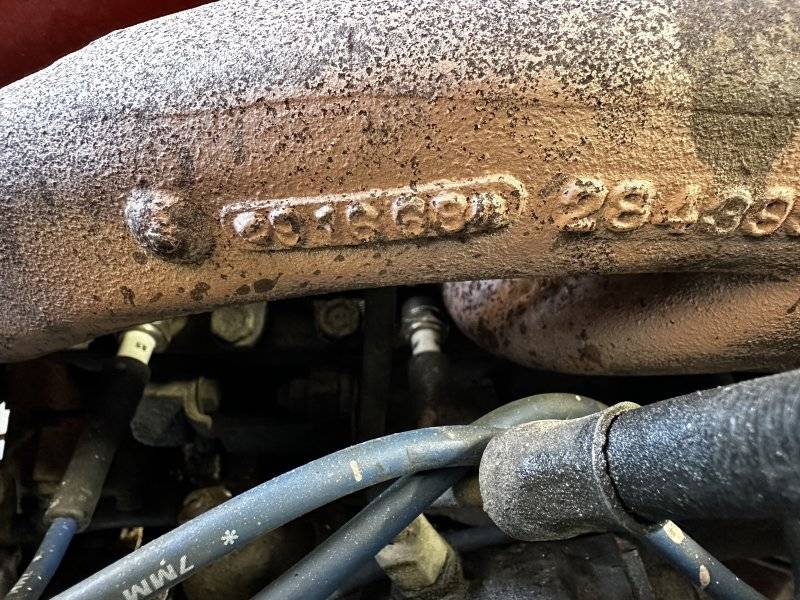

Thanks for that info. Do you know what the numbers on the manifolds mean? What makes them high performance?
They were made in Sept 69, so your car I'm going to guess is a fall car. If they are orig to the car.

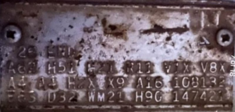

Pic of the fender tag?
These would be regular 383/440 cast exhaust manifolds. Dates on the castings will just tell you when they were cast. Yours say I think 9-16-69 and look to be somewhat correct. Year one makes reproductions but they have a huge Y1 cast into them.

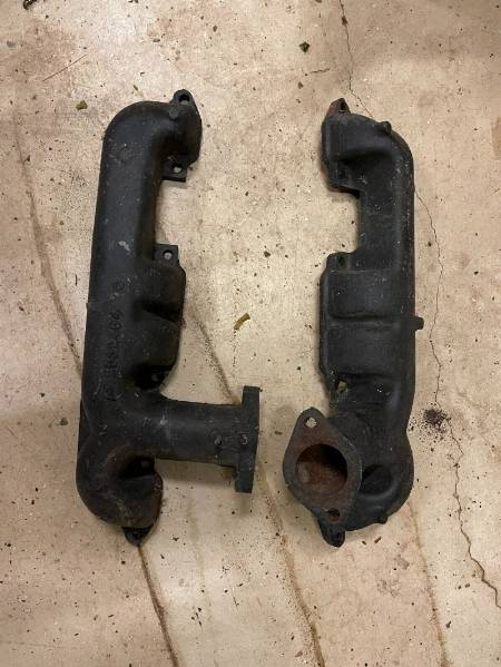

Standard Exhaust Manifolds
HP Exhaust Manifolds

That would make the manifolds highly likely that they came with the car.
So get the #s off the distributor pad!

Look on the front pad for E383 and the HP stamp.

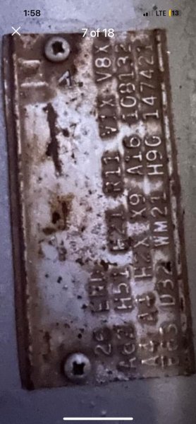

IF this is the tag to your car, then no, the car did not come with the orange 335 horse assembly. Cars with A/C (H51 on the tag) came with the 330 horse turquoise assembly.
Again, the intake and exhaust manifolds were the same on both 383-4bbl assemblies so that's not an indication of HP or not.
Again, the intake and exhaust manifolds were the same on both 383-4bbl assemblies so that's not an indication of HP or not.View attachment 1582415

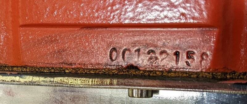

I have a 1969 383 that has a cp stamped in the pad by the oil pan. Is this a pursuit car engine? The block pad feels like the milling is uneven. Was this normal or has someone attempted to alter this number? Any help would be appreciated. Thank you
Can you please post a picture of what you are seeing?
Mopar did not have a 'pursuit' engine assembly specific to 'cop cars'. The same assembly that went into regular cars went into cop cars.
