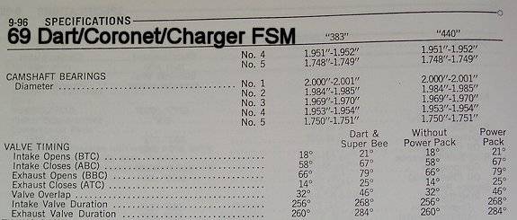

Here's the cam specs from the 69 Dodge FSM. The 383/440 HP cam had the 268 duration.
The same PNs apply for 1968.

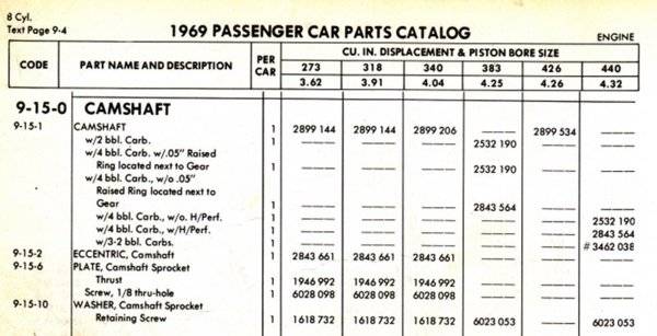

The 2843 564 cam is the 335 horse cam. The 190 cam is for 383-2, 383-4 330 horse and 440-4 350 horse (C body)
