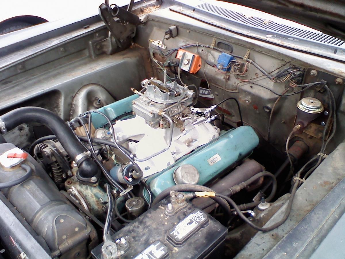

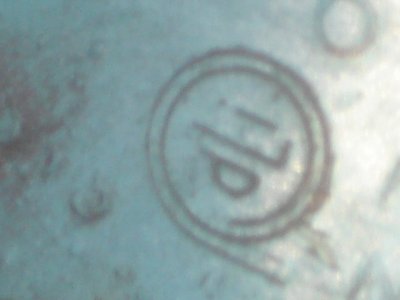

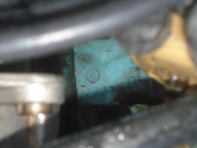

I am new to the 383 game, i've got 426 and 440 in my other cars but this Dick Landy (dli) built 383 has no problem smoking the tires on my 1964 Porala even with the 2.93:1 ratio rear end!

Is the DLI stroked? What comp ratio? What heads? Do u know hp it makes? I know alot of questions
