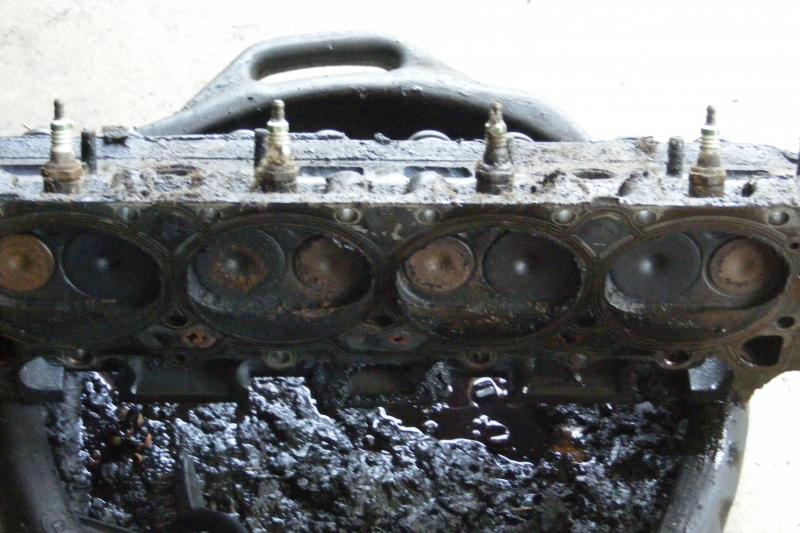

I took my 1967 B block into my engine guy. The exhaust valves are shot, etc... He's telling me that the valley pan needs replaced because its a gasket. The valley pan is thick solid piece. it's better than the ash catch on my weber grill.
Is this true or is it a tall tale???

The exhaust valves and seats where built for leaded gas
If that's all you're Looking at you're lucky. That shouldn't be an expensive replacement. I think I might even be able to do it..... And I'm no mechanic.
