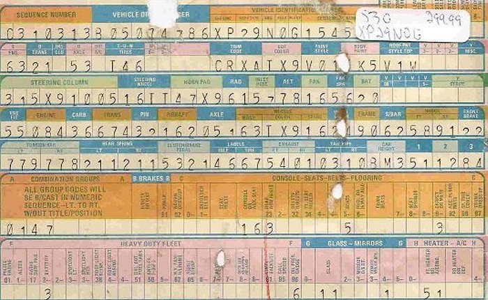

What would be the code for 335 horse 4 speed with A/C ..
for 1970= 084.
XP29 E63-D21-H51

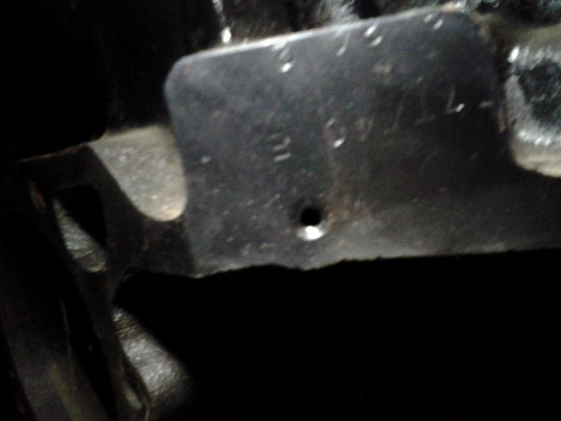

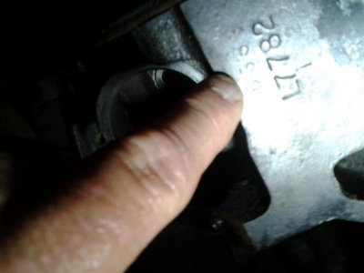

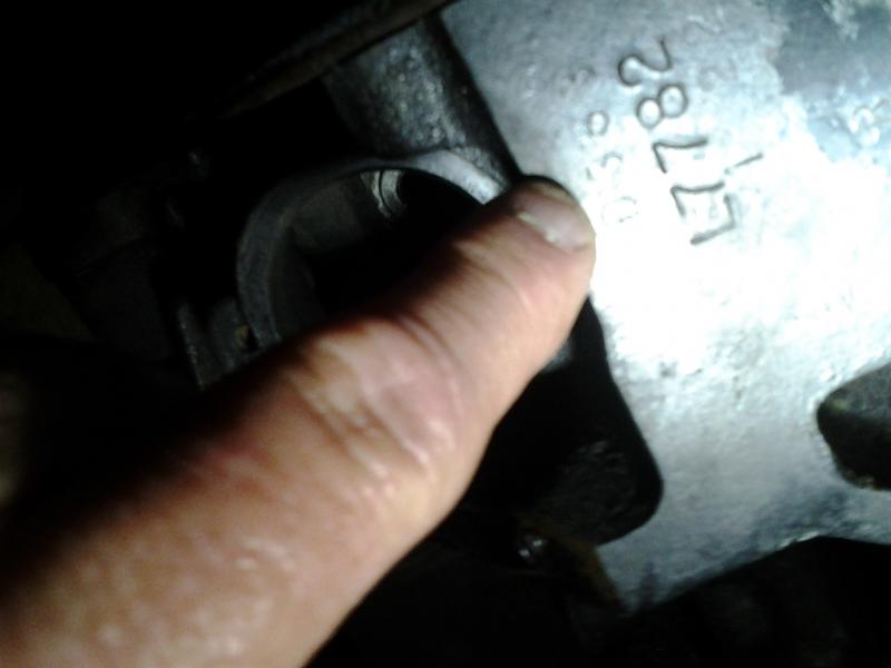

Ok dude here are two pics of the block telling what the motor is i have a dozen more but just for PROVE IT IS STAMPED ON THE PADS AS I SAID. I ain't sure what your problem was but hanging up like a little kids grow up.

Did I miss something in the post? is that the pad on a 440, or 383? I can't tell.
Not sure what's happening either.
The top pictures looks like D383 and some other stamps.
The bottom picture looks like a cast crank '77 440. (7T440 E)
two different engines, can't help without more Information.

I posted the pictures cause the guy that started this post asked me if i knew how to tell what engine i had and year but he didn't wait for me to explain he got mad and hung up the phone before i could tell him what he had asked me which was the year of the block & so on he said that it was not stamped on the pad and i just wanted to show where it was and give him more info on how to check.
I know where its at, but you wanted to do all the talking and none of the listening. If your selling then maybe you should listen to what I was asking!!! When I asked if you knew how to tell you said the 383 and 440 were in the same spot. There not. I'm sure you found that out when you went to your garage to take those pics. Not even sure why you even brought up the 440.
I asked if you new cause most people I talk to on CraigsList think its the casting #
