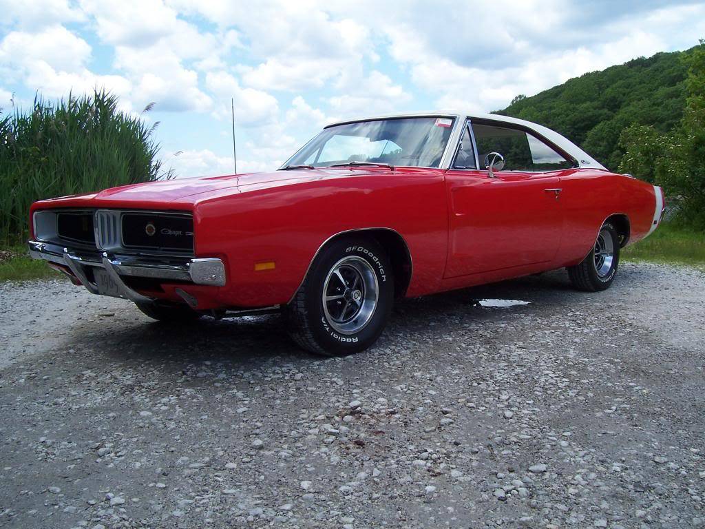

My original engine in my charger is long gone but has a 68 casting 383 engine in it now so I have nothing to go by other than the VIN on the dash and the fender tag.
At least you have a 69' charger, and titled 383? your car will be good with either, since the original is gone anyway. people won't care, chargers values are thru the roof. I can scan and email you the section referring to the 383 in the charger. it clearly states HP 383 engines weren't available in 69'. So, I would look for a date correct block if you want a 69' engine and go for it. Most people don't know the difference. My 68' is a factory 383 two barrel car with a 68' four barrel sport satellite 383 engine in it, no HP stamp. The value of the car is every bit as much as if that original engine was in it. So you have a great car. I have a E383 HP block if you really want a 69' engine. it is dated march 11 of 69. Even my 68 383 dart GTS numbers matching engine/transmission isn't stamped HP.
Its no biggy to me. I drive the crap out of the car as much as I can and I really don't have any extra cash right now to build up another motor. All of my money is going to the resto of my Dad's 69 GTX vert.
I just happen to remember the casting date of the block in my charger now as it shares my birthday (not the year) 7 / 22/ 68. My birthday is exactly 8 years after that! lol.
I'd like to see that 69 convertible, that is quite a car. You can't lose on the Charger. This numbers stuff is just a little to the extreme anymore. if mine match, fine. if they don't, I'm fine too. If your block is 7/22/68, that is likely a 69' anyway. Look at the pad date by the distributer. LoL

Beautiful charger, resq302. A guy can never see enough nice chargers. The colors and road wheels really make it.

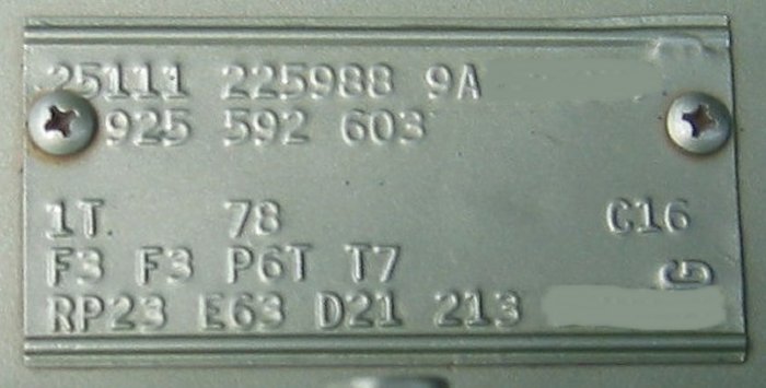

there's a lot of wrong info that's been repeated through the years. If you check any B body four speed non A/C broadcast sheet or Lynch road fender tag, you'll find the 925 engine assembly.
Probably because there was only one A body 383 assembly where B bodies had two. There would be no reason to stamp an A body 383 to differentiate it from a different assembly.
