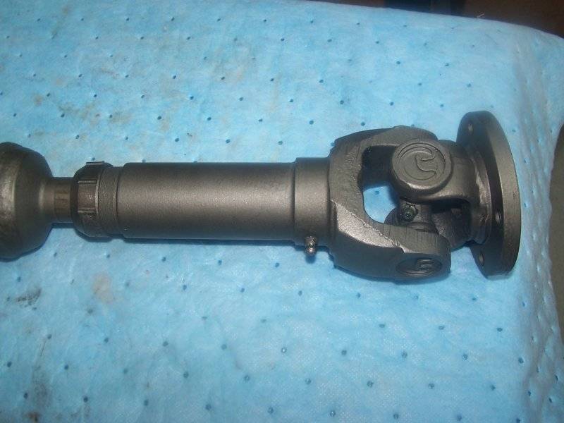

This is what the shaft is going to be like.
I would get it made and see how it works out. You might be fine. If you do this you should also check the drive line angles and correct them if needed. To convert to a two piece drive shaft is a lot of work and fabrication as a center support crossmember would have to be made and installed then the shaft made.
I don't know the actual physics with that driveshaft, but I can see that vibration could be a real problem with any wear whatsoever.

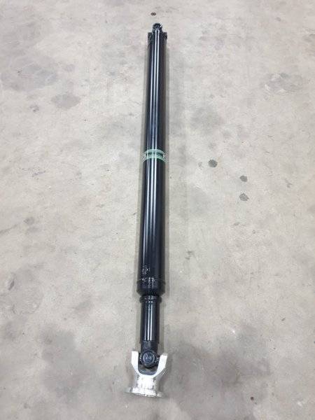

That set-up is the same design as what I have on my 60 Dodge Dart. I had the Ball & trunion chopped off and a U joint put in it's place 25 years ago. I have no vibration and my driveshaft is close to the length you will need if not longer. I have not measured it though. My Dart has no where near the power or torque you will be dealing with but if your drive line angle is correct, it should be problem free. At least worth a try.
So I've spoken to a few guys. One has a Hemi swapped Fury and a total length of 66 inches, no problems. The other one has a 68 Roadrunner and has a length of 62 inches, no problems.
So I'll be giving the drive shaft shop the green light.
