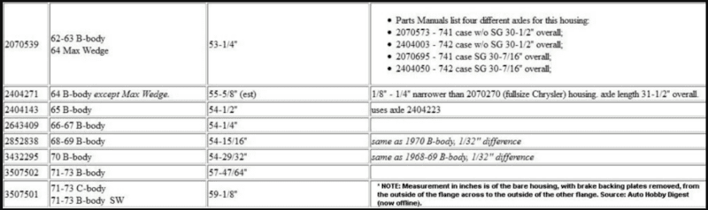

Will a 17or18"x8" wide wheel with 4.5" BS fit on front/ Back of 1962 Plymouth Fury ? Tire size 235/60/17 28.1" dia or 235/55/18 28.2" dia. Going to use same size wheels on all four corners. Or will I be better off going 17x7 /18x7 with 4.0 BS ?????
Were you able to verify this? Are you running the stock rear end housing? I am looking for similar information, but i swapped out the old unit for a '65, which is a little wider overall.
