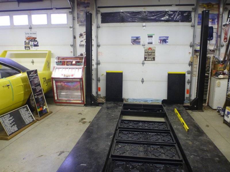

You'll pretty much have to go through all the manufactures and grab their specs as lifts are all over the place. My Direct Lift extended's leg CLEARANCE is wider than my 9' door.
