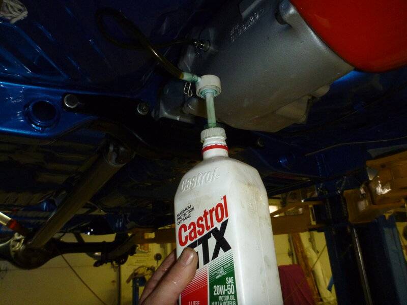

The Factory Service Manual calls for 7.5 pints (1/2 pint short of a gallon). I just put a gallon in, minus what dripped as I was trying to install the plug.
I attached a vinyl hose to the bottle and filled it from under the hood. Worked great.
