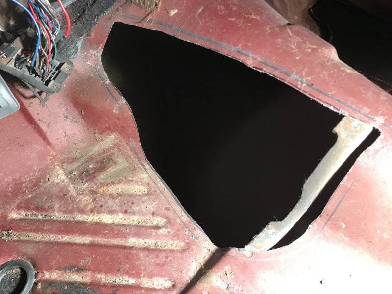

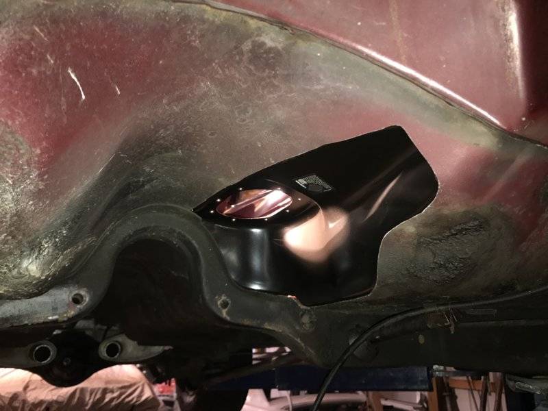

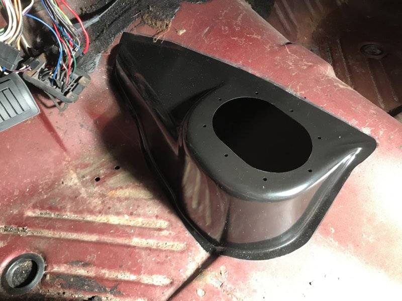

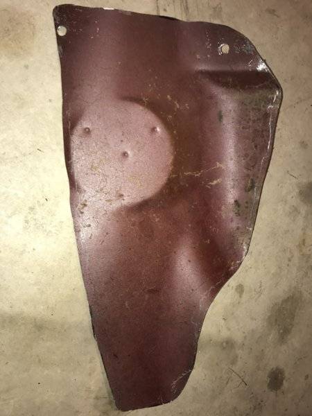

Here is my 68 coronet.
CF54F67D-E951-4DF4-A639-89642D57E32A.jpeg 10F51819-CC08-43DC-9800-2B3CF5EF8CBC.jpeg 20733B14-B239-4E9F-A479-D8E5075FB001.png E0633D38-3CC9-4640-BCBC-9F6BB69CC844.jpeg
In the first pic, you can see the outline and the cut line that 5.7 was talking about
Also, I used JB weld epoxy to attach the AMD shifter hump. It’s not structural, so instead of welding it in, I epoxied it. The thought was, if I (or a future owner) wanted to convert it back to a column auto, they could remove it and weld in the floor part I cut out.
