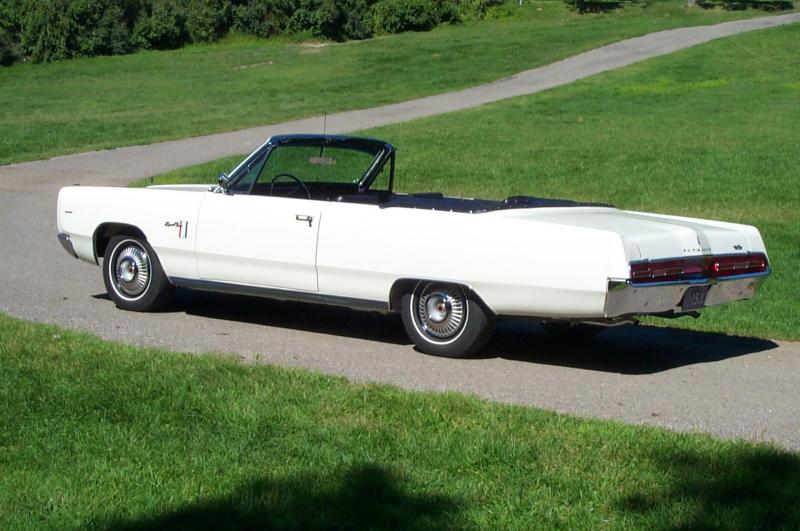

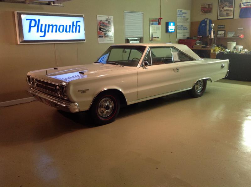

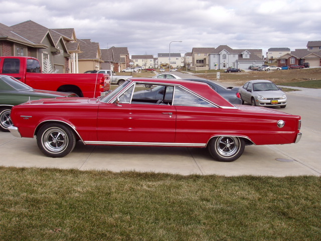

Thanks Jakepiney for your picture! I couldn't get a picture to post on a PM for some reason, so here is my 67'.

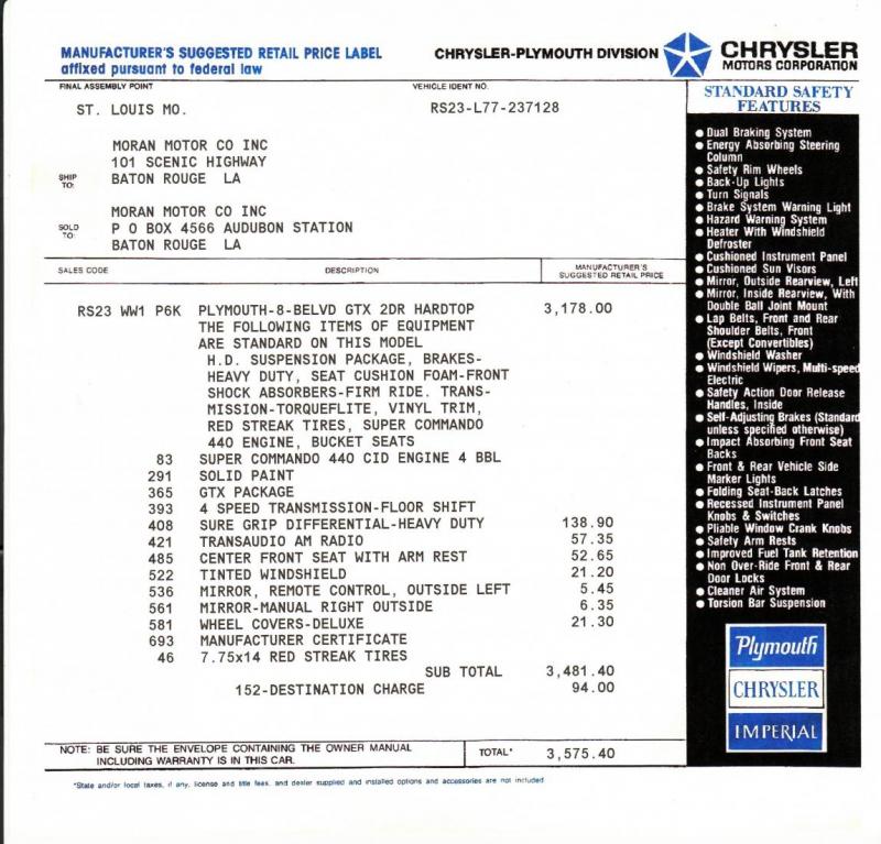

I have a one owner GTX that my brother bought new and I took the window sticker off when I was 13. All 4 speeds came with the Dana 60. also unsilenced air cleaner (no snorkels) dual point distributor, windage tray and clutch fan. 18 spliine transmission with Inland shifter and AC was not available.

window sticker I re created, I have the actual on from the car. Note the 4 speed and Dana 60 option. You could not get a 4 speed without the Dana.

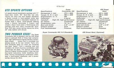

Was it the same for 68 GTXs, if it's a 4 Speed did all of them have a Dana 60 in it?

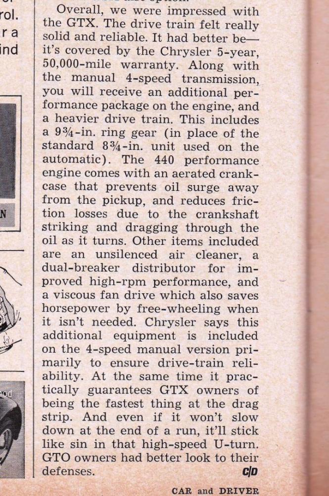

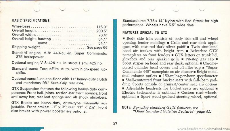

From the 1967 dealer data book: Mandatory 9 3/4 Sure Grip. Four speed was a no cost option but required the purchase of the Dana.
In 1968 looks to be the same as 1967 with the four speed and you could get a performance axle package option with the automatic
From the dealer data book. Mandatory 9 1/4 Sure Grip. Four speed was a no cost option but required the purchase of the Dana.
