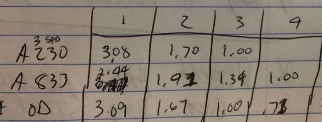

She has factory 15” Rallyes with 245/60R15 tires on her. I was digging around and since I’m already running a 3 speed if I put an overdrive 4 speed in I don’t think I’d notice any difference between 1-2 and 2-3 between the two based on the gear ratios I found listed. Forgive my horrible scratch writing.
Good point on 3 speed splits vs OD 4 speed splits.
Most people forget that a 3 speed was standard in a LOT of late 60's muscle cars and many were built that way.
