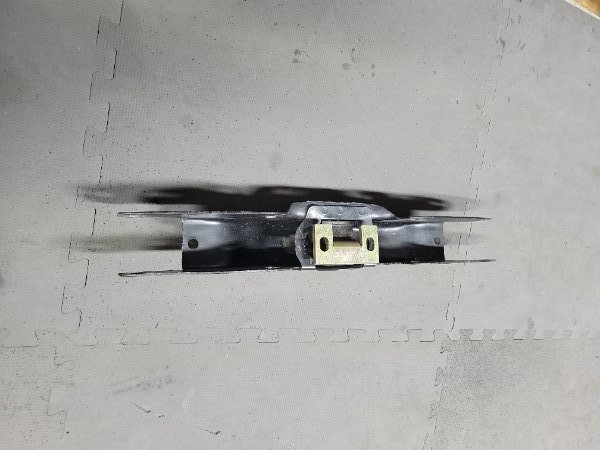

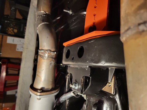

My questions is. I was putting the engine and 4 speed tranny in yesterday. 69 Charger All assy on the K frame. Went to put the tranny cross member in and the mount location on the tranny was 2-3 " in front of the rubber mount. But if I use auto cross member and put the bump out section on the cross member facing forwards the 2 holes line up. I got the car as a project in pieces and boxes. SO is the tail shaft mount in the wrong location? A body? The OD length is the correct 27"? A 70 Mount? Thanks

Here are two pictures of the two cross members.
The B body four speed mount location changed in 1970, and they used the auto crossmember. You have a 70 up tailshaft housing.
Thanks . Thats what i was thinking after doing some research,
part # is a 70 4 speed tail shaft. Still works for me, as I have both a 69 4 speed and auto cross member
