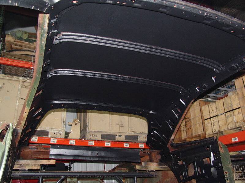

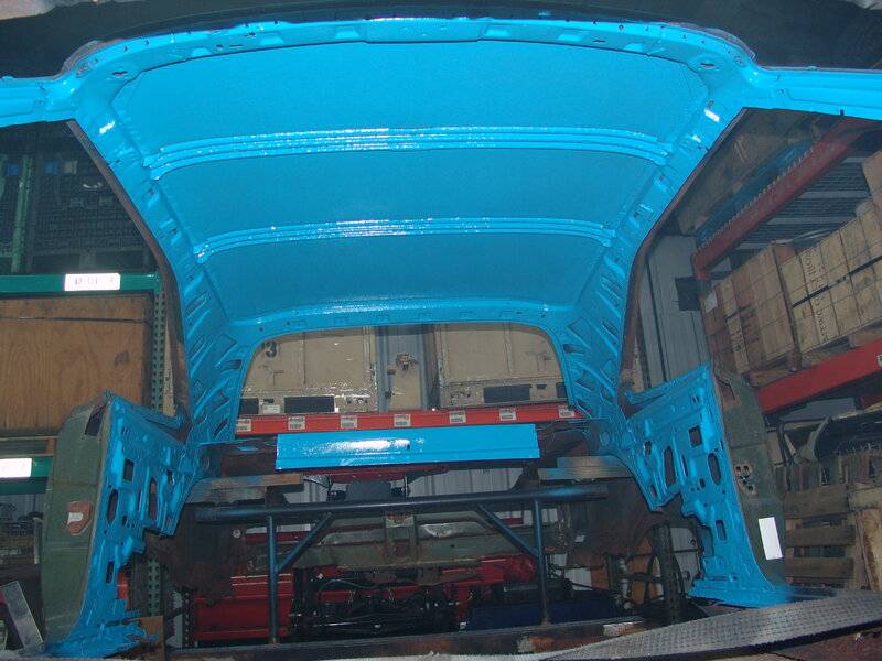

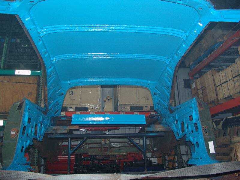

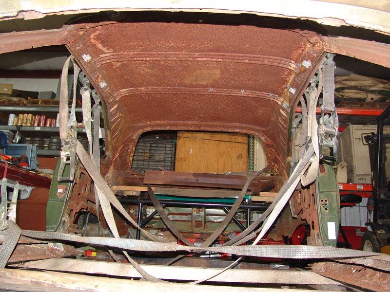

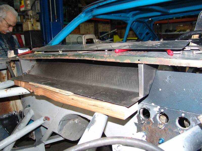

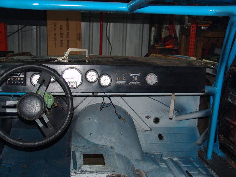

Blasted the inner roof and epoxy coated it. I need to get some color on it and the roll bar before I can weld body on chassis.
View attachment 1219915 View attachment 1219916 View attachment 1219917
Cool , looking good!!!! What did you use to blast it with???? I've tried all kinds of equipment myself including a Bad boy blaster unit, abrasives, soda, etc, etc!!!! I hung Harbor Freight tarps all around the car but still made a mess of the garage , especially with the soda.......everything in sight was white!!!!! Then I tried a pressure washer wet blaster setup out in the driveway. That worked pretty well but my wife didn't like the coal slag all over the place.....including her plants!!!!! I've been toying with the idea of a vacuum blaster but some people say they're really slow!!!!! Any\all feedback greatly appreciated. Thanks,Rick

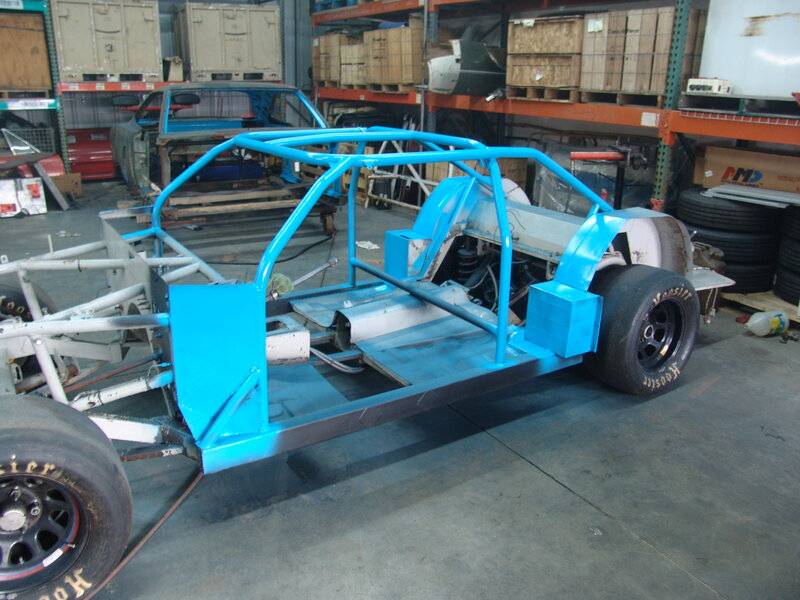

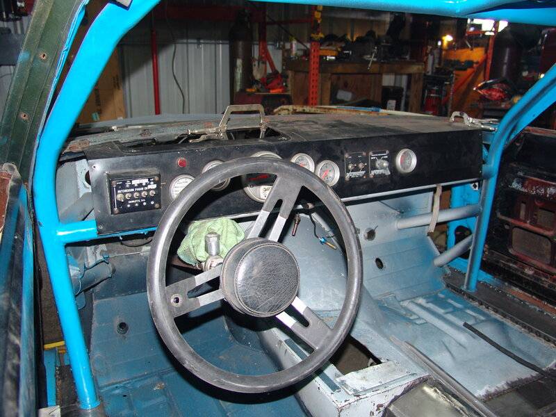

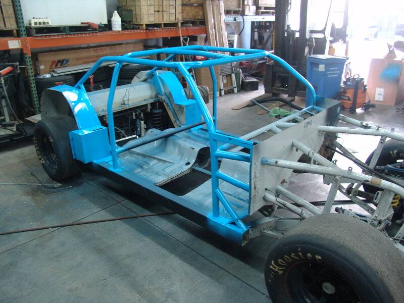

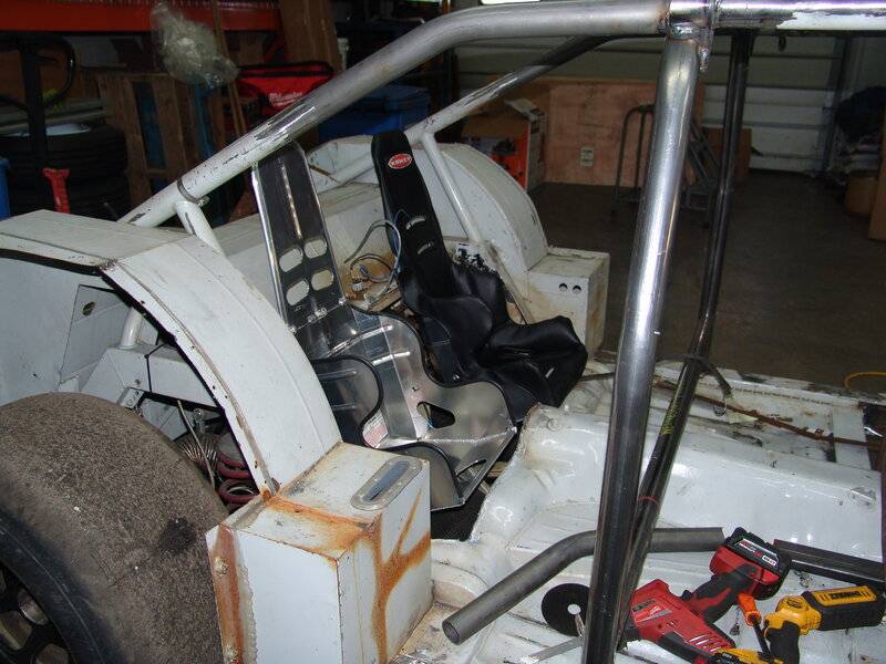

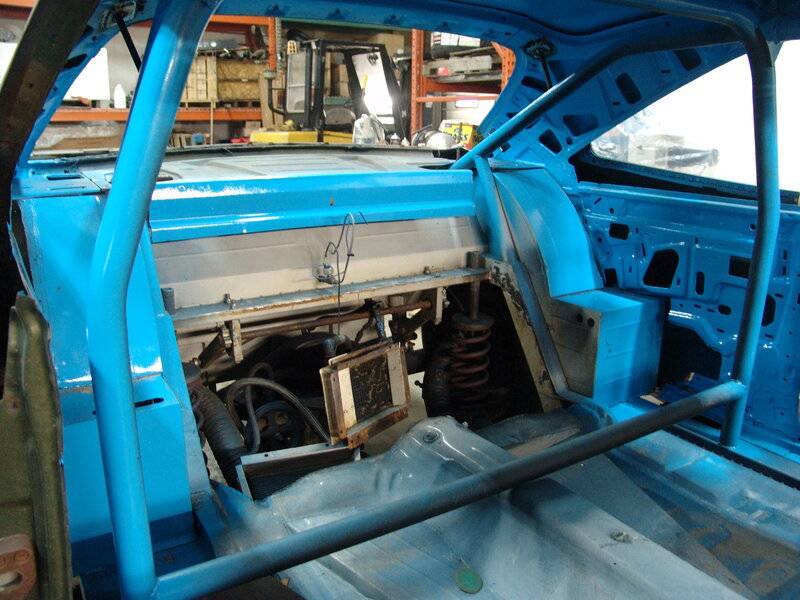

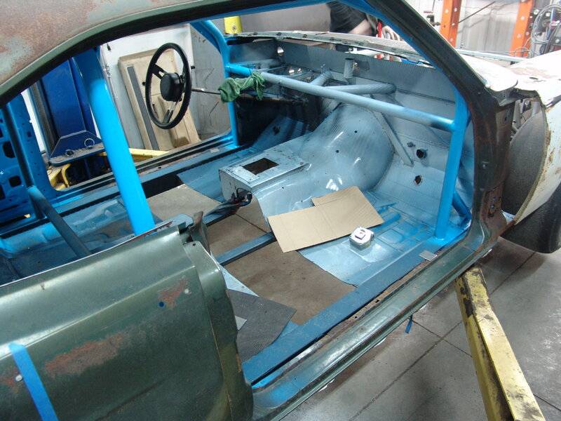

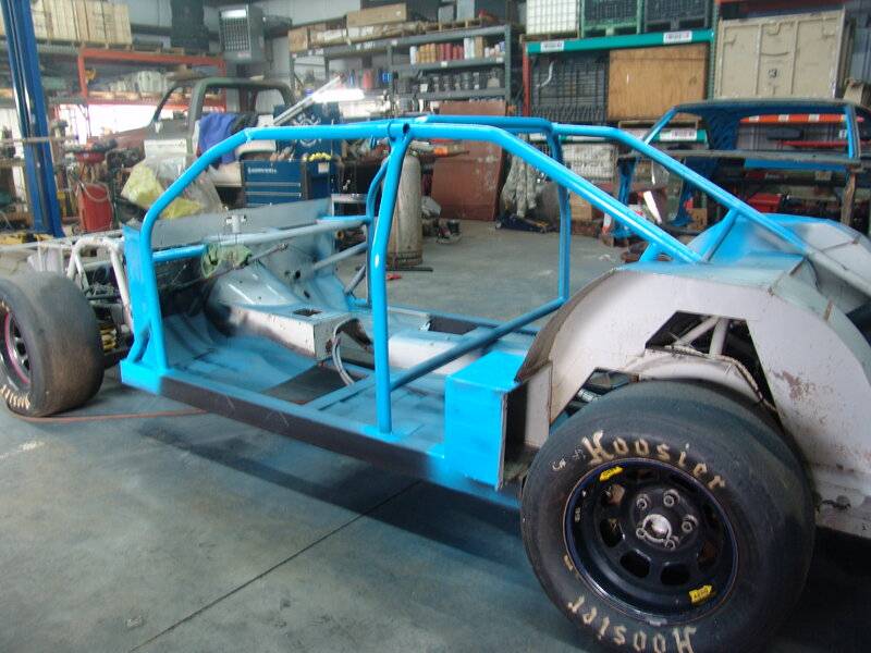

Got some color on the inner roof and cage. Now we can start mounting body tomorrow.
I did the pressure washer wet blaster setup with Military cargo covers on car. Made a huge mess but it's done.

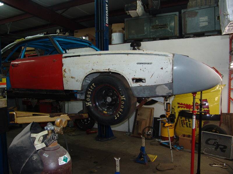

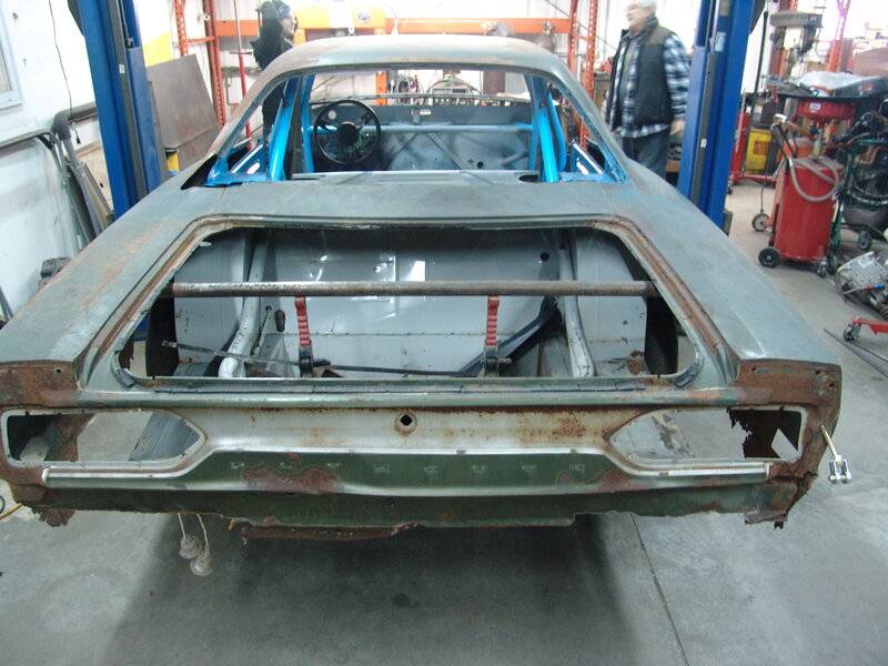

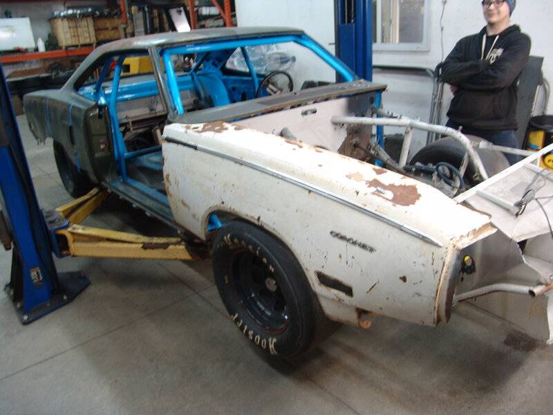

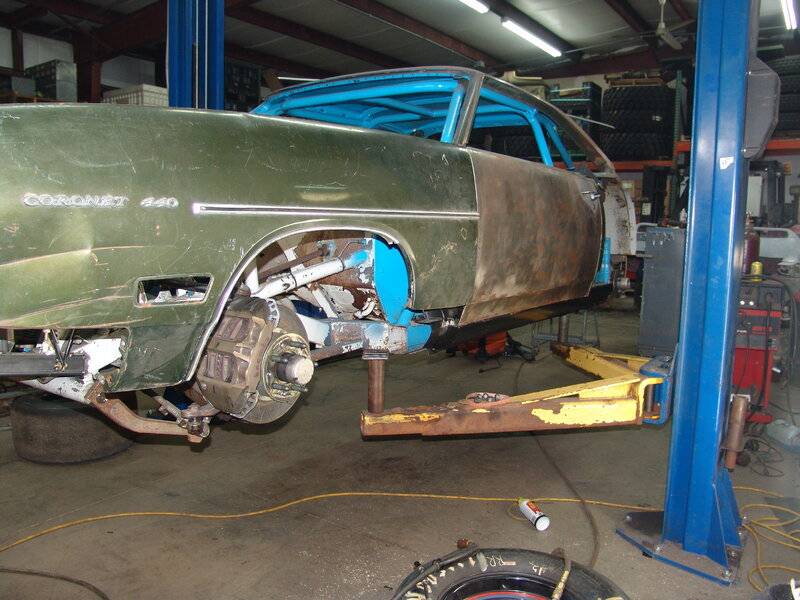

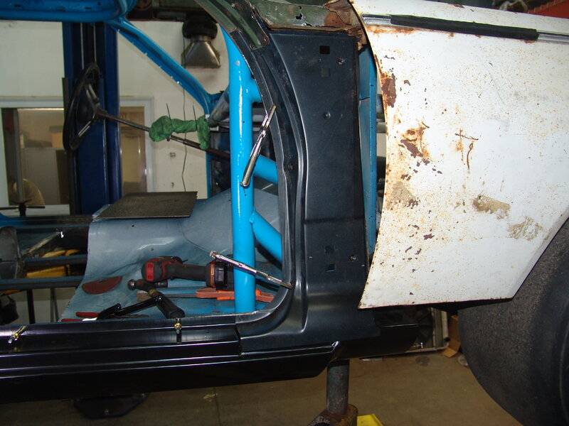

Body has landed. Now need to do lots of sheet metal work.

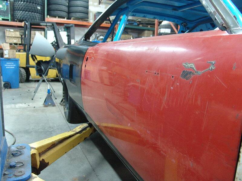

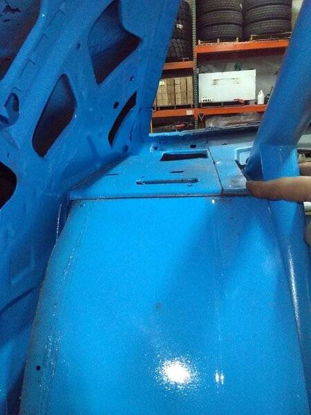

That fits great....after a lot of work.
I got lucky with this chassis. The A pillars fit perfect with the cage. Also the top of the rear wheel tub being flat worked perfect with the rear package tray. Being a Monte Carlo Nascar I think it really wanted to be a Superbird.

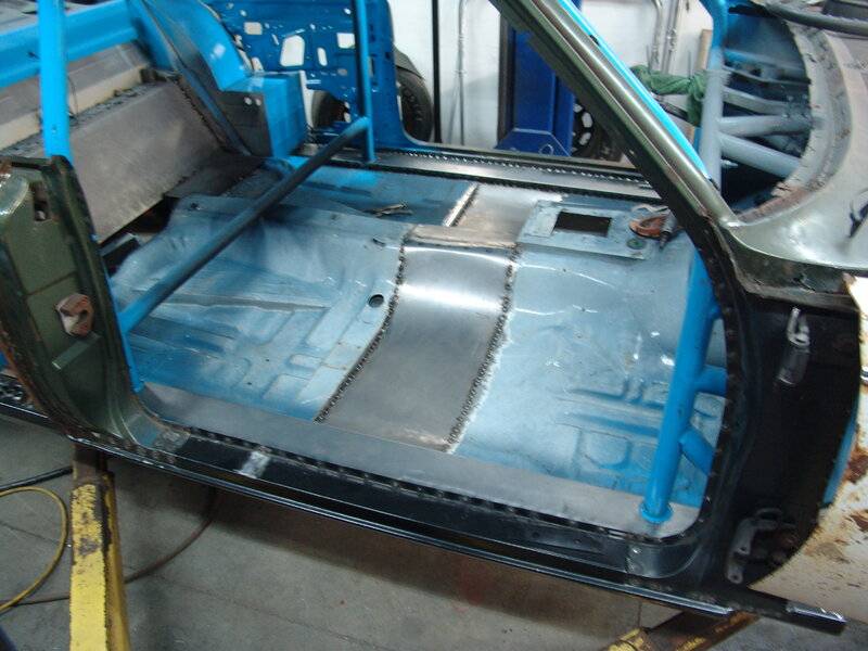

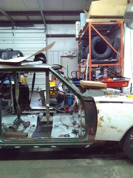

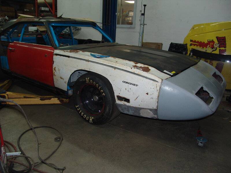

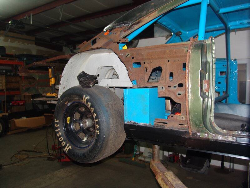

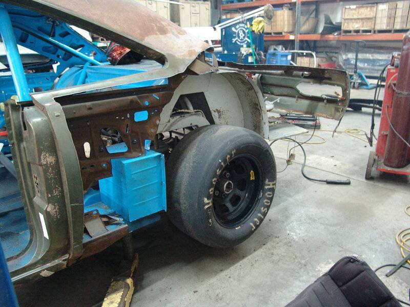

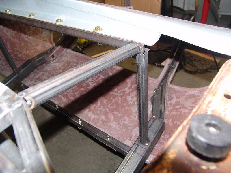

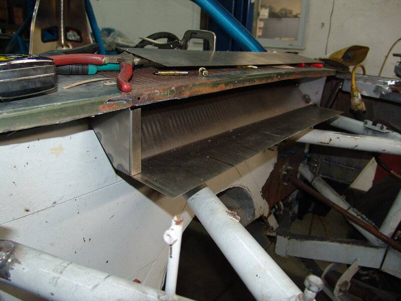

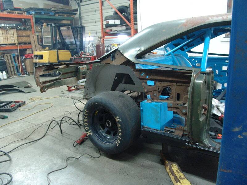

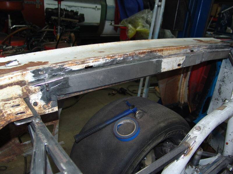

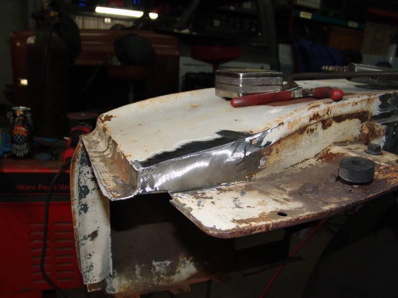

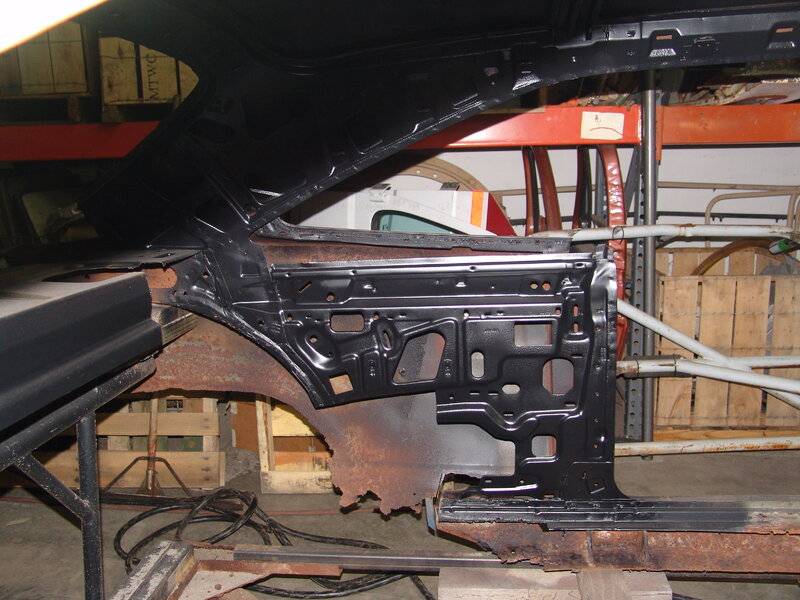

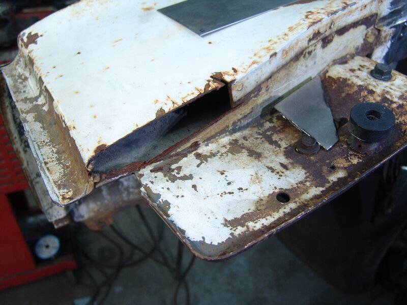

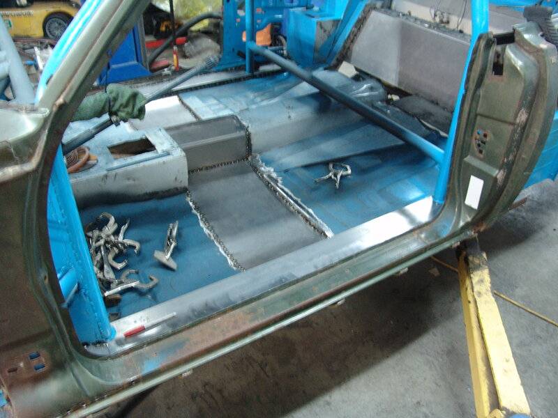

Now that body is some what mounted I can start with rust repair. Got everything mocked up today. Tomorrow I will weld it up.
DSC09069.JPG DSC09070.JPG DSC9070..jpg DSC09071.JPG DSC09072.JPG DSC09073.JPG DSC09074.JPG

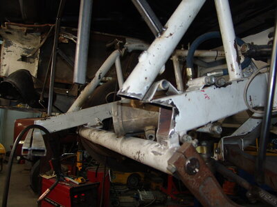

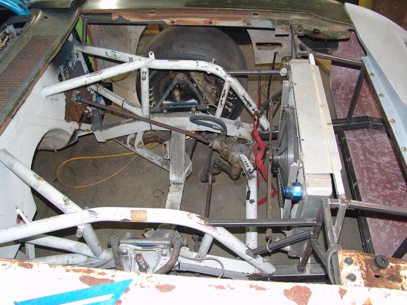

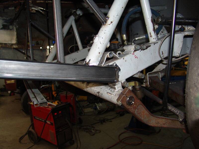

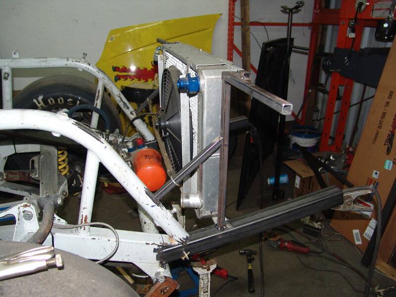

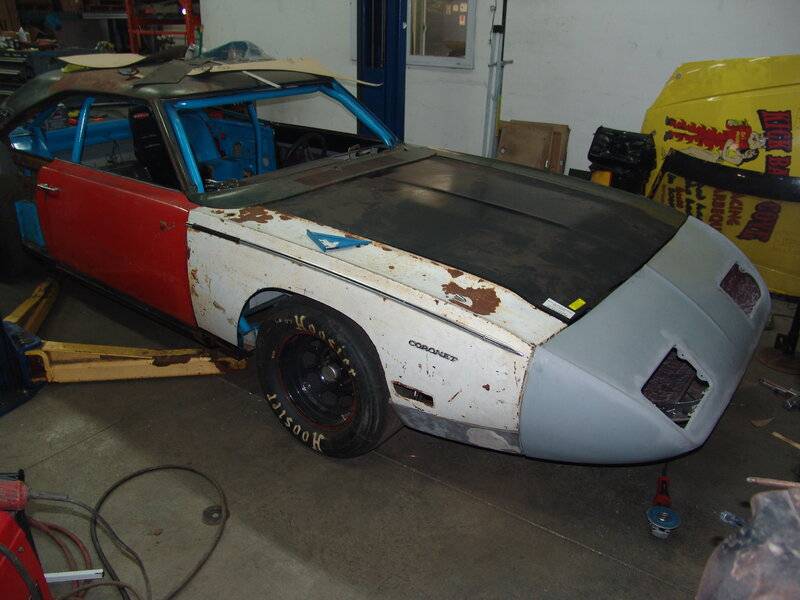

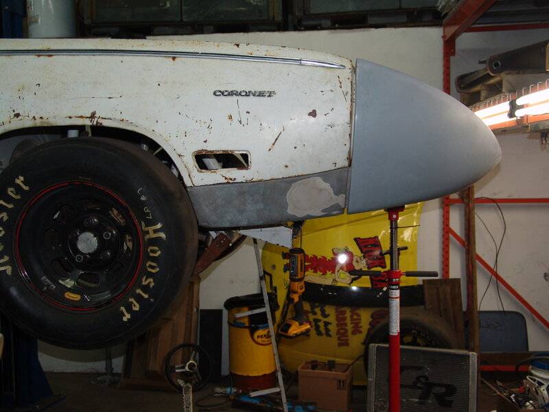

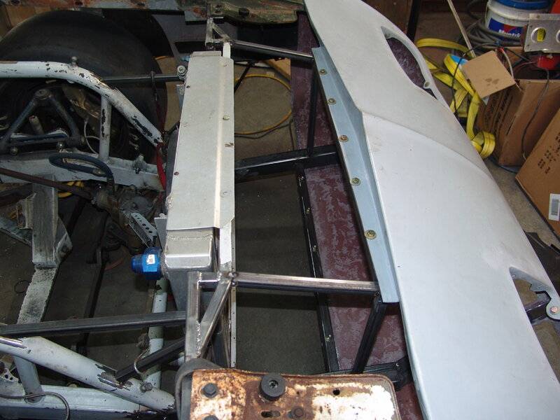

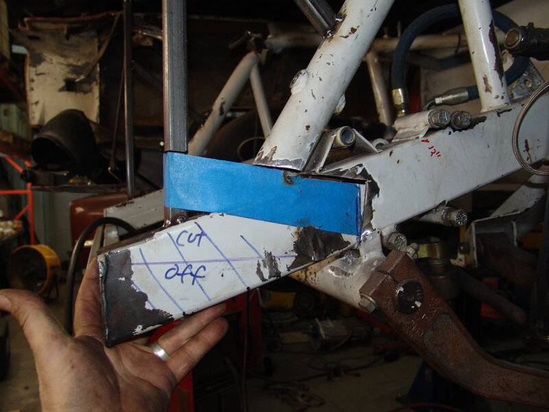

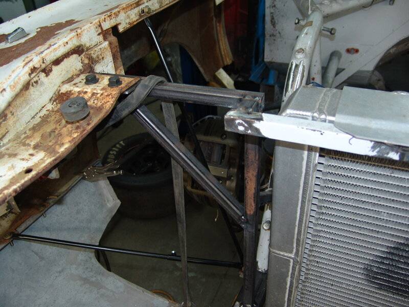

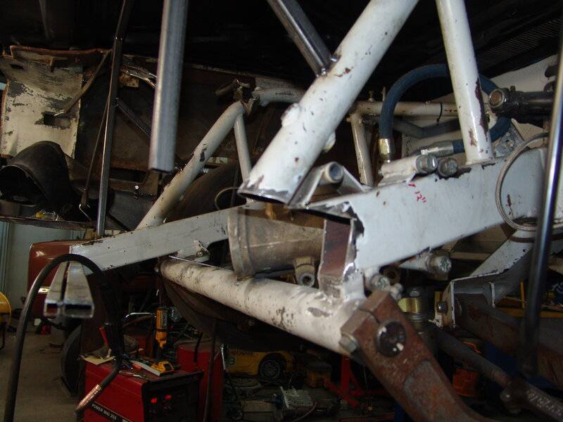

Started mocking up the front end and didn't like how the Nascar frame came out below the nose. We cut it off and added some 2x2 box tubing and redirected it into the nose one.
DSC09109.JPG DSC09110.JPG DSC09111.JPG DSC09112.JPG DSC09113.JPG DSC09114.JPG DSC09115.JPG DSC09116.JPG DSC09117.JPG DSC09125.JPG

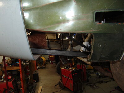

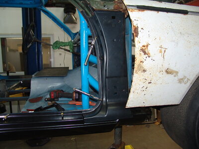

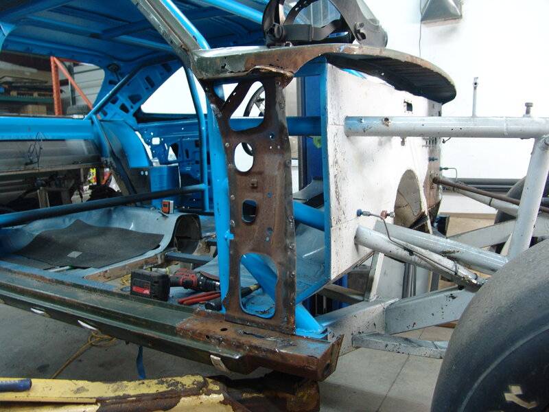

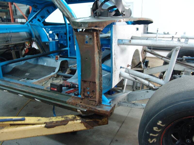

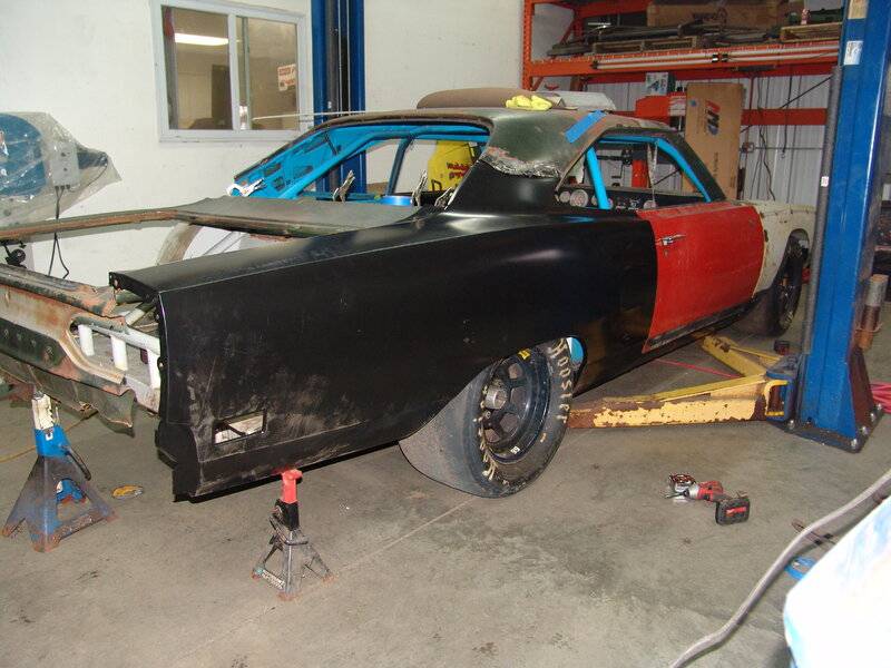

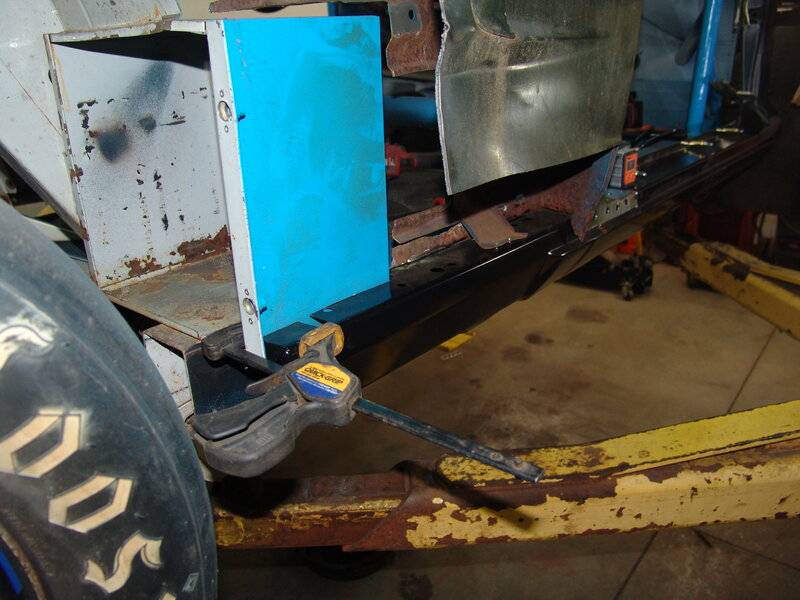

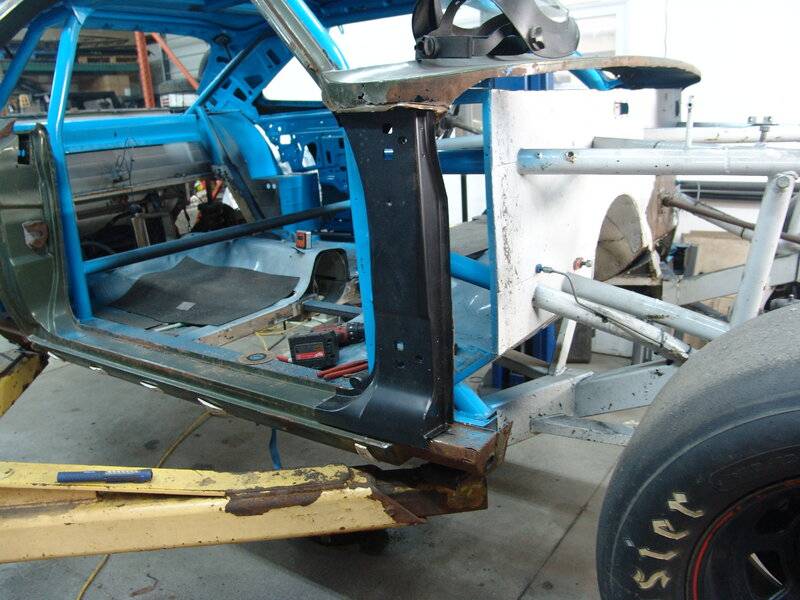

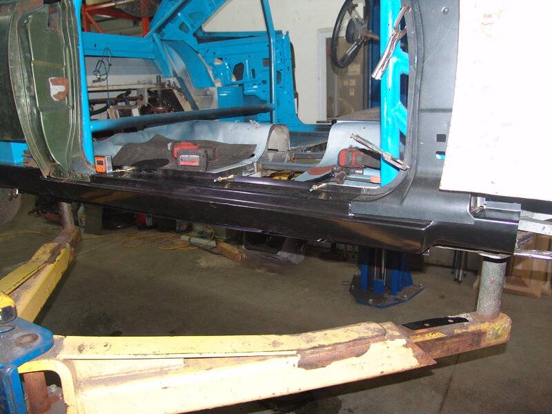

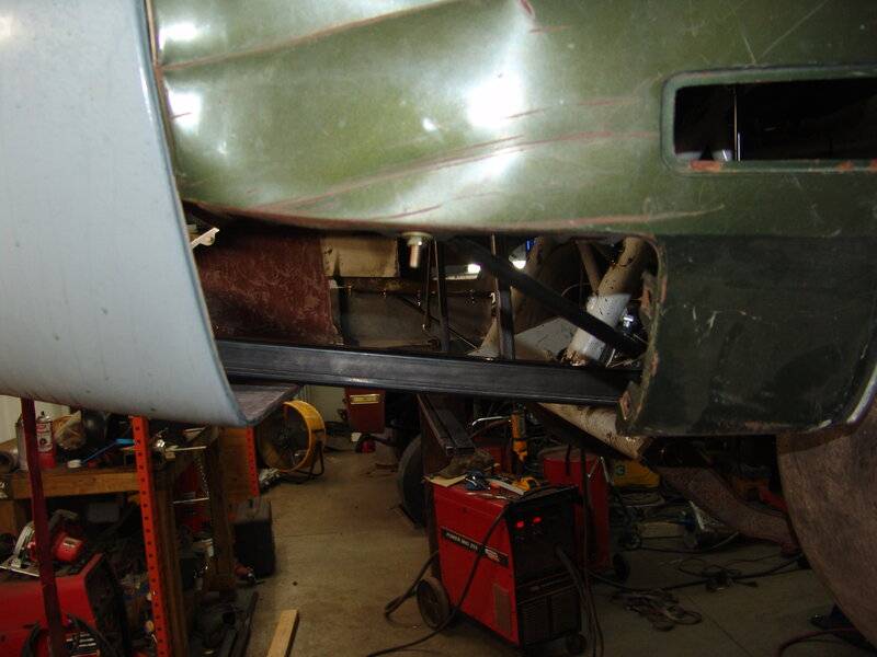

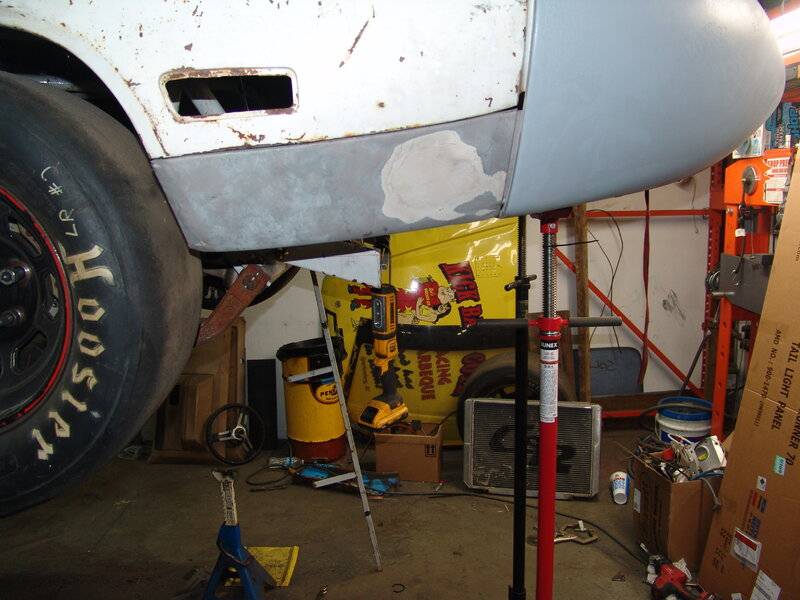

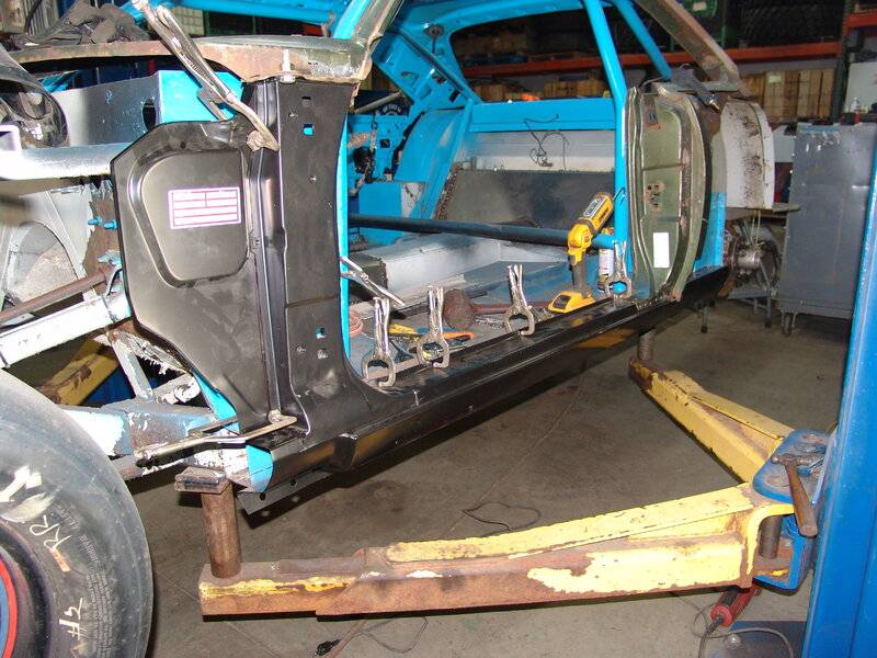

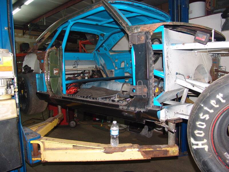

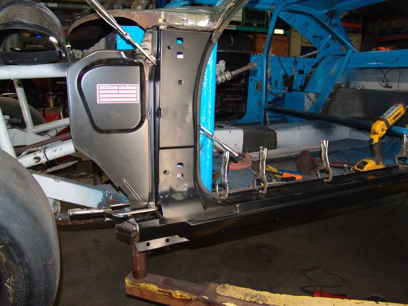

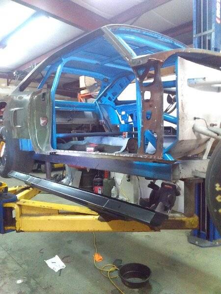

Some parts came in so I got driver side rocker and door hinge pillar in. Also started to make fender mounts.

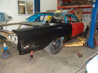

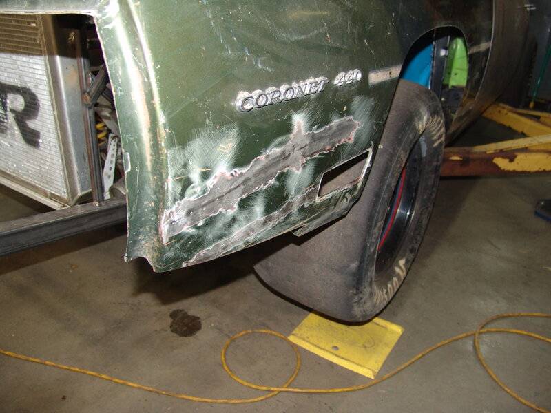

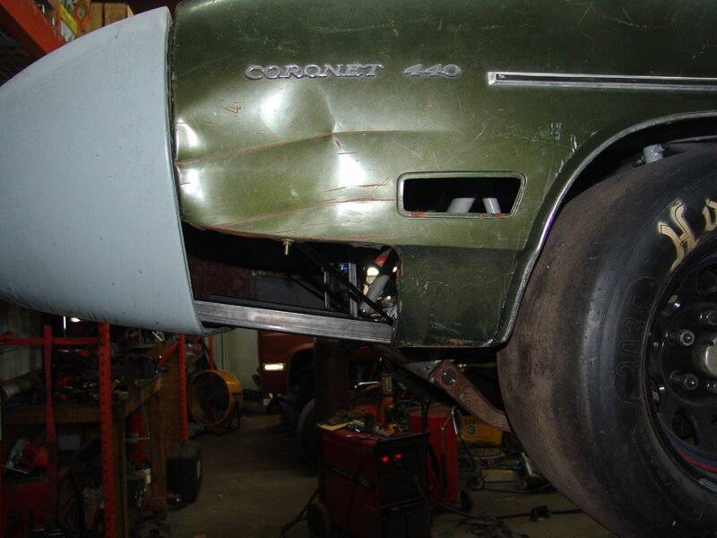

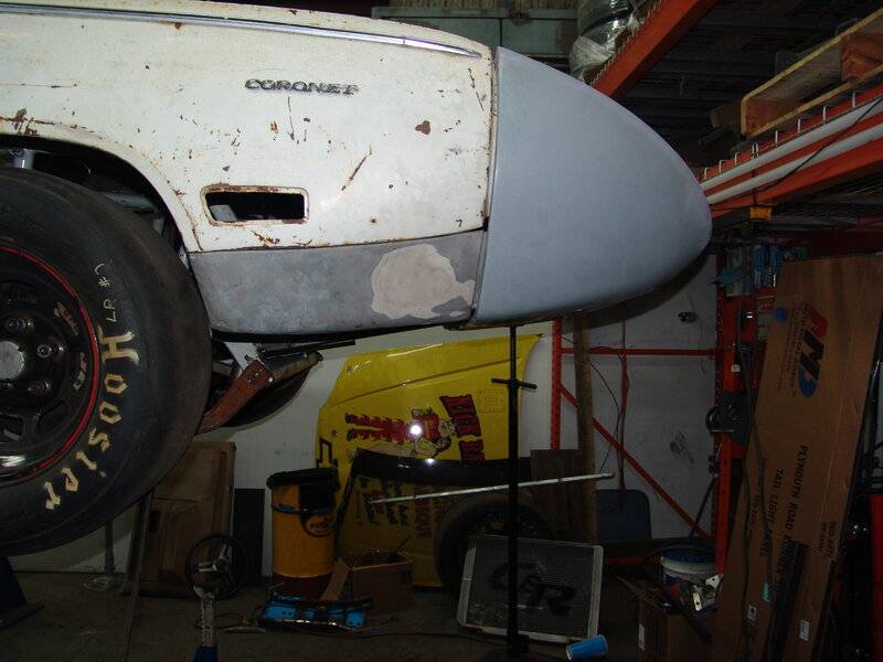

Got the headlight buckets in and working. Been patching up my junk fenders and starting to hang rear quarters.
DSC09148.JPG DSC09153.JPG DSC09154.JPG DSC09158.JPG DSC09173.JPG DSC09178.JPG DSC09163.JPG DSC09180.JPG DSC09181.JPG

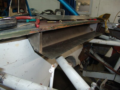

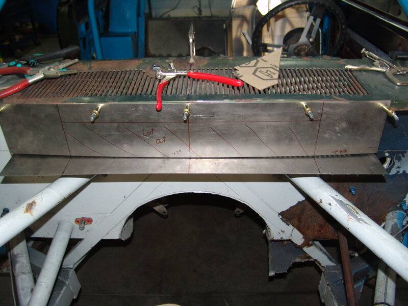

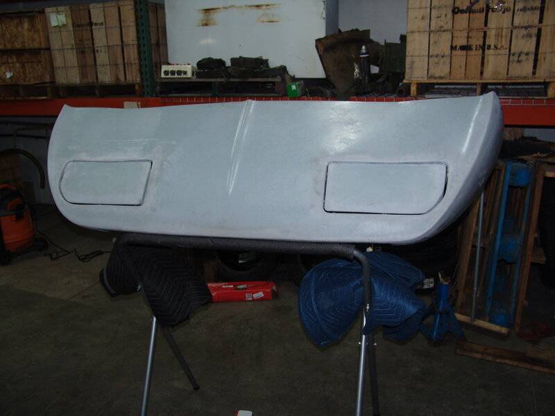

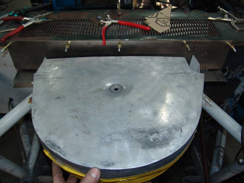

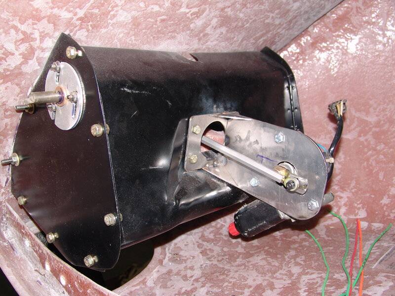

Started to make the cowl induction for the Nascar air cleaner.
