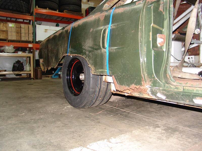

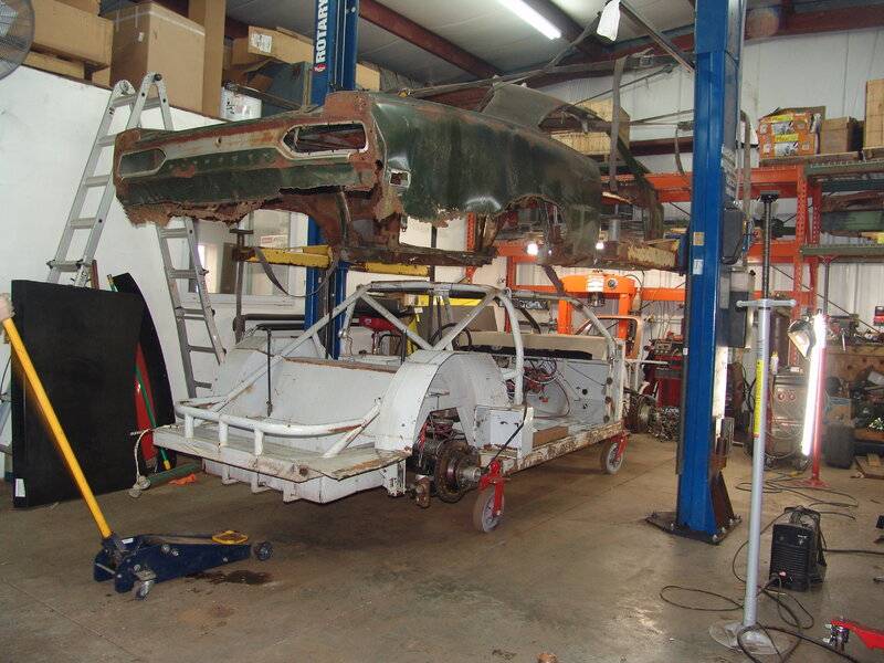

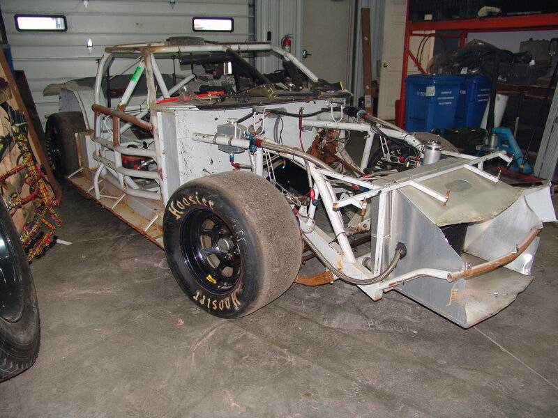

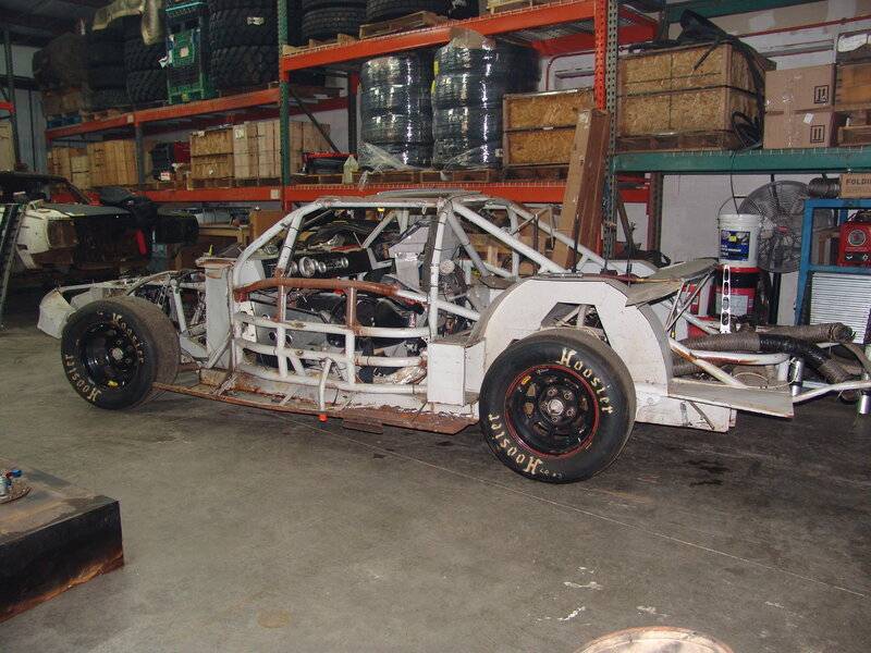

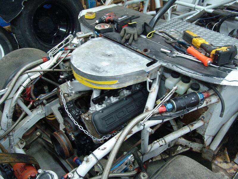

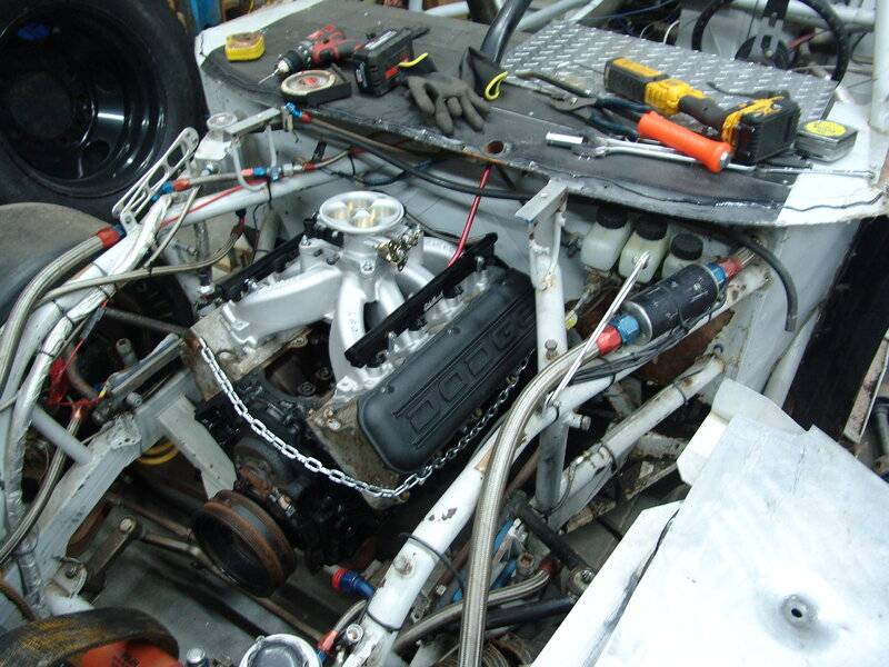

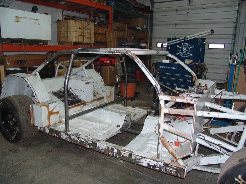

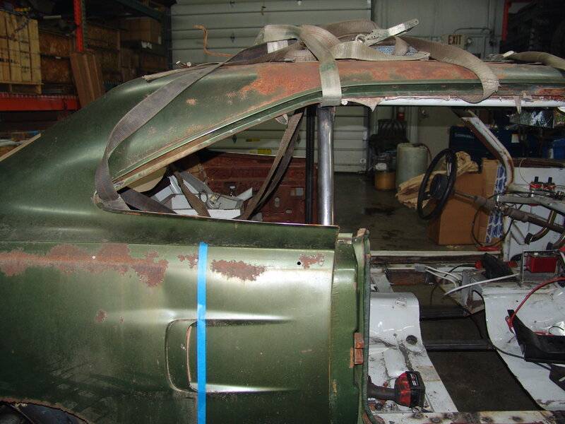

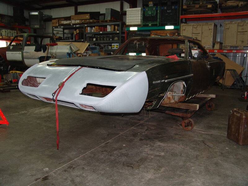

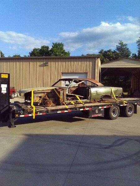

I'm finally getting ready to start my Superbird stock car project. I have been buying parts for the last year and can't wait to get started. The plan is to put the 70 Satellite body on the late model nascar chassis.

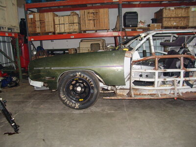

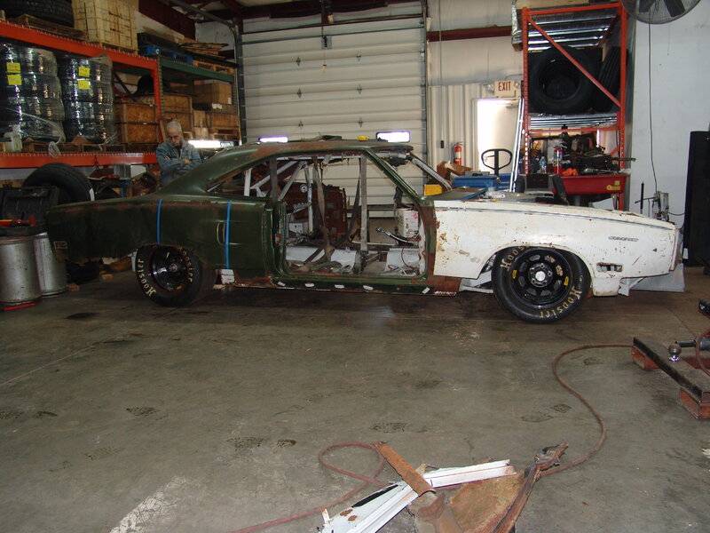

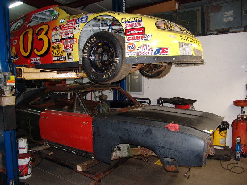

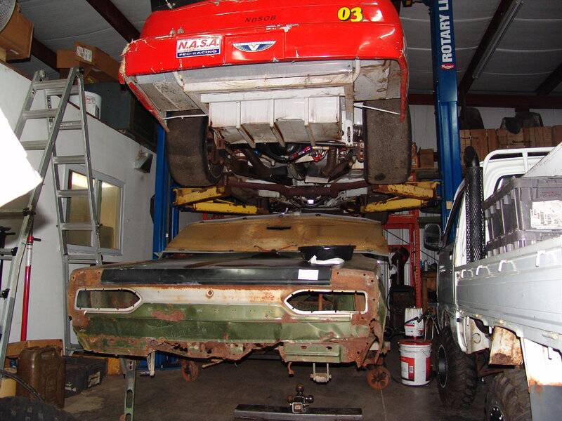

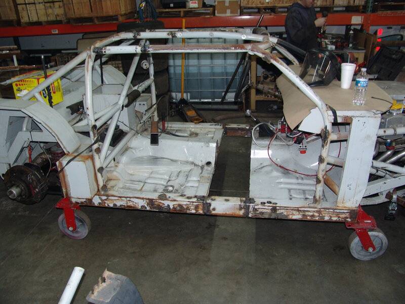

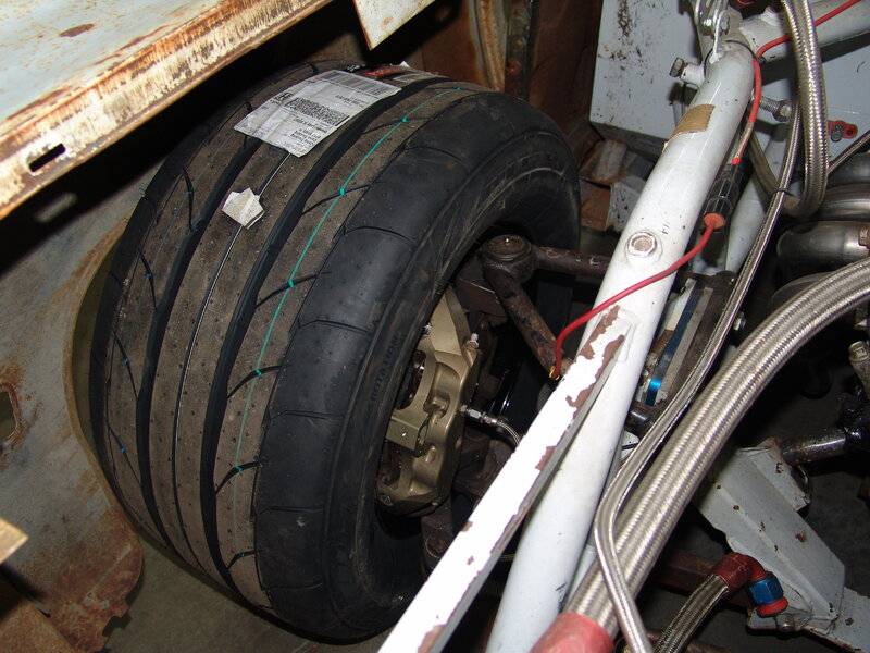

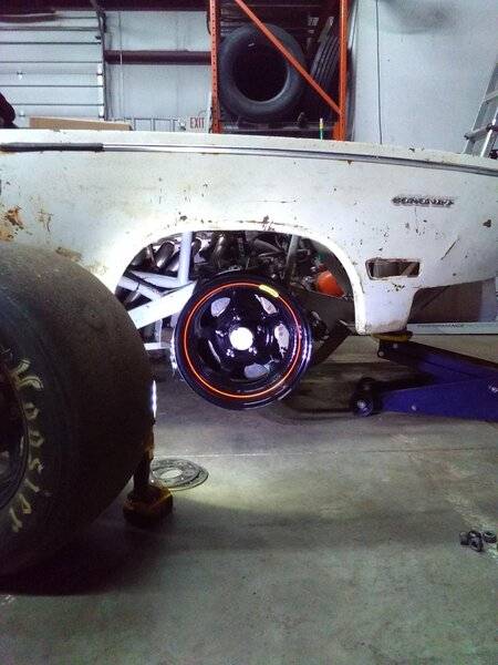

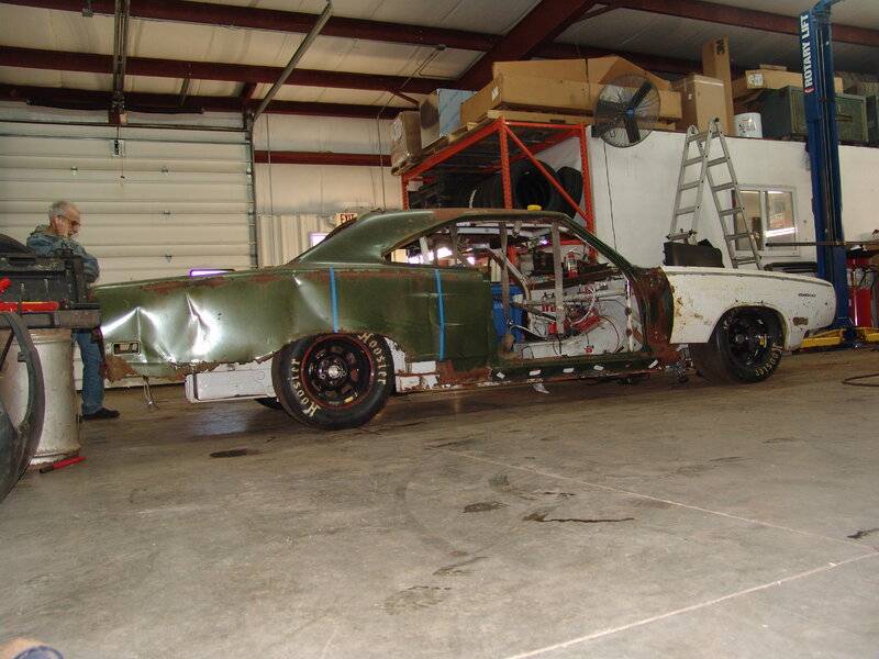

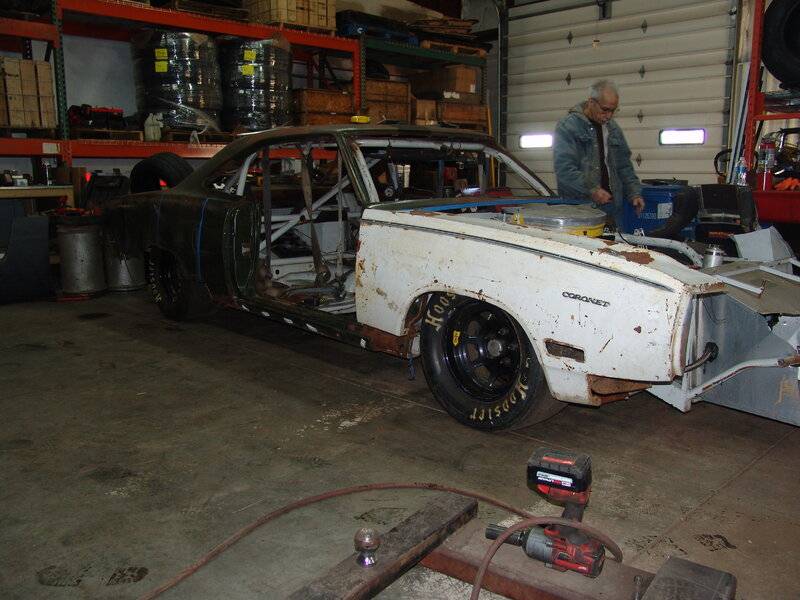

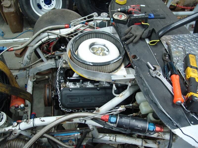

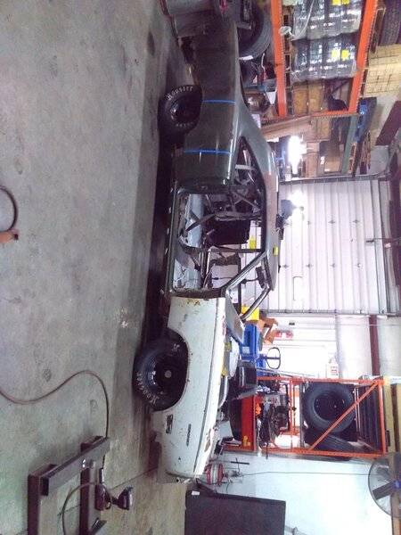

Removed the body off the Nascar today. Now need to remove bunch of tubes and dash.

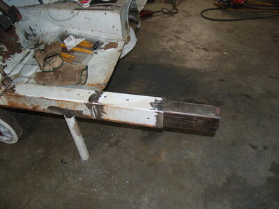

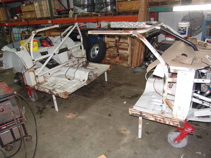

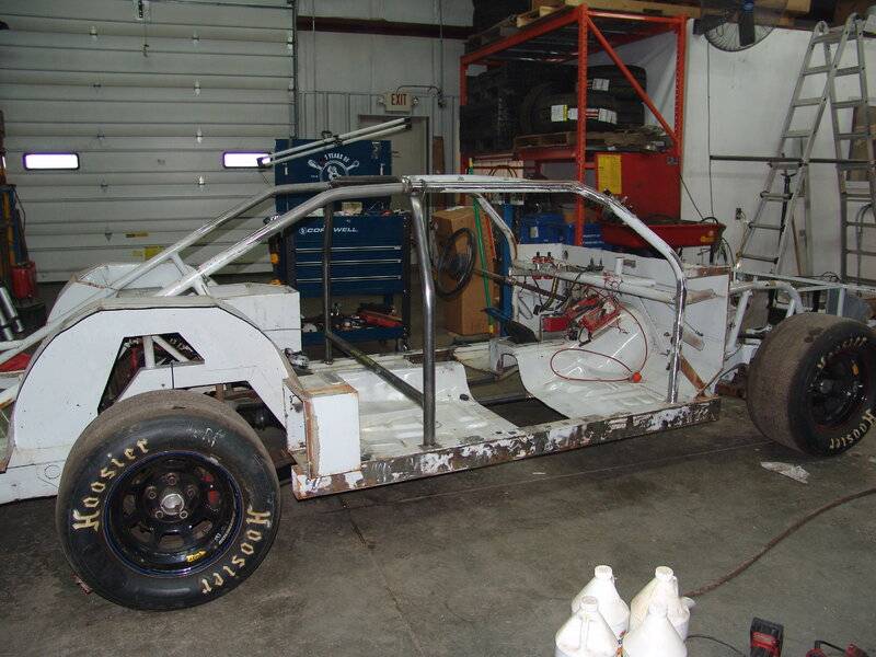

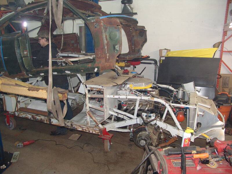

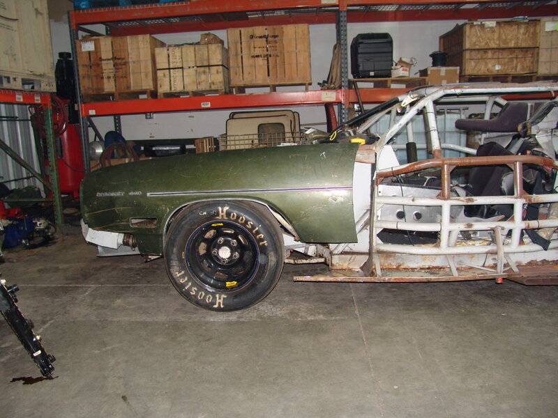

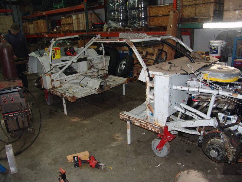

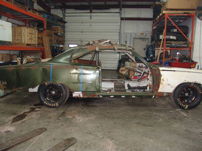

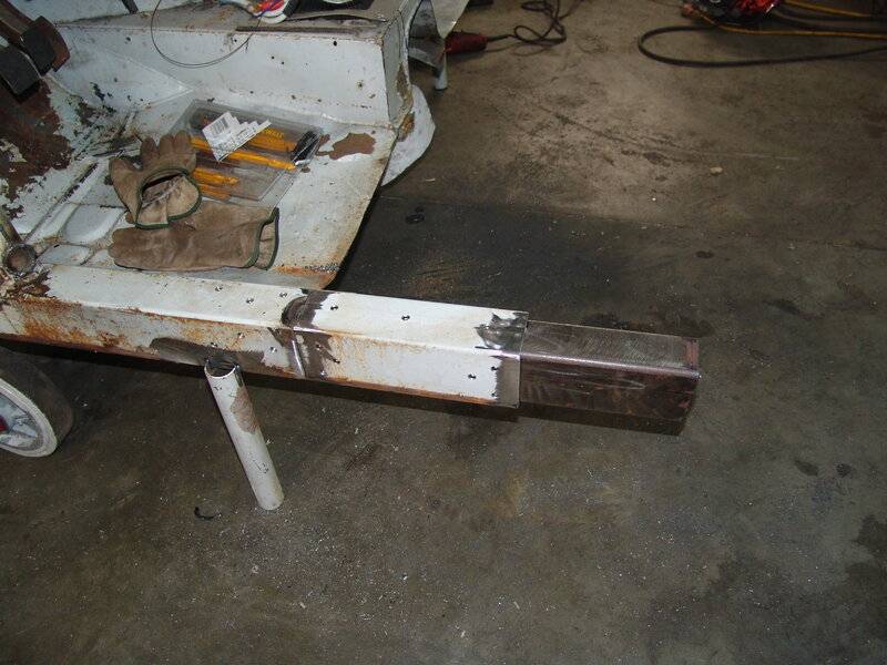

Needed to add 11" to the wheel base to match Superbird.
DSC08976.JPG DSC08977.JPG DSC08978.JPG DSC08983.JPG DSC08984.JPG DSC08987.JPG

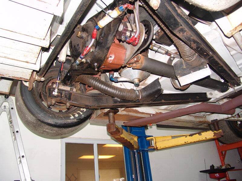

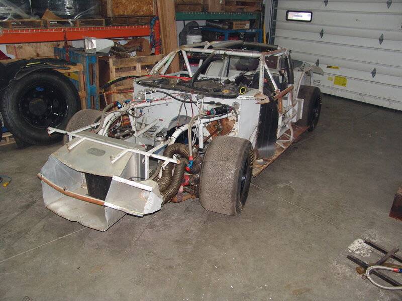

When they call them 'stock cars' its makes me laugh...
Diff pumps and trailing arms, very stock indeed...:lol:

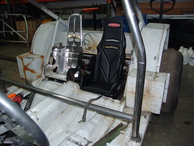

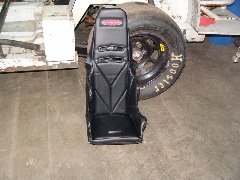

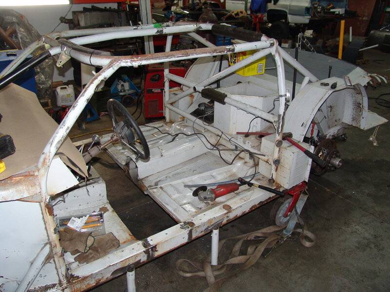

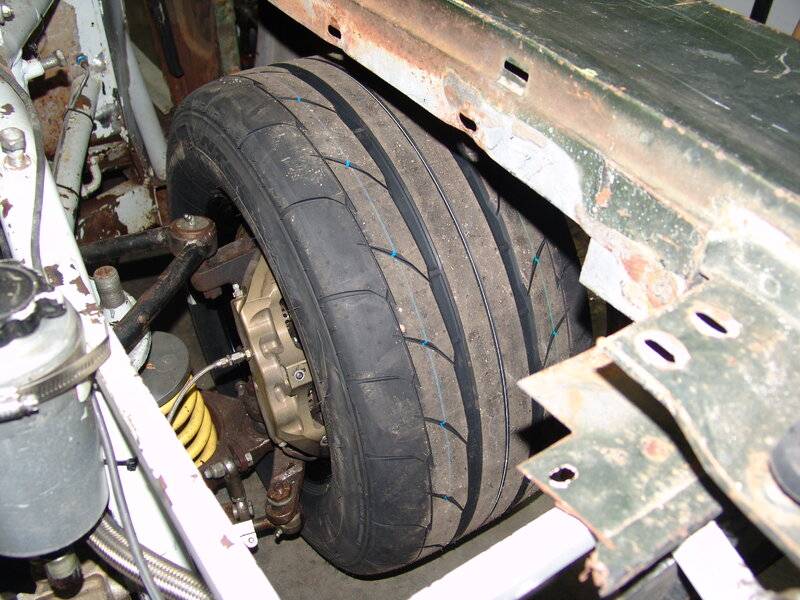

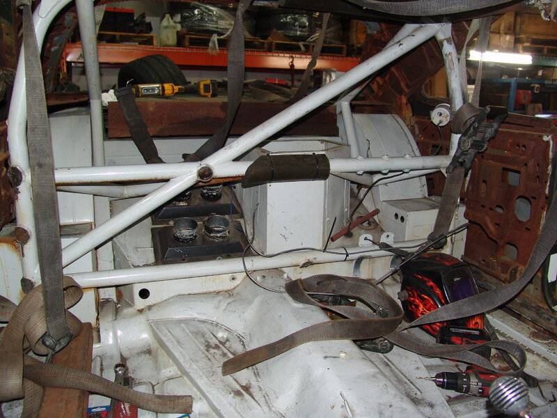

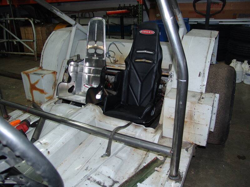

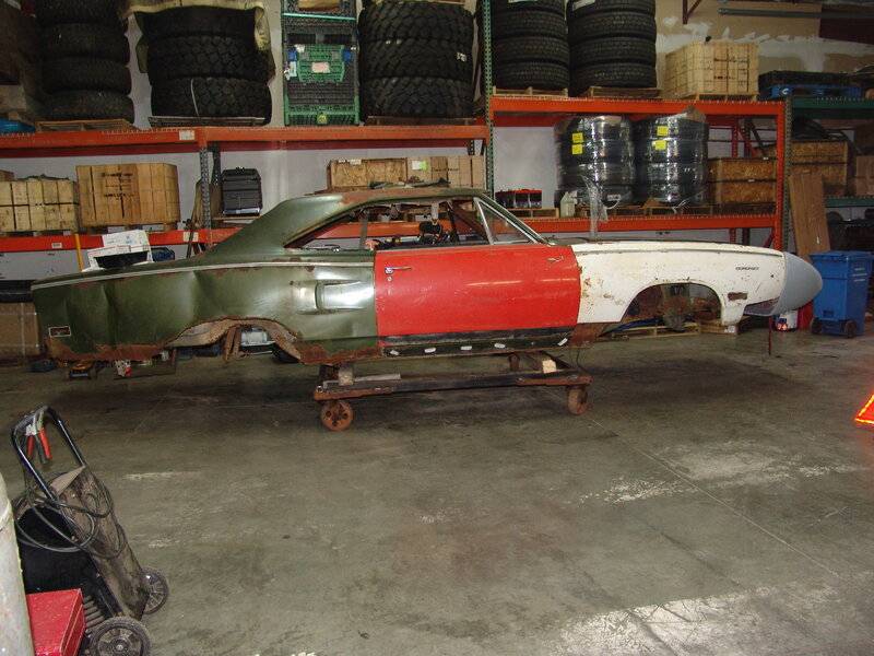

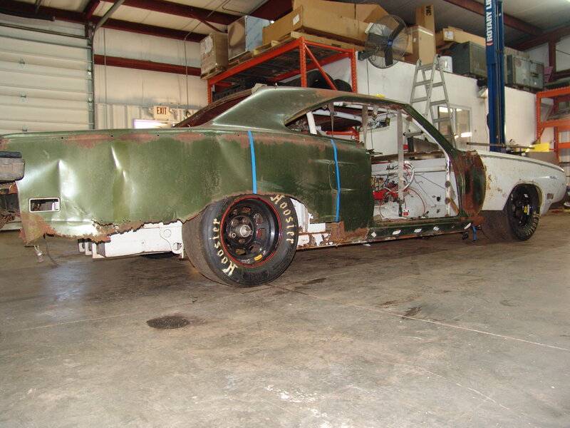

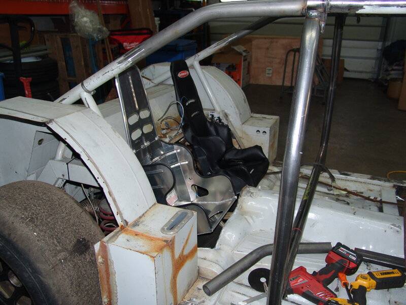

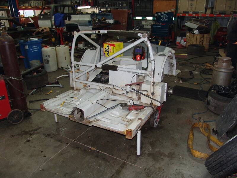

Needed to make room for the two kids racing seats in the back. Also didn't like where the rear hoop ended up. Looks much better now where it's at. Just need to cut out the rear floor and relocate coolers.
Needed to make room for the two kids racing seats in the back. I cut out the rear floor and still need to relocate coolers.

I give you credit for putting seats in the back for the Kids! My '72 Petty Charger is still on the rotisserie as an abolute shell! So you're a lot further along than me.Hopefully I will be retired within the next month and I can relly get moving!
The Kirkeys are nice but I just have a pair of black and blue Craigslist buckets for a $100.
