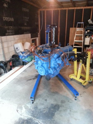

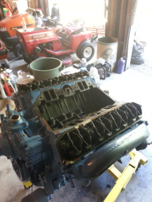

I have never done a project thread before so bare with me. It's not going to be a overnight build, so there will be a few months of posts. I will take and post pics along the the builds progression. So the foundation of the build is a 76 400 block ID# 4006530-400-10. I was told it's standard bore (hopefully it is). I'm looking to make in the 600hp range, 440 source 512 stroker kit, TF 240 heads, full roller, large capacity oil pan, edelbrock rpm intake, quickfuel or Holley xp 950 carb, msd distributer and can't totally decide on cam specs. Anyway I got it out of the truck tonight and on the stand. That was a tight fit lol. Next will be tare down, make sure it's standard bore, do a visual for cracks, then off to the machine shop to be magnaflux and go from there.

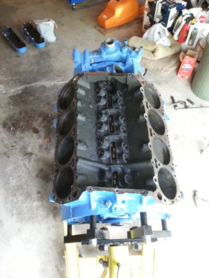

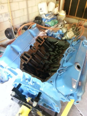

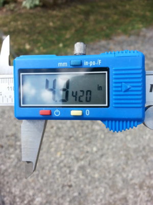

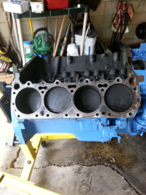

Well I started the disassembly today, got the intake, manifolds and heads off. It's looking good. I only had one head bolt give me some trouble coming out. I think a run through with a tap will clean it up. I took a quick measurement and looks like standard bore. It even looks like original head gaskets.
This isn't the right tool for the bore measurement but it's close.

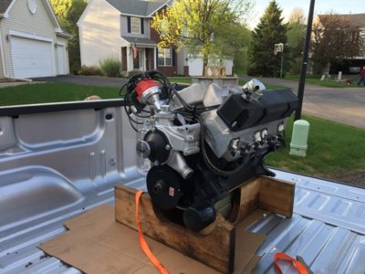

Like 66satellite47 mentioned the 512 are strong. Mine seems to like Flow. My 440 Source 512 low deck has the 270s. I have a Dyno video in a thread if you are interested to see them in action.
