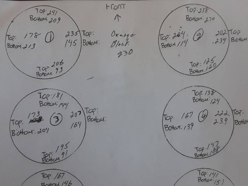

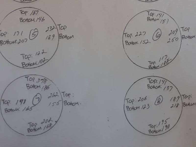

Nice, Kim. What type filler did you use in your block? Thinking about doing that to this 230 block, and going to .080 over. Here's the sonic test on it, at .060 over.
Hi Gary, don’t have that info as I bought my motor after it was inspected. It’s a 630 block. U have lots of of meat there to bore ur motor if u can get pistons. Kim
So I could go .080 over, without needing to do any block fill? I can get ICON or Diamond to do a custom set for a few extra $$$.
Well, decided to go with the .040 over block, and take it to .060 OS. But at 4.400 bore size, Total Seal only has 2 ring sets that have a gap. Plus not file to fit, and oil ring tension is 23 lbs! So not sure what way to go with the rings yet.
