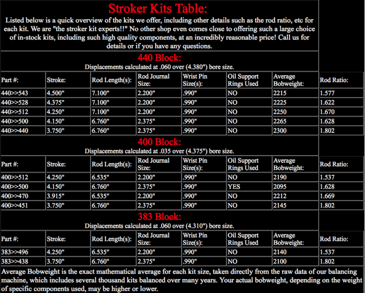

Have you found this chart yet?
Bob weight for the crankshaft must be balanced with the bobweight of the piston, rod and rings. The number they show is for the overall assembly i believe. Lots of technicals. Have to remove weight from crankshaft to balance with others. The difference between is what matters. Like within 4 grams of each other for Nascar.
Is why some factory motors run strong and some don't IMO. I'm sure the 512 will buckle some pavement. Torque monster.
Some shops can balance the assy. with the flywheel/pressure plate and the balancer/pulley together. I like that idea.
