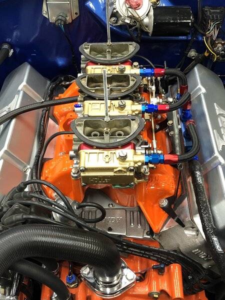

You won’t regret either as a stroker. I run a 400/512 in my car with a six pack. No matter what you choose it needs some good flowing heads.

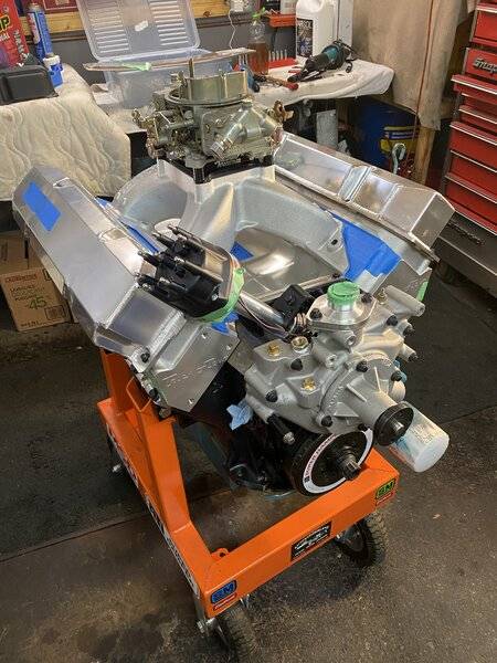

I’m currently finishing up a 400 stroker engine (470ci). Using TF240 heads and a single plane TF intake well over 600hp shouldn’t be a problem for you with a 470 or 512 stroker build. It’s not cheap to build but that power is doable. If I were you I’d take the 440, do a 500ci stroker and use the 6 pack set up because it’s cool. Yes a big single carb will make more but a 6 pack is just cool.
you’d be surprised how well the six pack holds its own. I’ve ran a bunch of different combos on my car. The six pack ran identical to a ported TM6 and a 1050/4150. The time slips were identical. The only combo I would say was stronger was an mw ported Indy single plane and a 1050 dominator.
