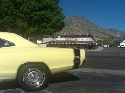

295 50 15 rear tires on an 8 inch wheel bought mounted from Summit. It only rubs at Willow Springs under extreme conditions. Coronet gets squirrely at about 140 ish mph due to aerodynamics so the Coopers are adequate.They look bitchin but spin on demand as if they were 2 inches wide.
