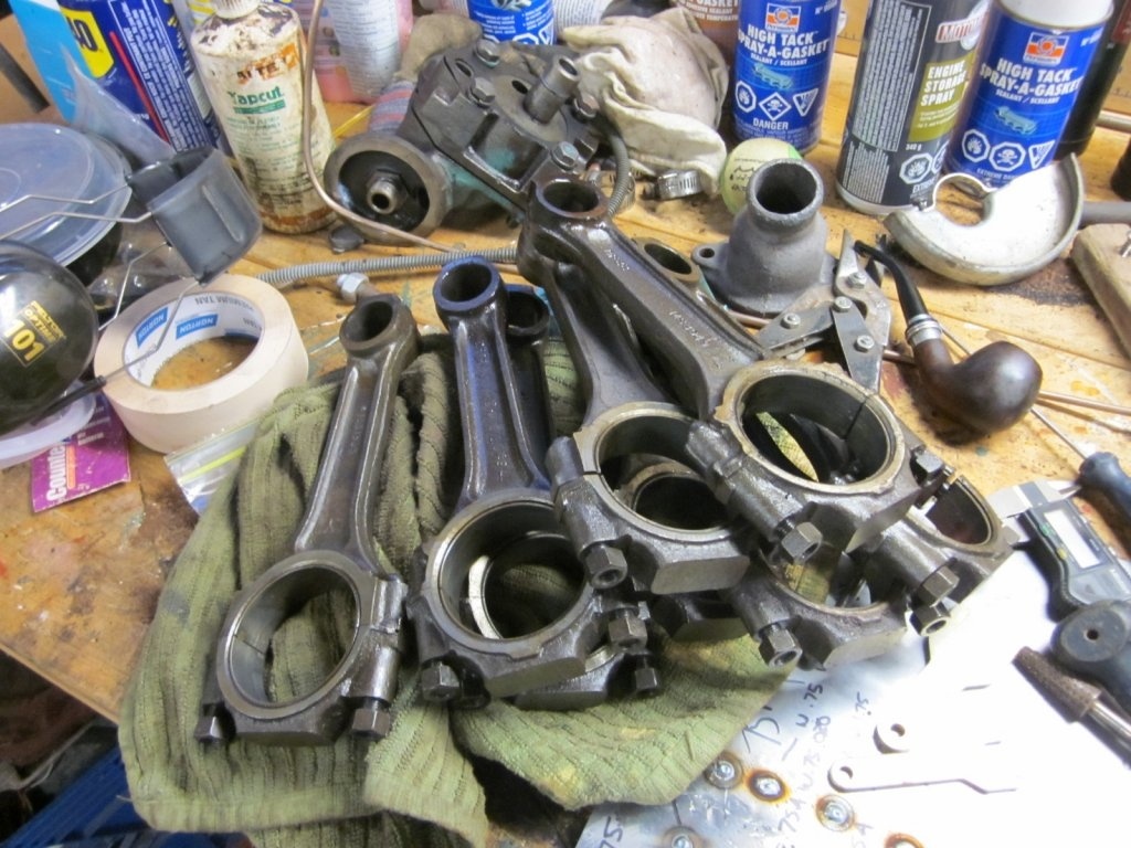

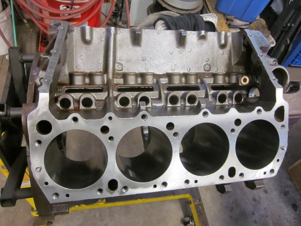

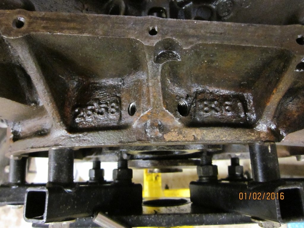

This is a 1973 413, likely from a RV as it has extra water passages. First I stripped the block which had deep dish pistons, a forged crank and LY rods.

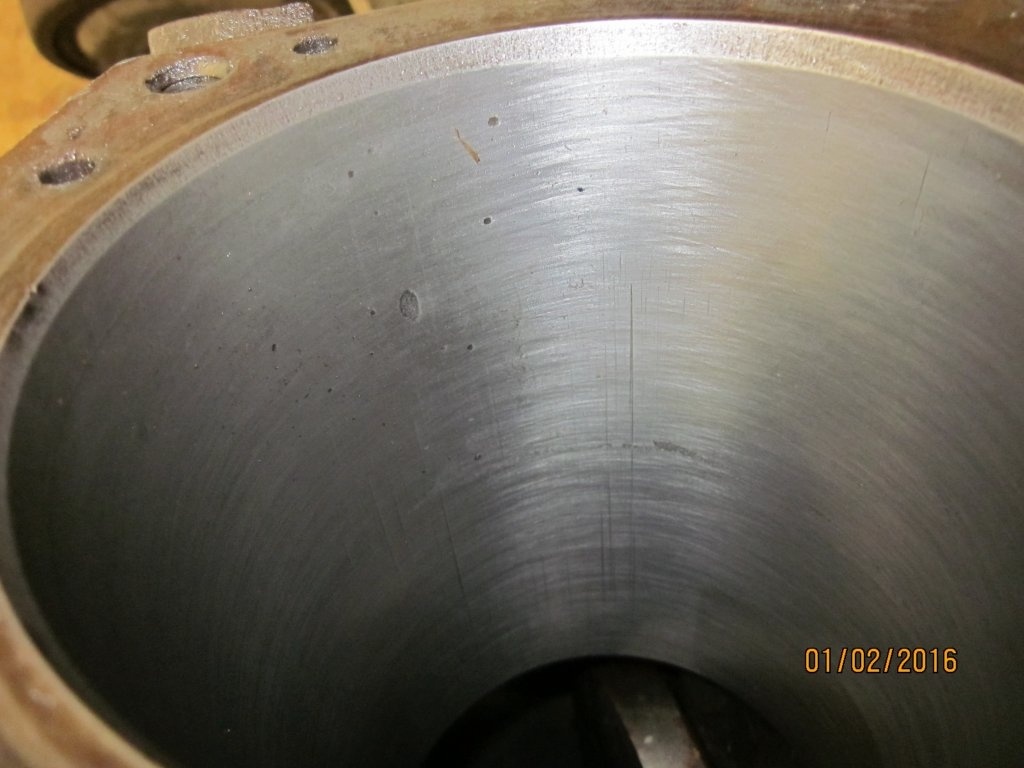

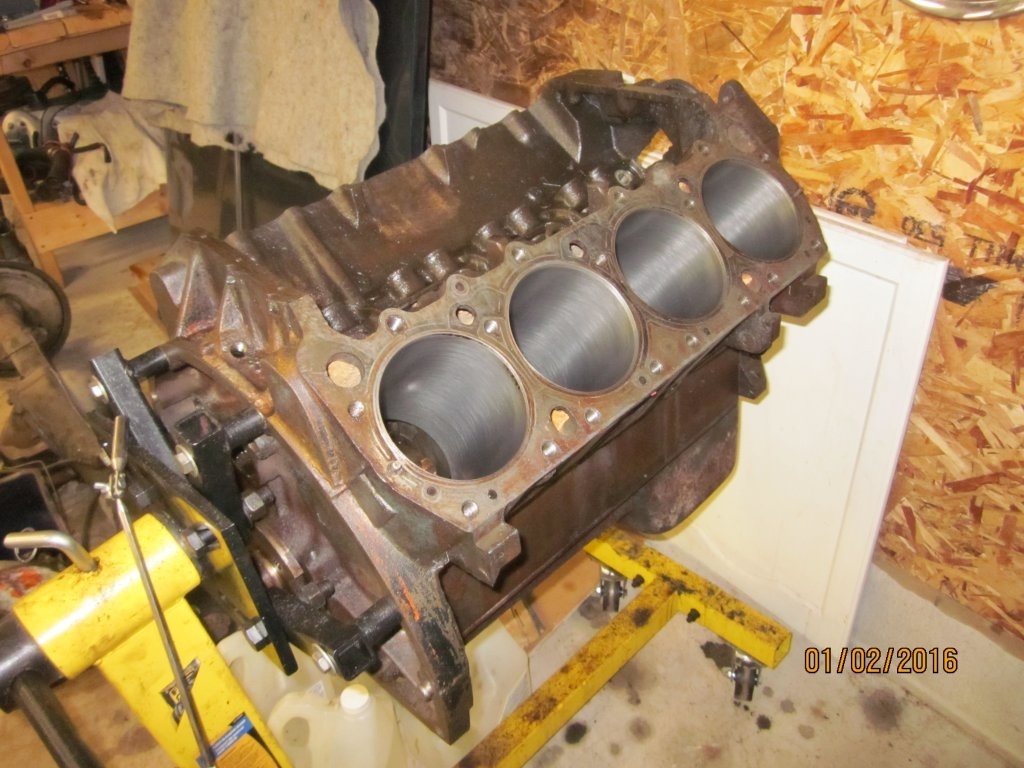

The cylinders looked to be in relatively good shape and the hash marks were still visible, with no edge to ream at the top. This tells me it probably had low miles on it.

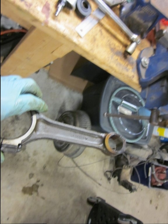

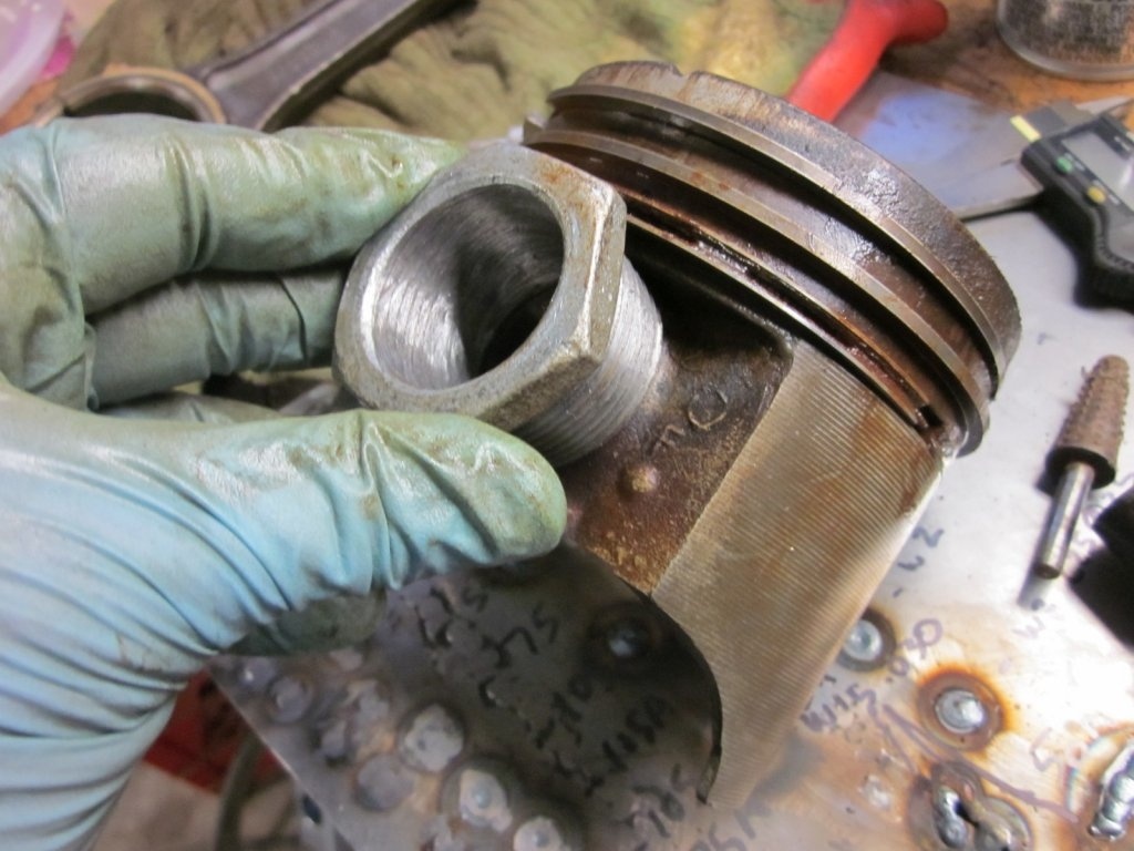

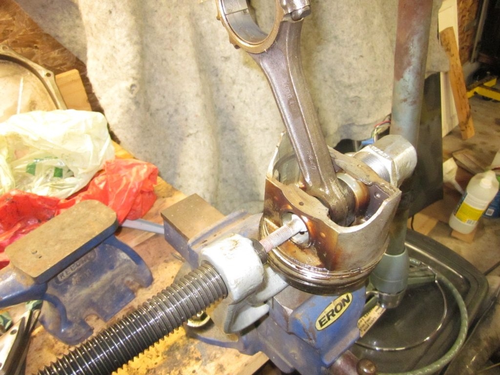

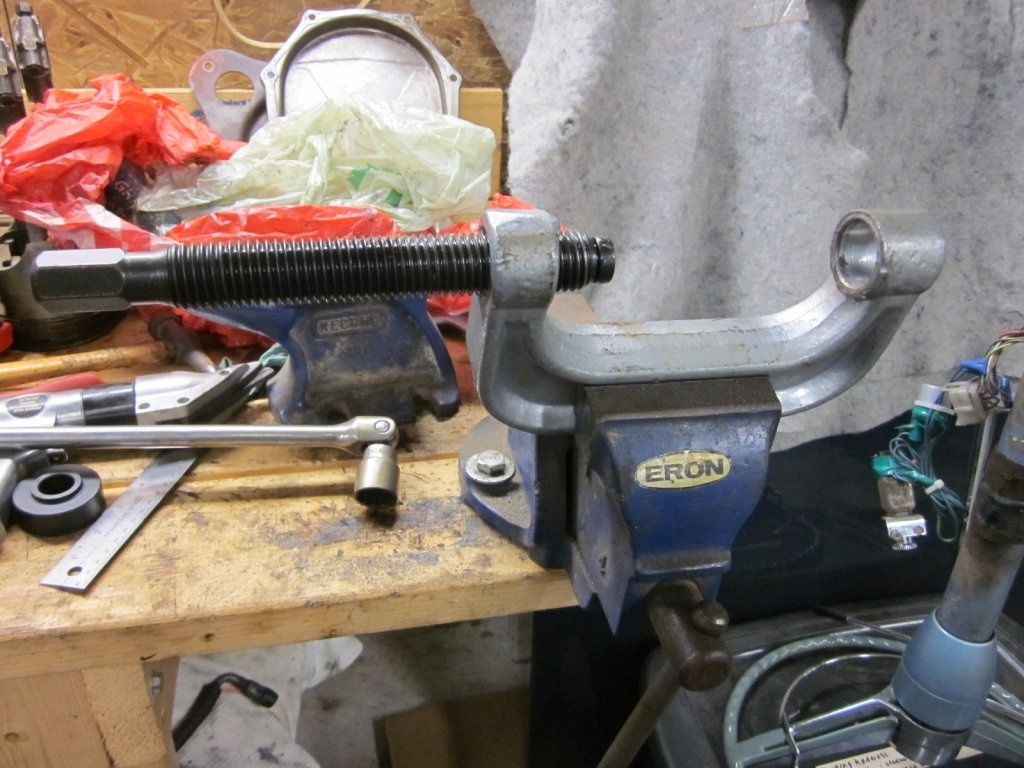

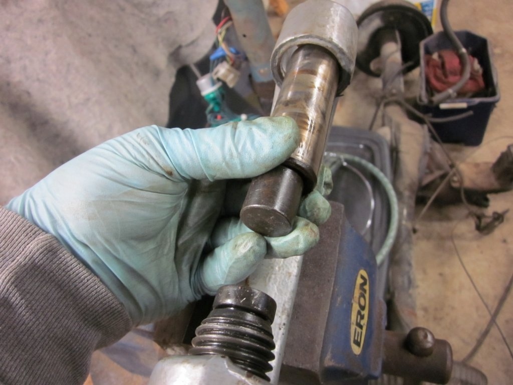

The wrist pins were pressed out with a ball joint press as I hadn't bought a hydraulic press yet. (I found a used 20Ton cheap recently).

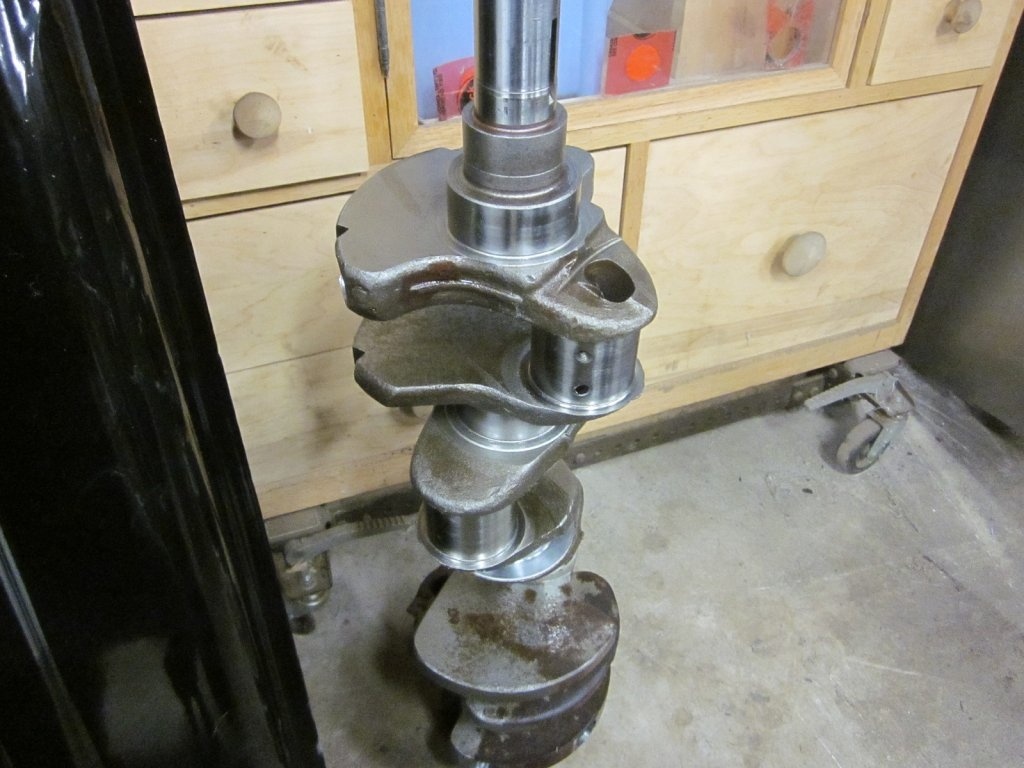

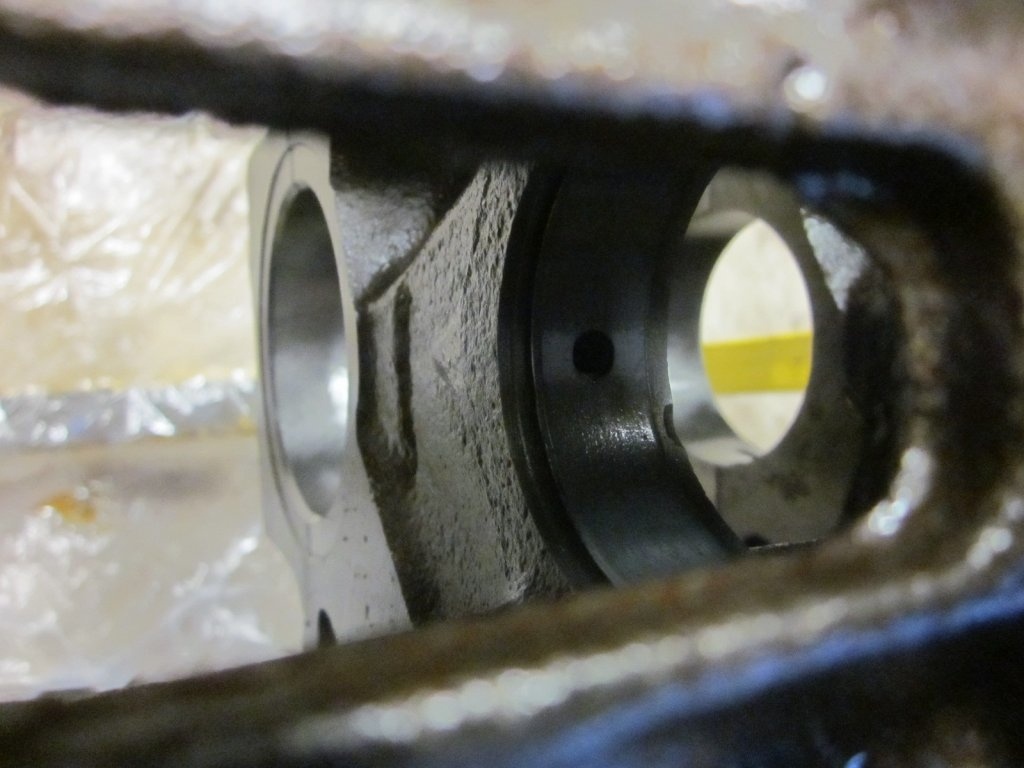

The rods journals were measured and found to be in good shape.

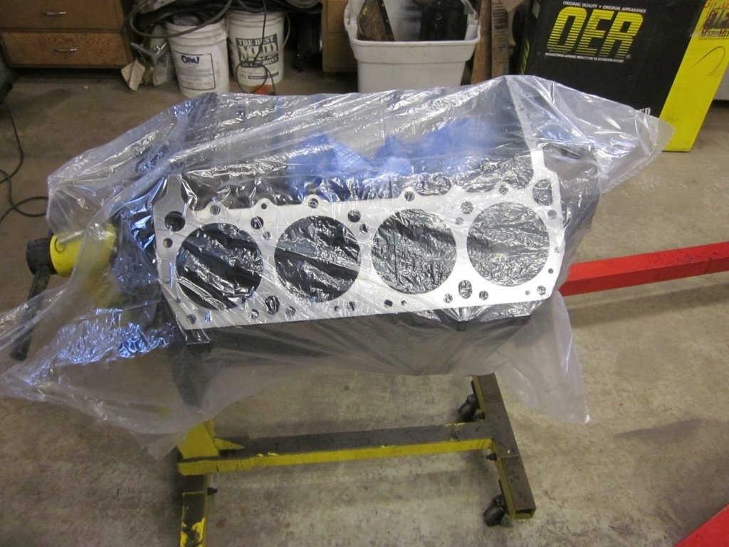

The block was sent to For Hemis Only which is 25 minutes from me. A quick sonic check revealed thick cylinder walls leaving lots of safe room to bore out. To be sure though, Tim wanted to have the inside of the block blasted as rust can throw the readings off.
The block was blasted and rechecked for thickness and cracks. All is good! Time said this block was in exception condition and we could get away with just honing the cylinders.

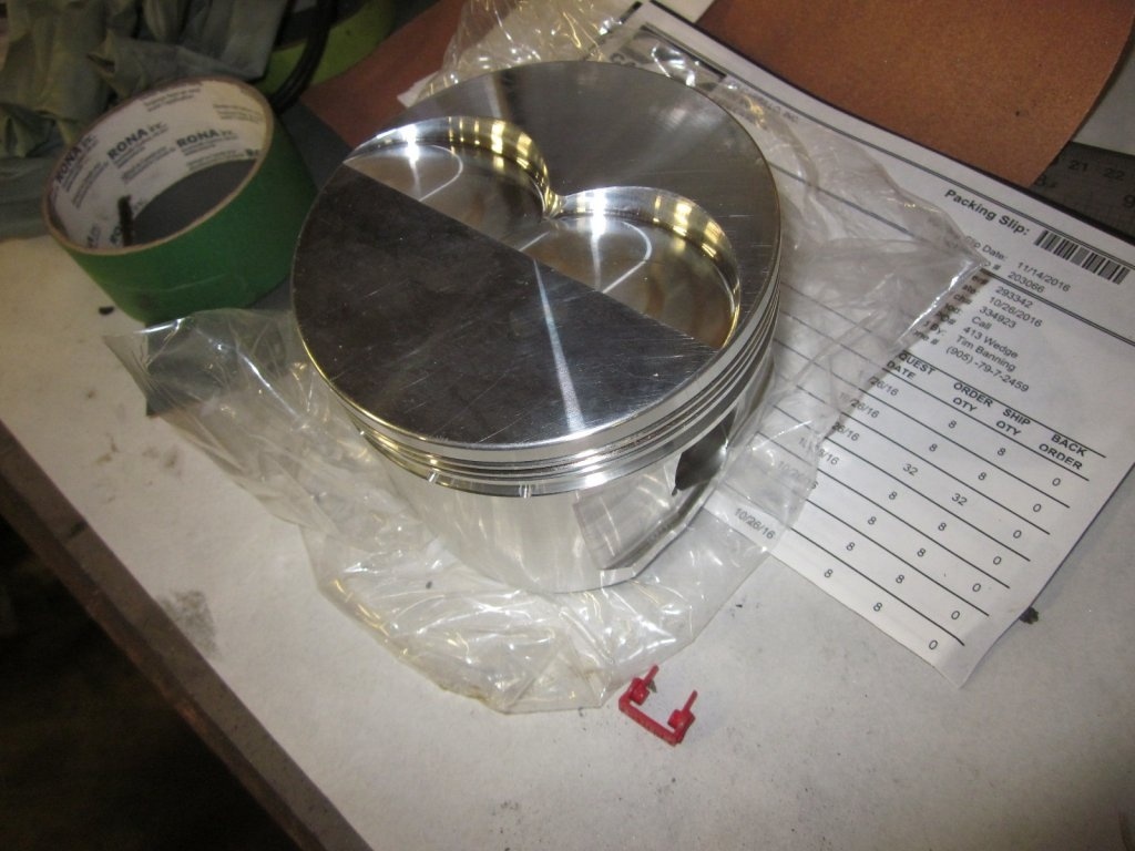

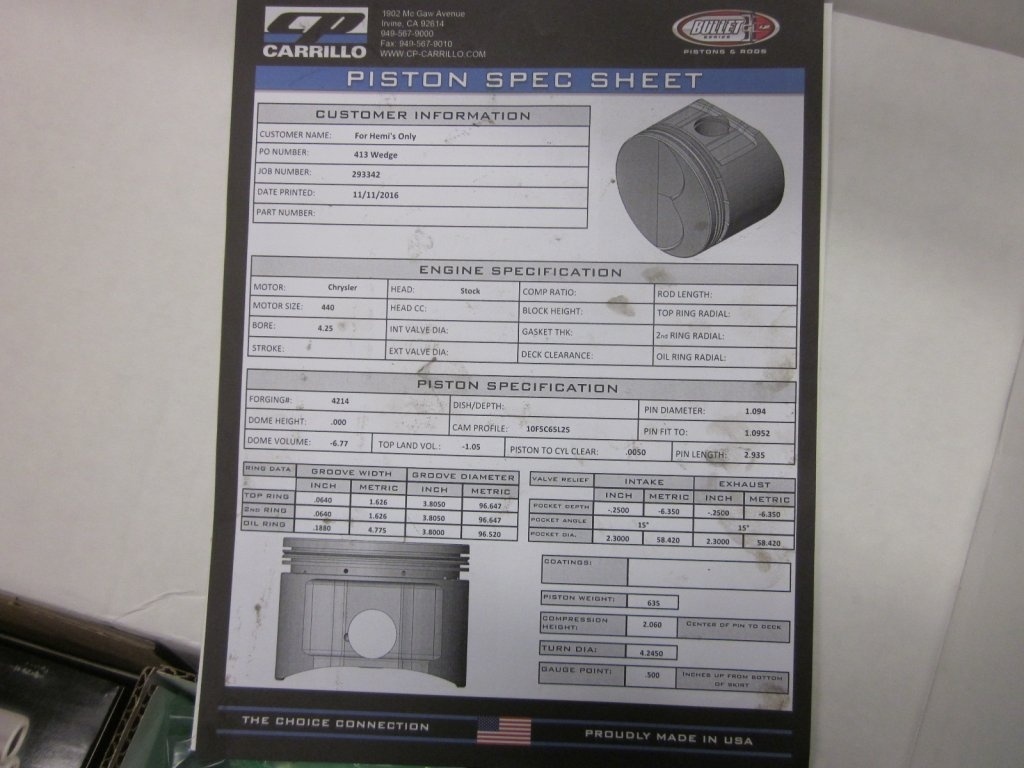

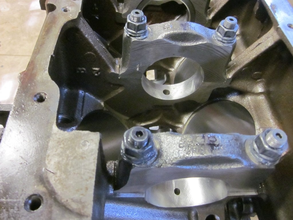

Since custom pistons would likely be necessary, we decided to bore it out to 4.25 (426 spec) with lots of room to spare and align hone the main journals.

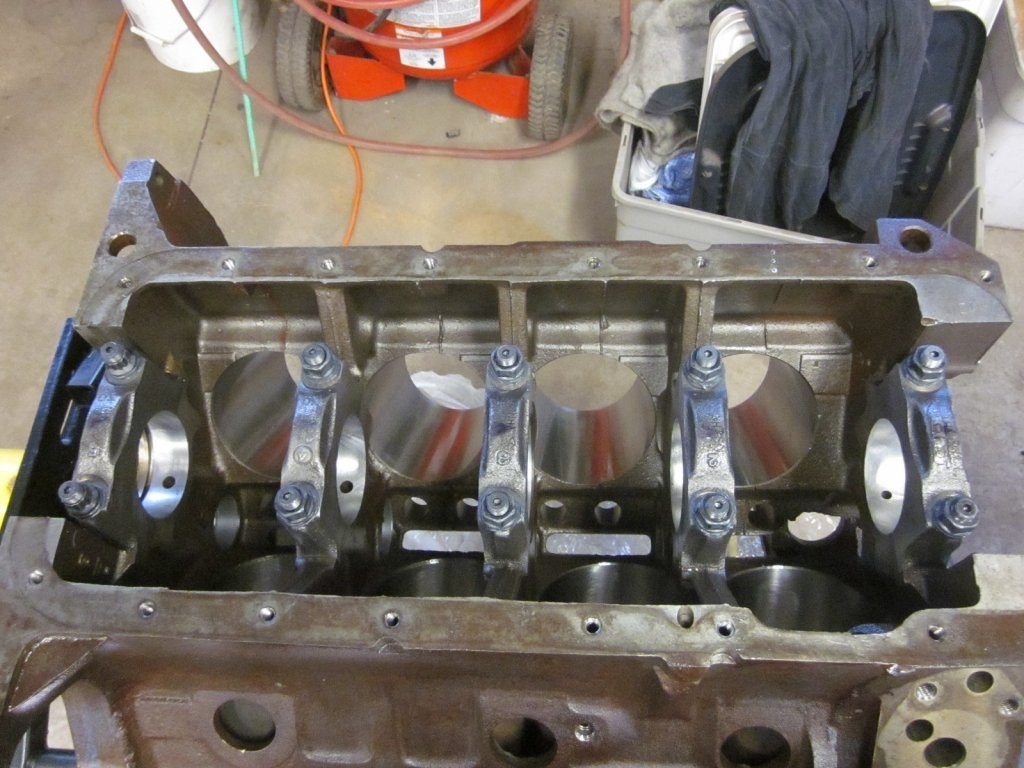

ARP main studs were installed and the block was decked lightly to true it up. Tim said the top hardly needed machining. With everything squared up and straight, pistons were ordered.

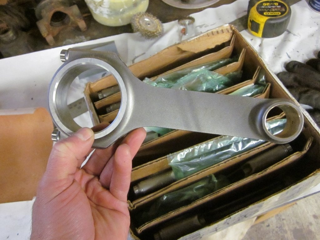

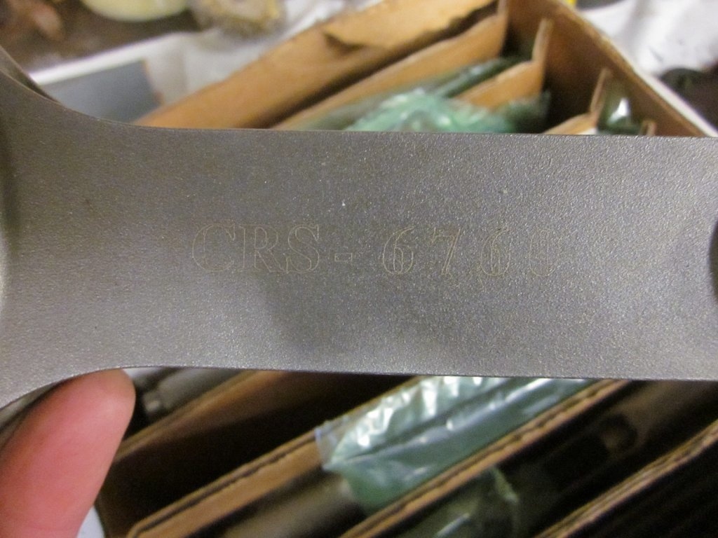

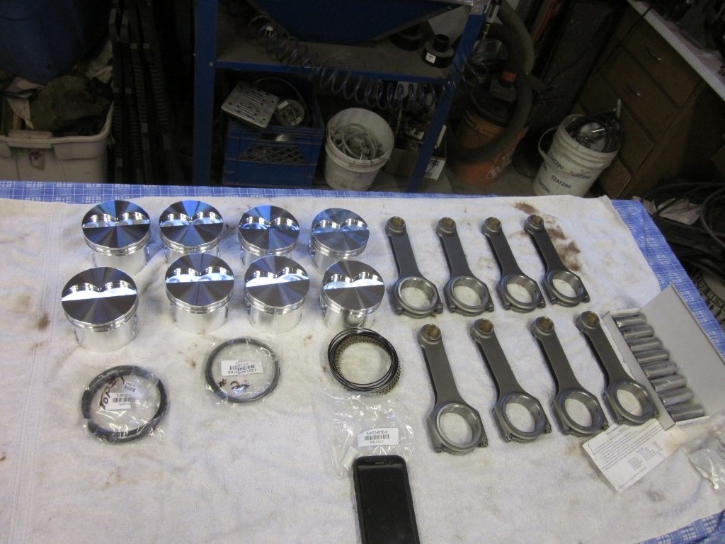

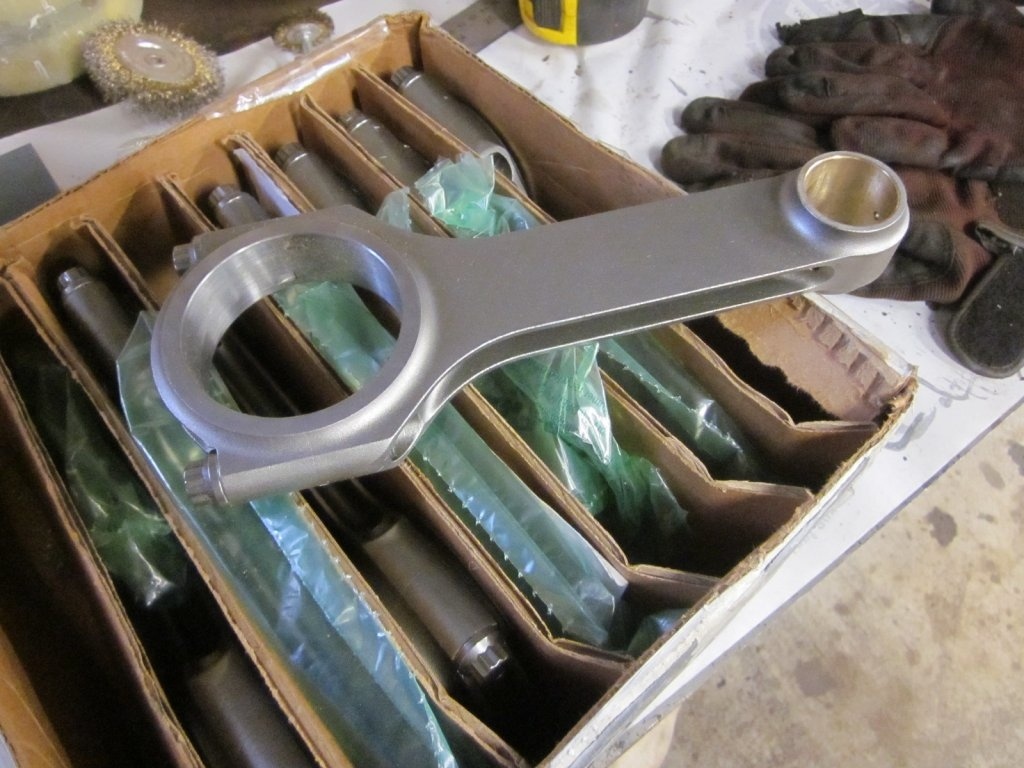

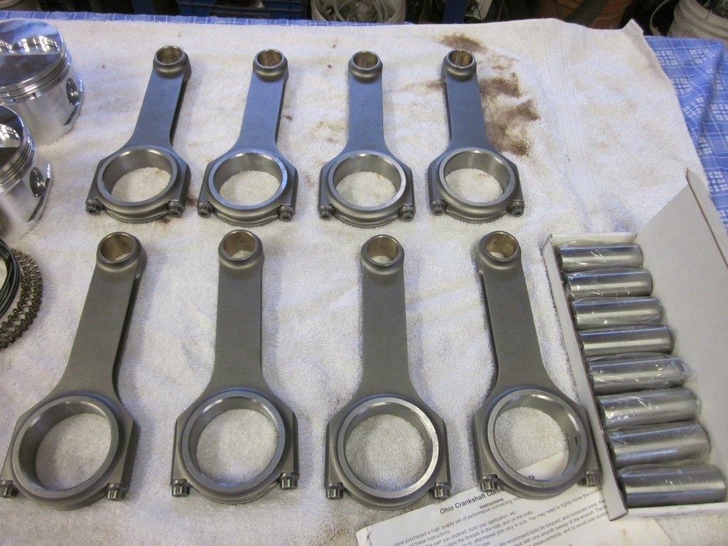

Tim is not a fan of old technology with regards to rods & pistons. He had a set of new Eagle H-beam rods with floating pins and offered them for not much more than the cost of resizing the LY rods and ARP bolts installed, so i bought them and sold the LYs.

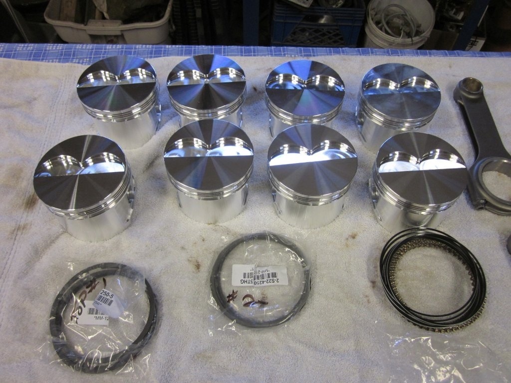

Gapping your rings...suggest dry fit in sets, for each cylinder, by hand. Then, keep the set together, to only go into that hole. That way, you will know exactly what you have. When you cut the rings for gap, be sure to check each end, for any burrs, and dress them with a small fine file.

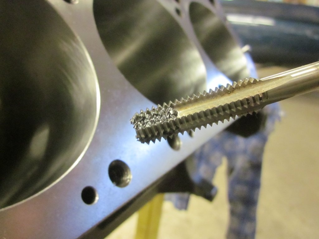

Your tapping all the bolt holes. Be sure not to 'cut' any metal. All you want is to clear out the carbon. Rust on/in the block. If there is any, I have used rotary brushes, most times going over all the cast surfaces, inside and out, until I get bare metal. But, I AM extreme.
Just a thought on those pistons, since they use bolts, instead of bolts and nuts. Might take a scrap bolt, cut the head off, and cut a screwdriver slot into that end. I simply use the end of the 'upper' bolt, and slip a length of rubber hose over it. With the cut-off bolt, same thing can be done. When you install the piston/rod into each hole, the rubber hose will help guide that end of the rod over the crank journal. Want to not nick the journal, and the hose gives the 'helper' you'll need, to guide the rod end into place.
Then, simply matter to remove the bolt/hose, and put the cap on.
Thanks for the tips Miller! I hadn't thought about the rods having bolts instead of studs...good idea about using a couple of studs with hose.

I laid everything out. There isn't any info to tell which are the top rings & 2nd rings, so a quick search on google tells me the part numbers starting with #1 is the top ring and #2 is the second. The oil rings are obvious, even to me!

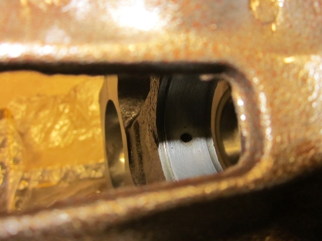

Using a gun cleaning kit and a pipe cleaner, I checked all of the oil passages. i found one cam bearing installed by FHO to be misaligned slightly, but after lots of reading last night, it doesn't seem like a big deal.

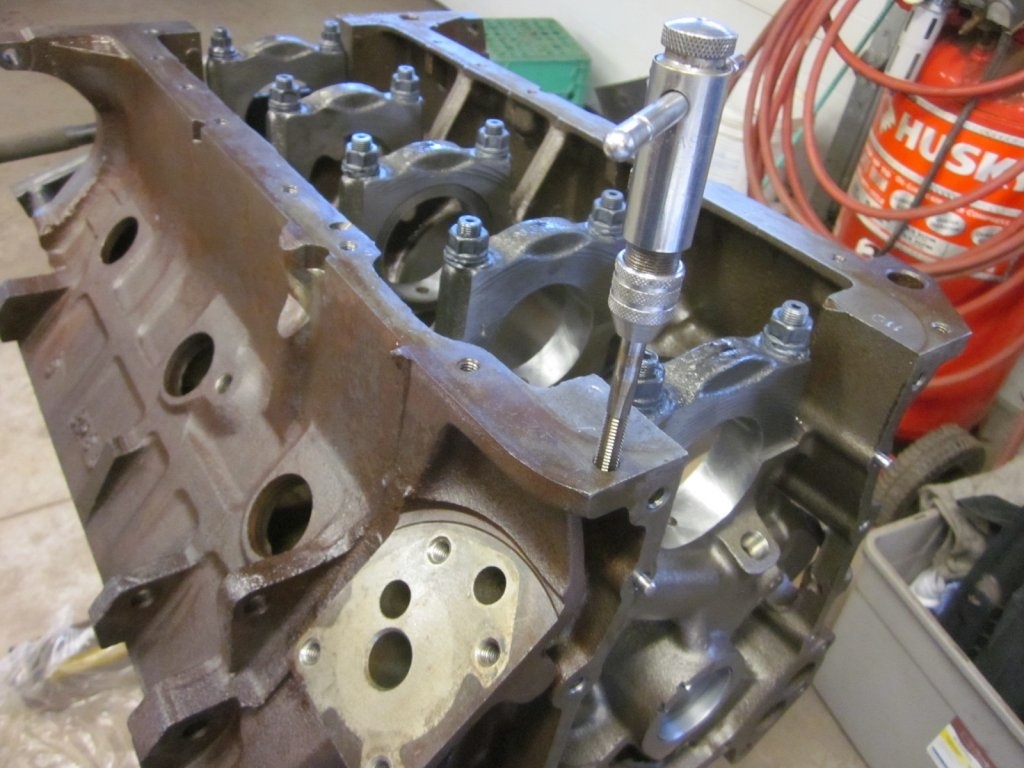

Before I sent the block out last year, I chased all of the threads with bottoming taps. Doing it again was a good idea and there were a few that would only thread 3/4 of the way easily. I was careful not to cut the threads. All threaded holes were done. The rear seal cap holes were a bit tough to get at since they are so close to the #5 main cap. I used an 8-point socket & extension to turn those.
Crud in one of the head bolt holes. It took a little more effort to clean a few like this out but it wasn't excessive like cutting metal threads.
Once done, I blew out the holes with air and a spritz of WD40. The dinner bell rang so that was all for yesterday.
