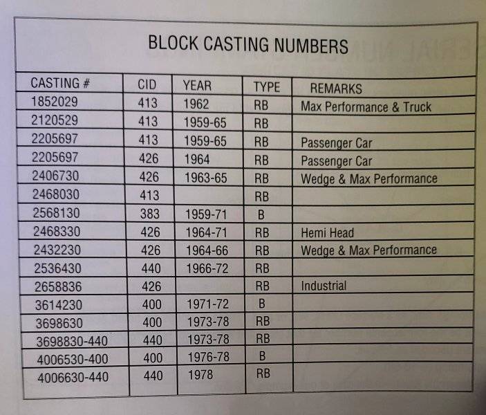

There were a variety of blocks used for 413 and 426 wedge engines. They include but are not limited to castings 1852029, 2120529, 2205697, 2468030, 2658836. Most 413 blocks can be bored to 426 standard (0.060" over), but not necessarily to 426 os bores.
In any case, affordable piston choices are few for 413 and 426s. It is easier to build a 440 based engine because piston availability unless you are building a high budget motor.

From Don Taylor "Big-Block Mopar Engines"

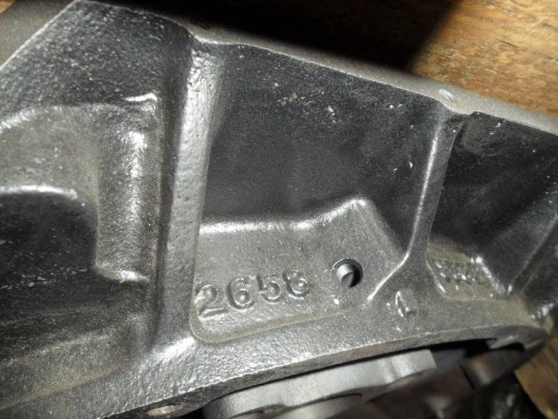

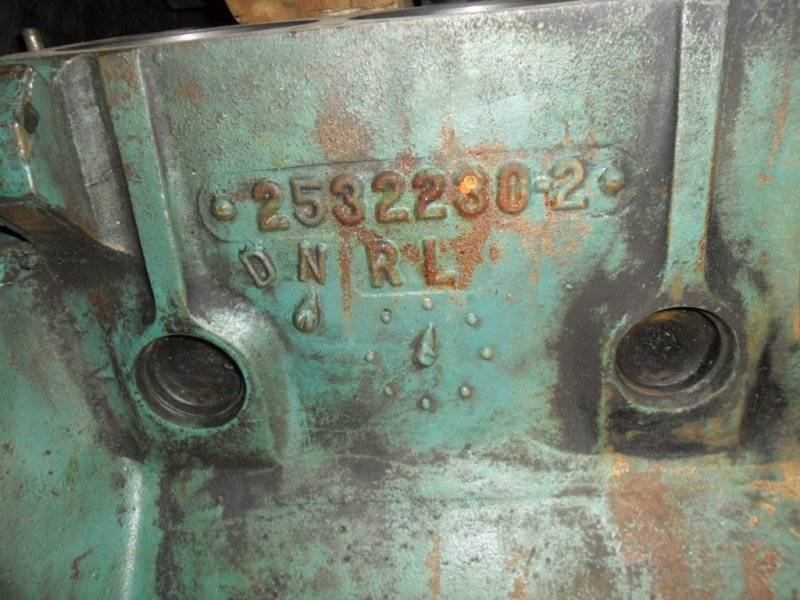

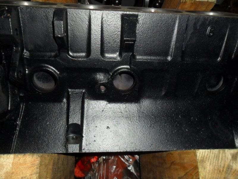

This was in my 365hp 426w '65 Belv I bought used in the '70s, my first Mopar. Original low mile car when I bought it.
This one is the "heaviest" 426w in all ways, sonic says it will go to 440 os and weighs 35lbs more than any RB I've weighed, yes I used to weigh blocks back when I was seriously racing. This one is different the the other cold weather/truck blocks I've had. Came in a mid '60s race boat. Note that there is no side numbers and the numbers are on the BH area. In any case, as I said here are some of the casting numbers.
