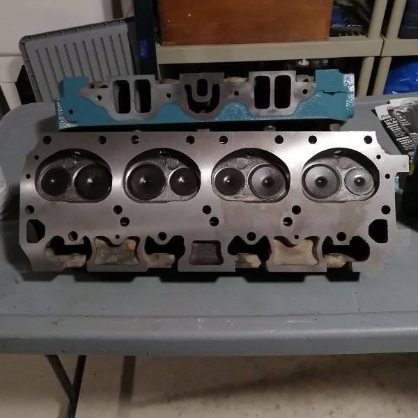

For what it's worth, my 516 heads measured 77 cc's after a .020 clean up cut.
