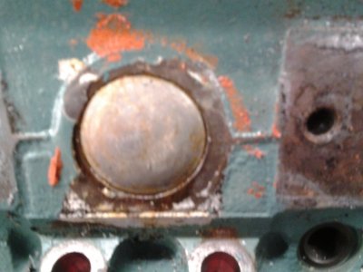

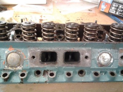

Just had to remove the cylinder heads from my 62 Dart because the "freeze" plugs are leaking. The guy that did my heads used the flat type of plugs. I have never seen freeze plugs like them. I checked a couple of other heads I have laying around and they are all the cup type. Anybody know if these are the correct freeze plugs for casting number 2206324? See the pictures

Im no builder by any stretch, but it looks like they are installed backwards...???...
Never seen that, im no builder either I agree with mike they look to be installed backwards
They definitely look backwards.
You could use a sliding hammer, drill a hole in them the right size for the screw and remove them that way.
You might be able to tap one side so they spin in the hole, then grab or pry them out.
Being installed backwards might be the reason they leaked. Also shows the builders expertise.
I would think that you could have replaced them without removing the heads...
If the guy that put those freeze plugs in, is the same guy that rebuilt your heads and he didn't have a stroke in the middle of it, run away
You kids just haven't been around long enough ..LOL The early freeze plugs were a domed disc that butted up against a lip on the inside of the hole. You punched them in the middle of the dome to expand- tighten them up. Not the best ideah, I have blown them out before on my 354 Hemi...............................MO
Actually the guy that did do the heads died about a year ago shortly after he did the heads.
Hope I don't fall into that category. No matter. If their leaking, gotta come out, anyway.
The cup type freeze plugs are the new and improved (lol), over the older disc type. Been years since I've seen some. No fun getting them to seal.
Damn MO, you're absolutely correct! I totally forgot about that style plug. They looked like a dished silver dollar.
If they were the newer style, installed backwards, they would be more flat and not rounded like RVW's. I don't believe they used that style, from the factory, in 1962? I retract my comments and stand corrected!

My 59 413 had this style core plugs. They seal fine-properly installed.

RVW...you better be careful. I would double check this situation with the "lip" inside the freeze plug hole. You might be forced to use the old style freeze plugs, but they should be fine. Thanks for the info Cornpatch!
This is the rear cam plug in a 331 Hemi. Its the same type as the freeze plugs in your head. As you an see they are smacked in the center (with a ball style hammer) which expands them for a proper seal. Definitely old school, but when properly installed they work just fine.

my 1960 (out of a 300f/413 )..have the cup like freeze plugs....but they are in opposite or a dimple in middle if smacked like the "Hemi" pic
they look concave after install....

A little side story on those early freeze plugs. On my 354 Hemi block, part of the inside lip was broken out. " Hemi Hot Heads" make a stainless steel plug with an O ring , and is held in place by a "T" that fits inside of the block . Works great, but kind of defeats the purpose................................MO

You mean these....
Used them on the 331 I installed in my '53 Chebby Pickup.
Ancient thread but to install those disc type plugs you tap them into place then place the pein end of the hammer on the disc then hit the face of the hammer with another hammer...bingo no leaks
