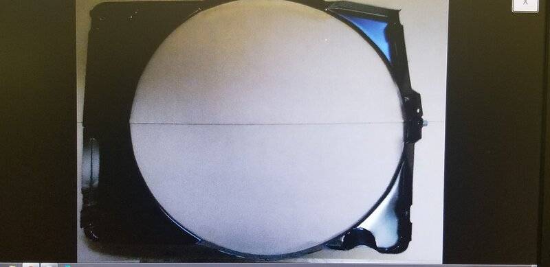

This is the correct METAL shroud..Van's had them for $245.00 shipped on Ebay.

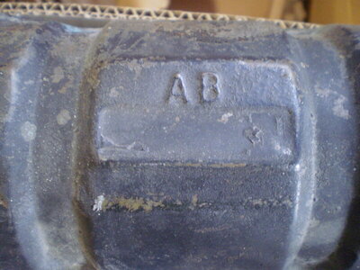

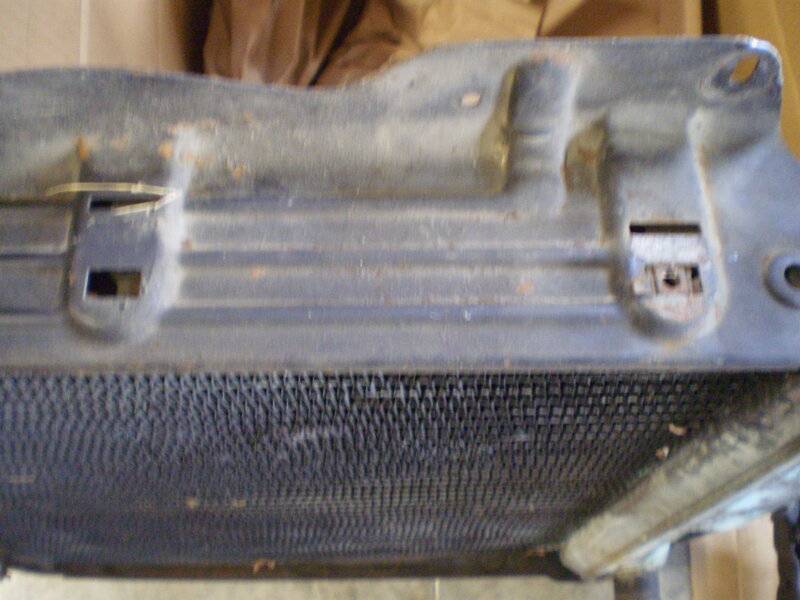

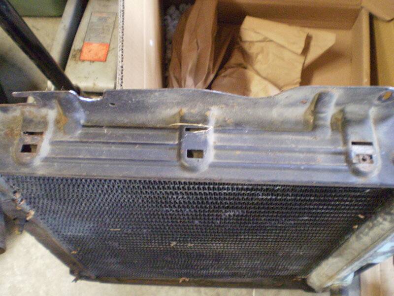

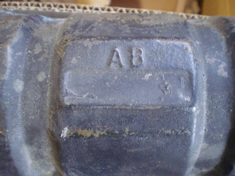

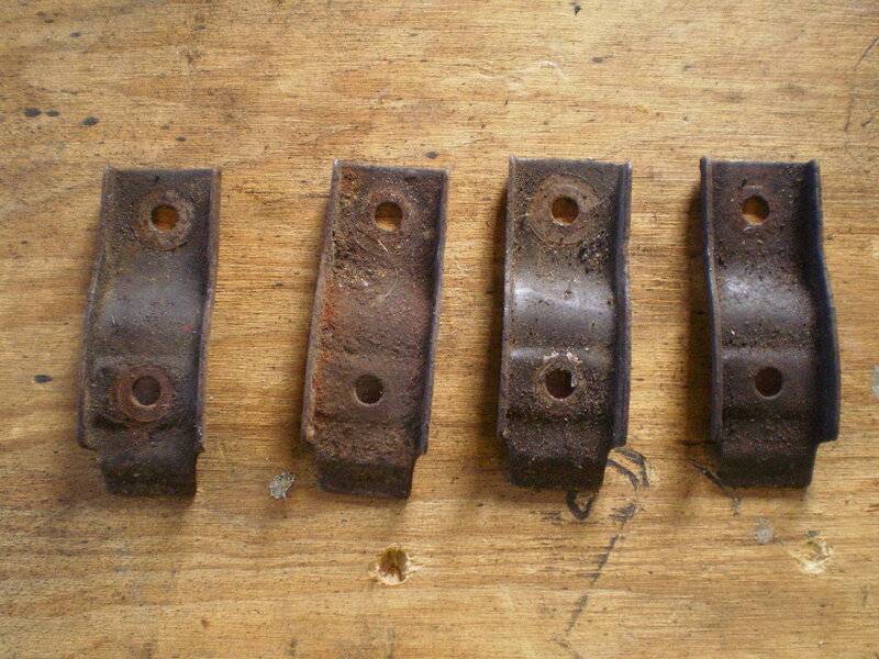

Here are pictures of my radiator with slots for metal shroud attachment on side straps. Brackets slip into upper and lower slots, nothing goes in middle slots. The square holes should have a nut-sert in them, but mine have fallen out over time. I found that by inserting brackets in radiator side straps and then bolting to metal shroud, it stays in place just fine. I took picture of brackets as well. Could not find a number on radiator. It may have been on an attached tag under AB?

Thanks for the pictures.... doesn't appear that the spare radiator I have is a 64. I'm currently running a 22" Griffin Radiator with dual electric fans but I want to go to a clutch fan set up... unfortunately the Griffin is too thick so I'll have to sell it and get a thinner one.
